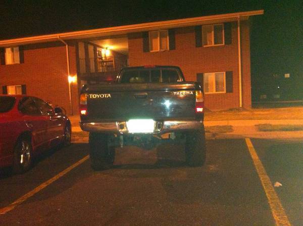

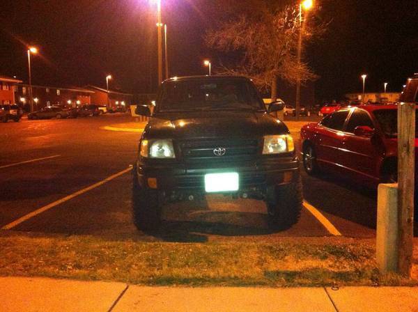

    both im gonna upload some pics there off my iphone sorry for the quality

    get some pics showing the rear shock and leafs too, from on the ground from the rear

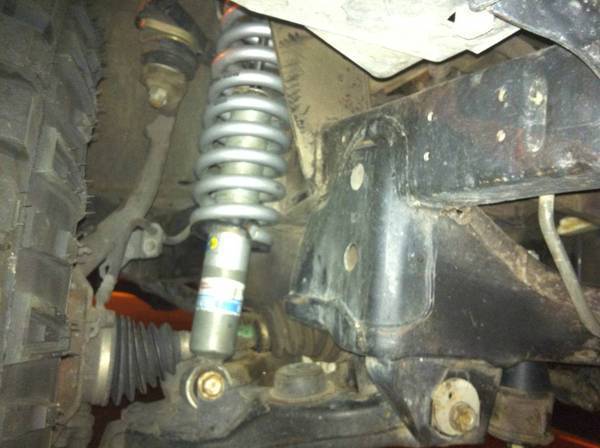

    Is that coil hanging free? The bottom of the coil spring, compare it to the other side, isn't it supposed to be sitting on a ring that holds it in place?

    I was thinking the same thing , is the coil perch busted ?

    appears to be, although i cant really tell for sure.. a closer pic would be great but i think the spring would just fall to the bottom if it wasnt resting on something?

    Can you get a pic from outside the wheel well above the tire? The top of the spring basically.

    The coil looks like it's mounted off the perch.
