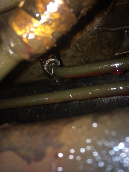

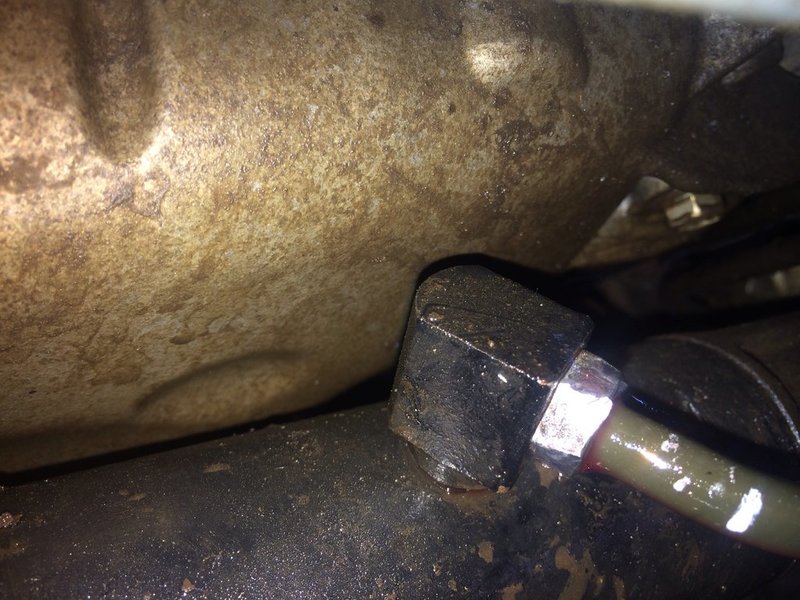

    Well yesterday I was up in the mountains I noticed fluid dripping out, after further investigation and making my way out of the mountains it was a steady stream of fluid coming out of where one of the flared tubes goes into the elbow at the steering box. I disconnected the hose where it goes into the elbow and couldn't find anything wrong with it. Any ideas?

    There's been a few people posting with the same leak recently, haven't seen the fix yet, hope it's not a new rack based on how common it seems to be.

    what did you end up doing TanaTaco? My '06 is leaking from that same spot.

    So my engine mount cracked my frame, apparently a pretty common occurrence with 05-06 Tacomas. Long story short the engine was so loose it was bouncing on the steering rack. So I ended up changing the entire rack out only to find out my engine mounts were broke.
