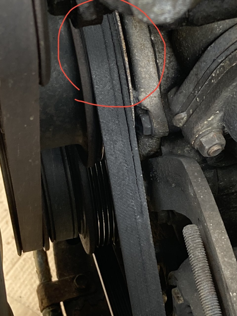

    upload_2023-6-5_8-40-48.jpgWish I knew how to upload a video…. Took the belt off to find that the pulley running that belly off the motor has a curious weeble to her wabble. 2003 2.7 manual transmission. Advice on removal and pulley replacement please and thank you

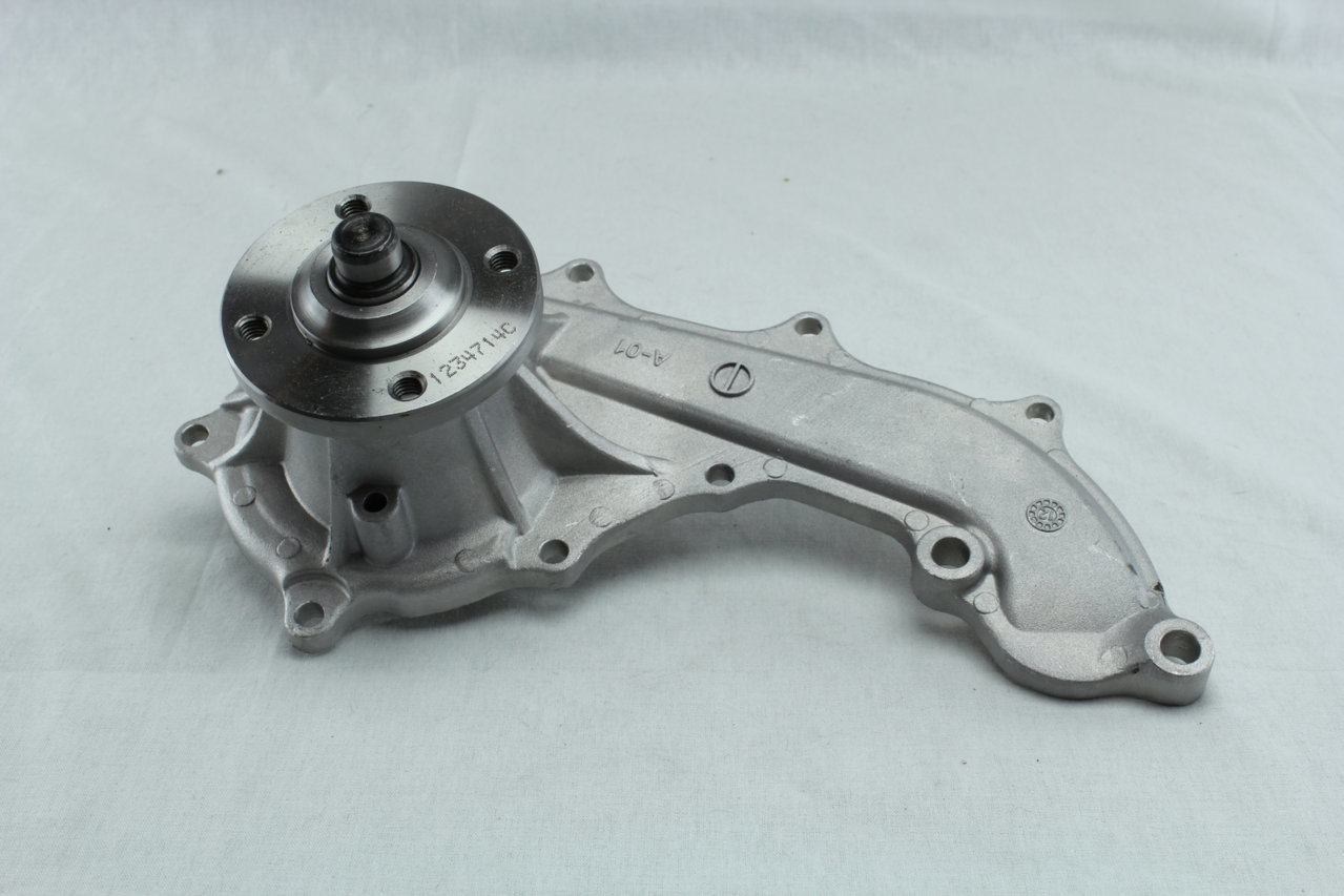

    Probably time for a new water pump

    That make the whole fan shaft assembly wobble when turning by hand with the belt off? No water leak either.
  4. Jun 5, 2023 at 7:05 AM
    0xDEADBEEF
    Mar 2, 2019
    #285037
    19,837
    2000 reg cab 4x4 flatbed MT
    yup. Whole thing is supported off that bearing in the pump.

    Make sure your harmonic balancer is not wearing out....
    that main pulley is rubber mounted.....and starts to wobble when it wears out...
    that could be the cause....
    wobbling HB would eventually damage the timing cover, oil pump, front seal, woodruff key....
