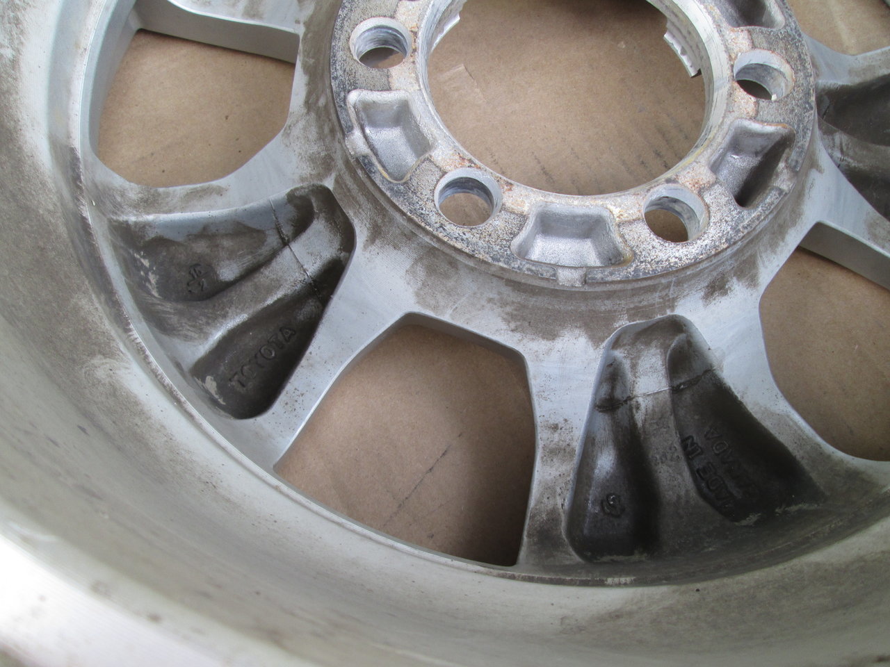

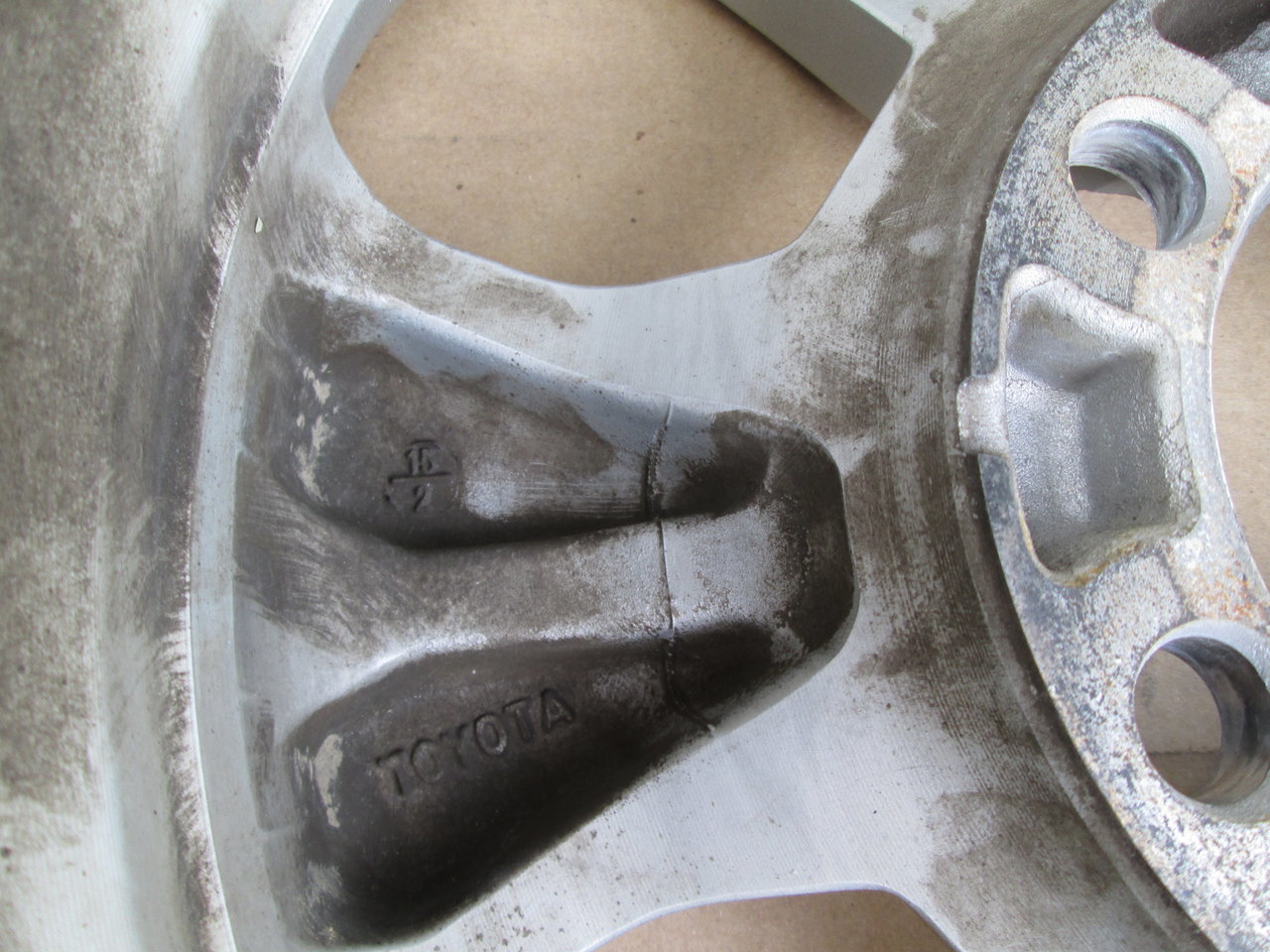

    I bought some used Trd rims and 2 of the 4 rims have this crack? or is it a casting flaw only on the inside of the rim in the same area. Your thoughtsIMG_1746.jpg or wisdom?

    looks casting flaw to me

    Casting it looks like.

    definitely not a crack. flashing between the core and pattern that didnt get cleaned up looks like to me.

    I don’t think that is a crack. It’s to much of a straight line and in the same place on two wheels. What are the chances of that happening?

    Suspend them from a rope and hit them gently with a hammer, if it rings it is good.
    If it goes thump its cracked.
