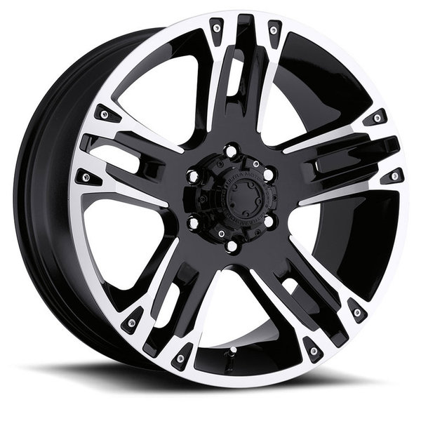

    I bought the truck used and the guy had put new tires and wheels(aftermarket) on it to help sell it. So i didn't install them.
    Wheels
    Tires
    I took it to my tire guy about the shake and he said something about spacers but then said ultra motors ports wheels don't need them?
