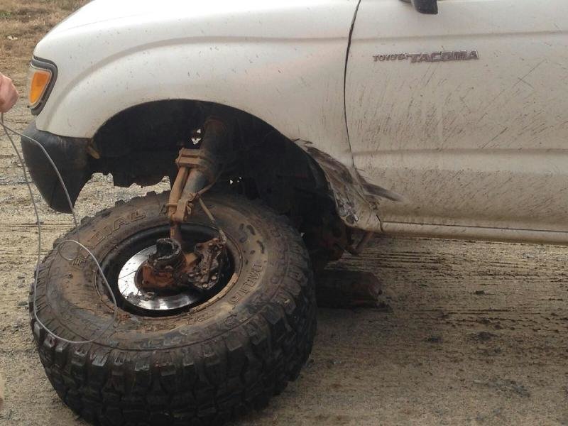

    This is what the previous owner of my truck found when the (4) bolts come out of the lower ball joint. Installed properly they should be 59 ft. lbs + loc-tite. I'm sure there was some bump shimmy prior to this occurring.

    I have mine torqued to 59lb. But didn't know loctite was required.
