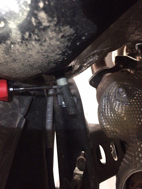

    Did not see anything under the frame.

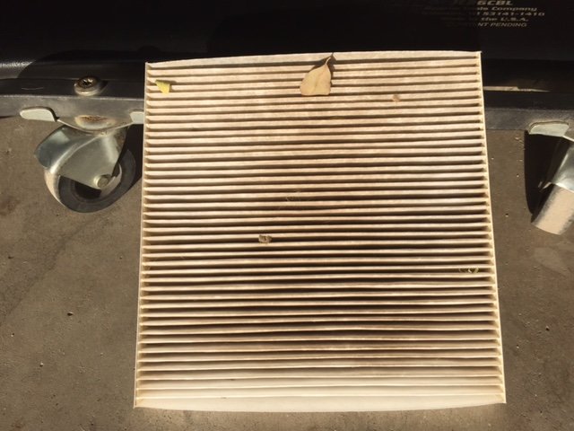

    Did see this sticking out the firewall, is this it?
    Also the cabin filter was dirtier than I thought it would be:

    I believe that's it. Shove a coat hanger or blow air up into there to be sure it's not clogged. I've seen some people add hose to it if it's not long enough and draining into your frame. I don't know if that's the case with a 2016.
    Spider webs are a big cause of the clogging. All it takes is one evening for those bastards to get in there and make a nice web that stops the flow of water and then you've got a wet floor and nasty smell.

    Nasty filter. I change those out twice a year. It helps.

    My fault, did not see that. I was reading too fast. Maybe try a new a/c filter with de-activated carbon in it? Those always cut down the smell quite a bit. It's a little pricier but well worth the money.
