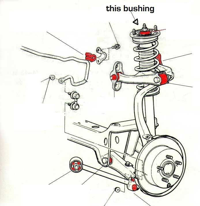

    ok so i just installed toytec coilovers and they were used before i got them. this is the situation. i greased up my trucks UCA's, Tire Rod's, Struts, everything but when i drive and hit bumps etc. these coilovers squeak like f-ing crazy. I started looking very carefully at everything and finally found something wrong with the bushing at the very top of the suspension set up but i dont know if it is the source of the squeaking. it is the bushing at the very very top where the bolt that holds everything together on the coilovers is completely thrashed on one side and really worn out on the other . here is a picture of what bushing i am talking about. does anyone know if this bushing could be the issue causing my truck to squeak really bad

    yea. It could very well be the issue. If they are thrashed, you should replace them. If that doesnt work, start looking elsewhere. But that seems like a good start.

    i am hoping it is i looked everywhere else and greased EVERYWHERE this was the only thing i saw that was out of the norm

    You know what, it just dawned on me. Remember how you had to un bolt the uca from the spindle to get the coilovers to fit in? I bet your swaybar is rubbing against the coil. Check and see how much room there is between the two.
    You can take the swaybar off and see if it squeeks.

    i checked the sway it is not anywhere near the coil because of the spacers i put on i was using WD40 just to see if it would change or dim the sound so i could locate the problem and than use a better compound but nothing worked and if a bushing is ruined i do know that they cannot be greased up so i figure that is what it is.

    ya i know but i got the spacers and i looked and those are not the problem i def think its a bad bushing because the ones on top of the strut are pretty messed up its just i didnt know if that exact bushing could be a factor when hitting bumps in the road

    how difficult is it to replace that bushing?

    how does the lower eyelet bushing look on the coilovers?
    if its squeeking, it should be bushing on metal in a circular motion...

    the bottom mounting hole is the eyelet... the bushing that goes into that eyelet, then the bolt runs through that bushing...

    the eyelet looks fine......also when the truck is just sitting off in park and i jump on it it squeaks really bad
