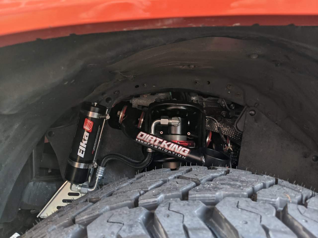

    2016 SR5 DCLB, 35,000 miles. No issues before lift, below is everything I installed so far. Before alignment I immediately had bad vibrations on the floor (kind of a continuous clunk) and shake/vibs in the steering wheel. They were pretty bad about 5-10mph, worse up to 40-45 mph, didn't go any faster and only drove to and from the shop for alignment, 12 miles total. To the best of my knowledge, we installed everything correctly and torqued to spec.
    Elka 2.5" Extended Travel Coilover Kit with RR, 650 lb Coil
    Elka 2.5" IFP Rear Shocks
    OME Dakar HD leaf pack, OME U-Bolts
    OME Driveshaft Spacer
    Extended rear brake lines
    Dirt King UCAs
    ECGS bushing
    Front/rear diff fluid change
    transfer case fluid change
    285/70/17's
    Brakes flushed
    Alignment was done today (8/30/20)
    Did quite a bit of research tonight and haven't found an exact answer, but could be the following - Lower ball joints, drive shaft angle, CV issues?

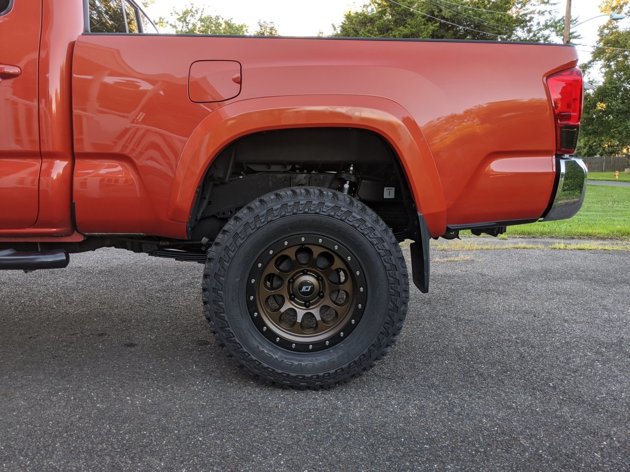

    Vibration in the floor most likely points to driveshaft vibes, which is most likely pinion angle related. With the Dakar HD pack you could try to add a 3 degree shim to the pack (in the proper orientation- narrow edge forward) and that should help. For now, it may seem counterintuitive but try removing the driveshaft spacer and see if that helps.

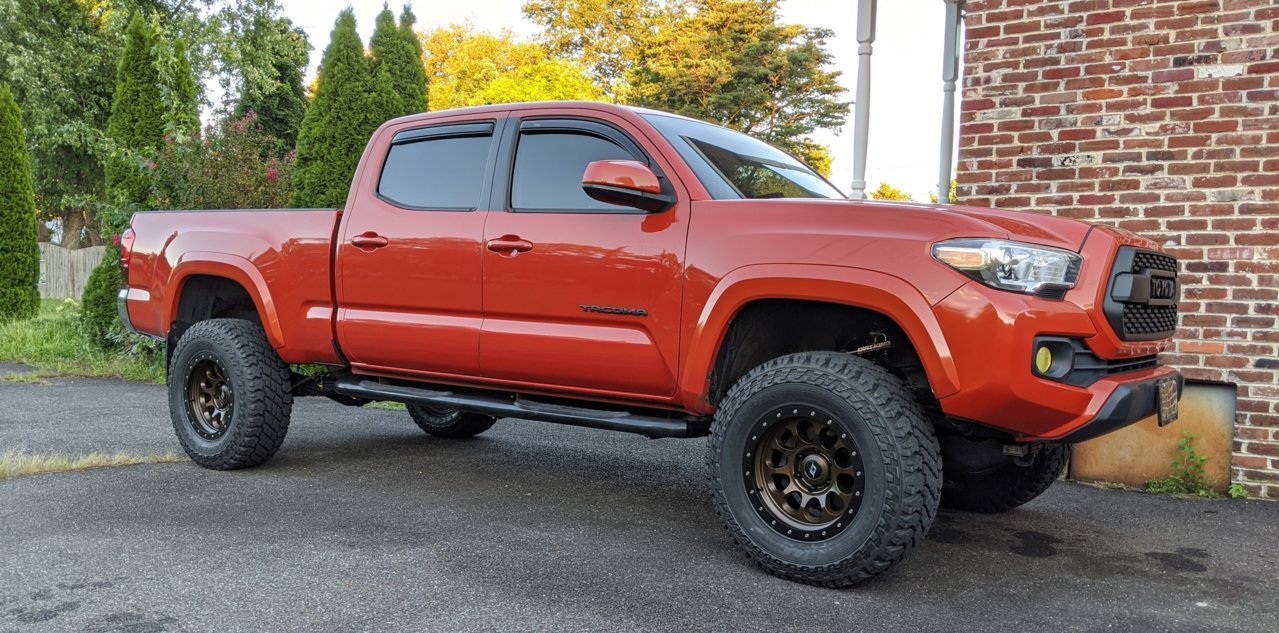

    The front don't look quite right to me, off the bat. What did they say at the alignment shop?
    t0nnn[OP] likes this.

    @Dirk Diggler @GHOST SHIP thanks, I’m going to order the leaf pack shims tonight. May remove the carrier spacers and see if it’s better.
    @GHOST SHIP @Guerrilla The truck is darting to the right as soon as I let go of the wheel as well. Had it aligned at Firestone (life time alignments). Could deff be a balancing issue, especially hearing that you had similar issues.
    I actually had the tires mounted and balanced 2 months ago and they sat in the garage. A few weights fell off two of them - I put those two wheels on the rear and had planned to go back to Mavvis for re-balancing.

    @CaptainBart45 They didn't say anything other than reviewing they flushed the brakes and did the alignment. They were a little backed up and this was 30 min after closing, so I didn't head back.
