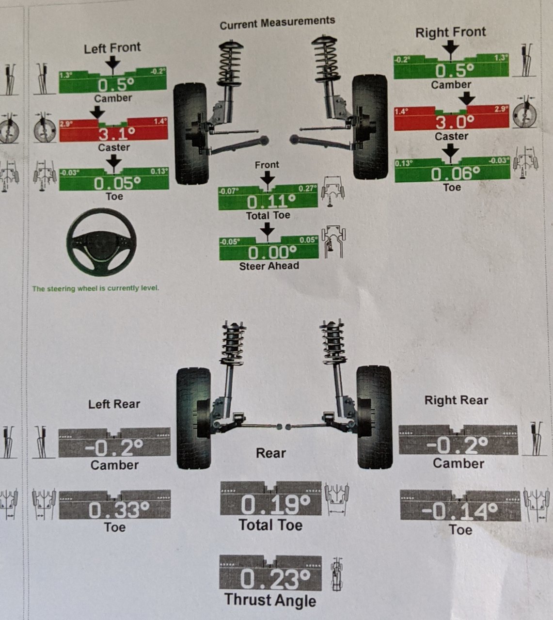

    Have a good update going into the holiday weekend. I was recommended a local shop (Van Meter Auto, Mantua, NJ) by two people that has a road force balancer and has been around quite a while. Explained to them what was going on, they heard me out made some recommendations and had at it. Also told them I felt like I heard a clunk coming from the drivers CV. Apparently I separated the one of the CV U-joints when I pulled it for the ECGS bushing :)
    Work completed:
    Replaced drivers side CV
    Road force and static balance wheels
    Cleaned up leftover weight adhesive, even asked if I preferred black or silver wheel weights
    Alignment (new numbers attached)
    The tech doing the work kept in touch on and off for the 2 days they had it. Even came out when I was picking up to explain everything he did, including the road force balance numbers and alignment numbers. Honestly a big reminder that I should try to shop local, this shop couldn't have been more helpful and professional. Earned my business moving forward for sure.
    Only got up to 55 MPH on the way home, but steering wheel vibrations are gone, floor vibrations gone, truck is aligned, and no more clunks. Huge weight lifted off my shoulders.
