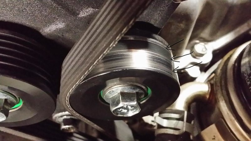

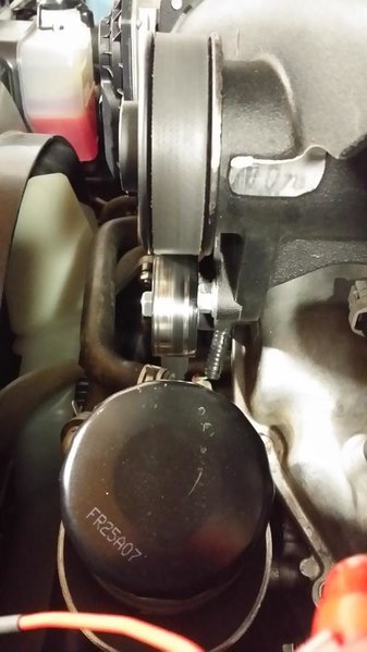

    Here's the story:
    2013 Tacoma 4Dr Short bed with 35,000miles. TRD supercharger correctly installed by local dealer. Wanted more power!
    Ordered 2.85in pulley and fuel pump from URD.
    Got cold feet about the fuel tank drop and the pulley swap, so I went to a local performance shop who actually developed their own supercharger kit for the Jeep JK. So I thought, "Wow, this should be easy for these guys". Long story short they were completely unfamiliar with press on pulleys and ruined the first URD pulley after putting it on a hot engine.
    Second pulley apparently did not go much better and they used a torch to heat it up during the install and really didn't get it all the way on.
    Immediately after getting my truck back I noticed a few scoring marks on the smooth idler pulley.
    Pulley is now shiny and minimally grooved.
    I think they damaged the idler pulley. Anyone agree?
    If the supercharger shaft pulley in not all the way on would it have caused this condition?
    Finally, where do i get a replacement?
    Thanks!

    Contact TRD directly or go to your local Toyota dealer and see if they can get it for you.
    If that idler looks that way after the pulley was installed, then yes the work those monkeys did is causing damage to it.
    The machined face of the pulley should be flush with the end of the shaft, and yours is far from it. It also looks pretty beat up from the install. Have you visually checked to see if it is running concentric? I would be worried about the pulley deciding to part ways with the SC, or at the very least I would stock up on spare belts.
    Have you talked to the shop about this? They obviously did not read the instructions, or read them and decided to use their own installation method that is not compatible with the TRD SC. I would see about getting them to pay for a replacement idler and pulley and find someone who can actually install it for you. Sorry to see this and good luck.

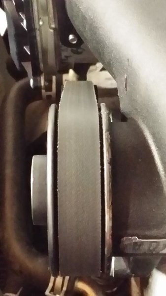

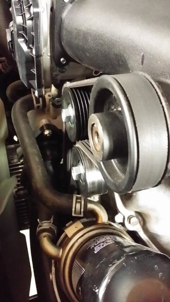

    I would not worry too much about the iddler pulley.
    Focus on the SC charger pulley. End face of shaft and pulley should be flush or youre gonna have accelerated wear of the belt.

    How about this:20150307_114634.jpg
    So it turns out that the 9/16th bolts holding the pulleys are quite long. I simply added some thick washers and extended the pulleys out to be in line with the Supercharger pulley. Looks lined up. Did a short run with supercharger engaged, checked pulley temp and everything seemed OK. Still considering replacing that smooth pulley though. Not sure.
    If everything is lined up, anyone see any problems ignoring the SC pulley not being fully pressed on for a few months?
