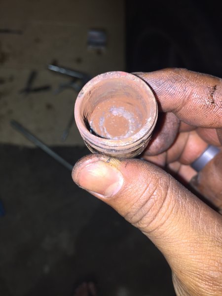

    After just doing the head gasket last month at 147,00km for 3700$ on our 06' 4wd Tacoma, we noticed a slight chirping noise while reversing coming from under the truck. Thanks to posts like these, I tried replacing the rear drive 3 Ujoints not knowing which might be toast, as they all seemed to be moving well, and no real play when I tried to test them at first. I grease them every 6 months no matter what so wasn't too sure what I'd find. They all looked greased when I was taking them apart until the second last one, grease was black instead of red and smelled foul. Put it all back together and the noise is gone, so too is the subtle vibration on take off every now and then.
    There's a few good YouTube vids on this DIY, I studied a few. I recommend a vice over a hammer, penetrant, and a second pair of hands to help and hold stuff. Almost admitted myself to the Nuthouse after trying to do the first one solo, much easier with help to line things up and hold things. Most important!!- marked everything in a line WELL, so that you can line it all back up for balance in the end.
    No more shuttering at take off, no more chirping.
