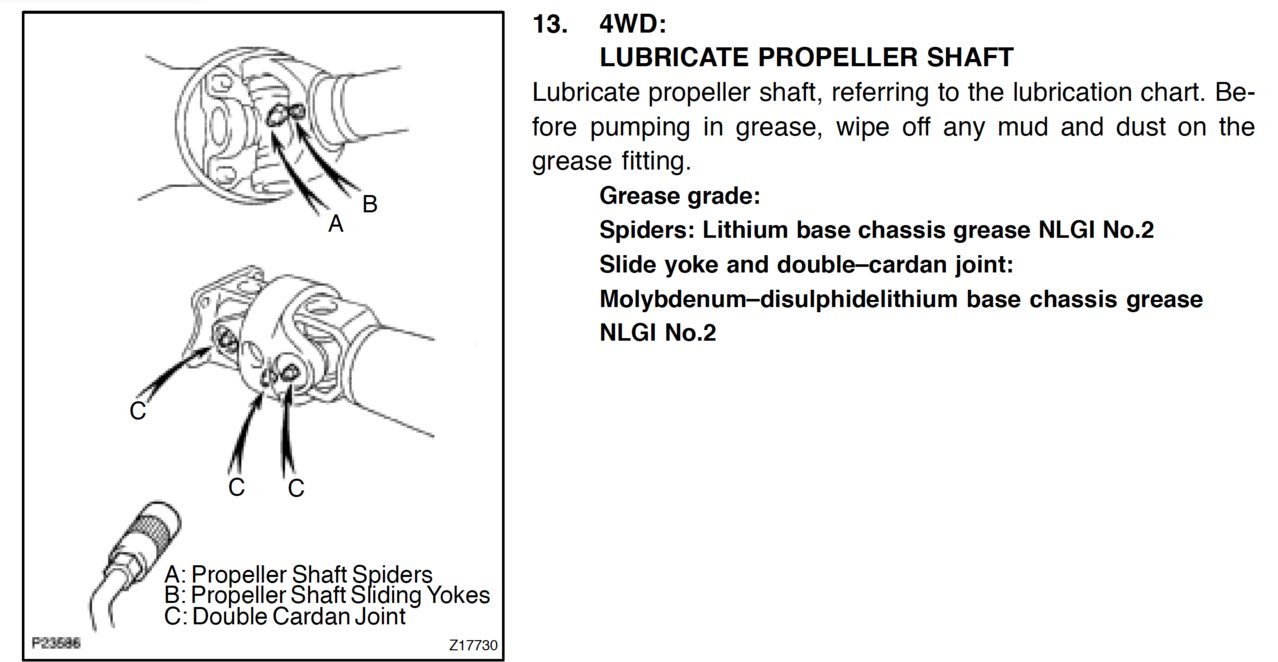

    It could be the front diff needle bearing on the driver side. It's been a common culprit for a vibration and roaring noise. Check out your driver side CV axle connection to the differential and see how much play you have.
    Have you recently greased the zerk fittings for the u-joints and slip yoke on your rear driveshaft? Have you also greased the zerk fitting for the center ball of the double cardan joint?

    Yes, all greased. When it warm up a bit I’ll check the front shaft.. thanks for the info
