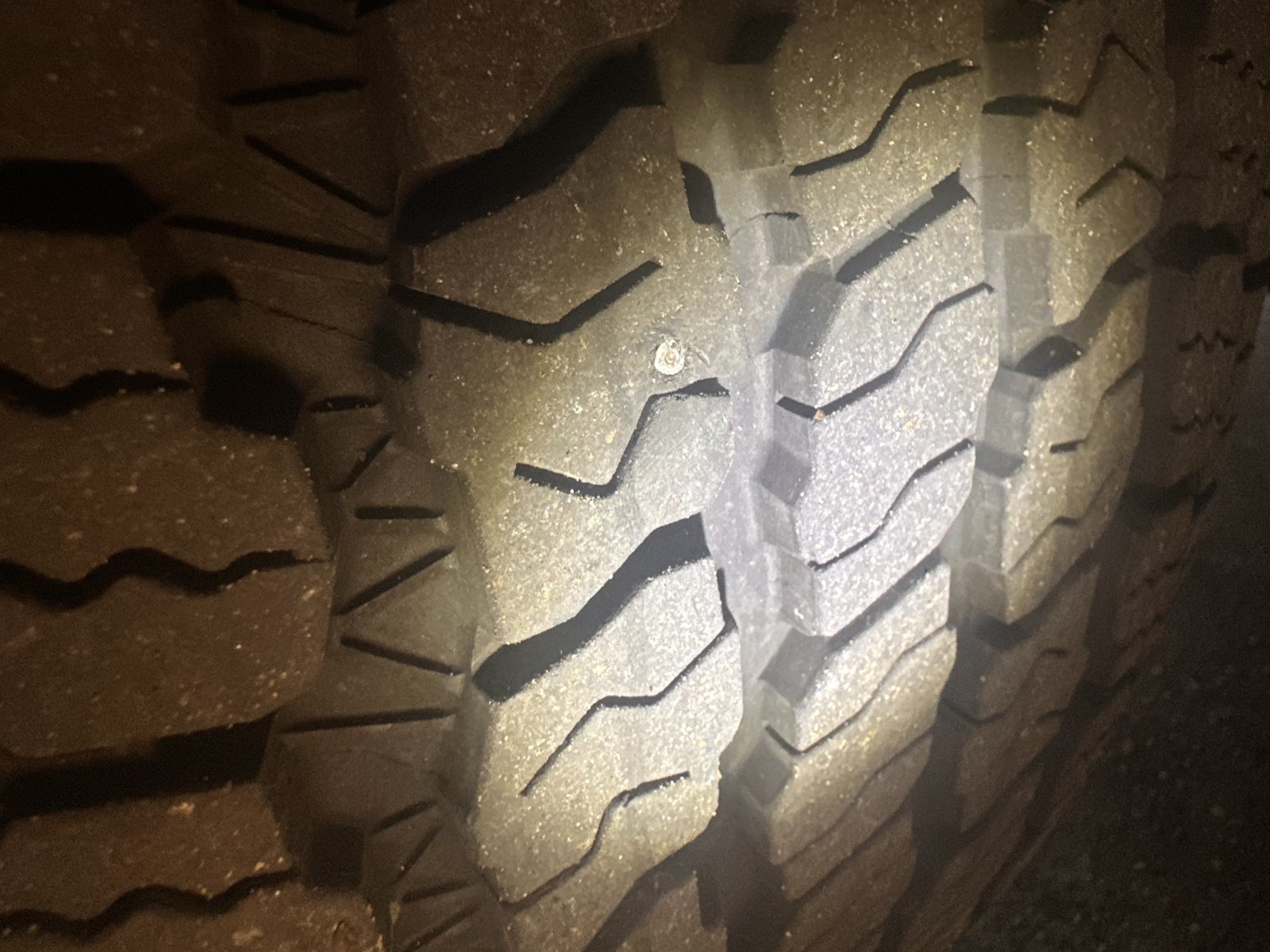

    Alrighty, hypochondriac time. 2023 TRD OR, 15k miles. All stock suspension and tires. Out of the blue towards the end of last week i got what i thought was a small harmonic/vibration issue that FEELS like its coming from the drivetrain/rear diff. The truck was smooth and quiet, i mean as smooth and quiet as these trucks are. This week it feels as if its getting worse.
    I can hear an audible whirr or hum under load, and under decel with no throttle and no break I can her a rotational whirr sound different from that under load. This is NOT the whine that is so prevalent it has a 319 page forum on here :D i've listened to those clips and its not a tuning fork whine but a for sure whirr. I get a distinct constant vibration in the gas pedal, the drivers floorboard if i put my foot flat on it (i usually drive like this in tacos), and now the steering wheel. It does not seem to get worse when turning so i don't think its a wheel bearing. Perhaps pinion bearing? Trying to rack my brain on what it could be.
    I did go looking for nails in my tires and found one in the drivers front, but it is below the tread block (IE the head is below the rubber) and the tire isn't leaking air at all. Holding 33 psi great. Plus the whirring doesn't sound like tire debris like i've felt before.

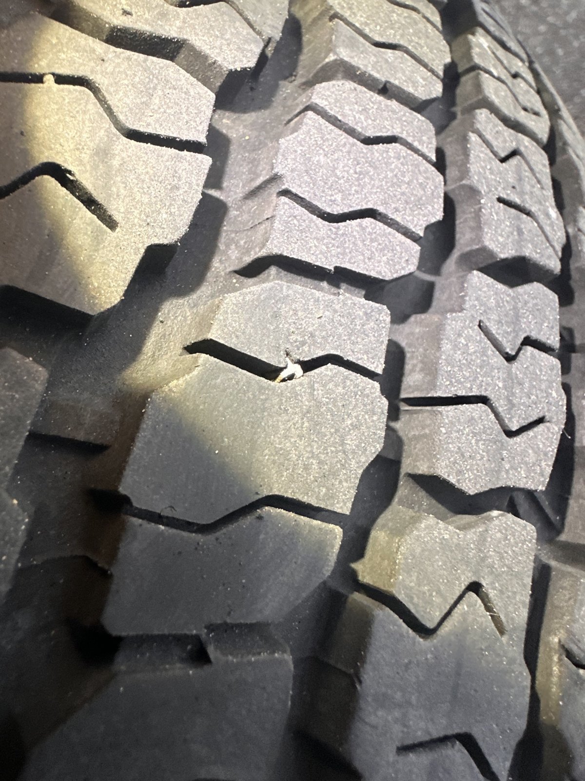

    Update #1, went ahead and rotated the tires and no change. Really weird vibrations over 45 mph mostly between 1400 and 1900 rpm. Cant tell if im now mandela affecting myself into thinking the AT is shifting weird being weak... who knows.
    BUT i did find a nail in one tire and then a screw or drillbit broken off in the other. I don't think this is causing my issue, but i'll be heading to discount tomorrow to have them patch them for me.
