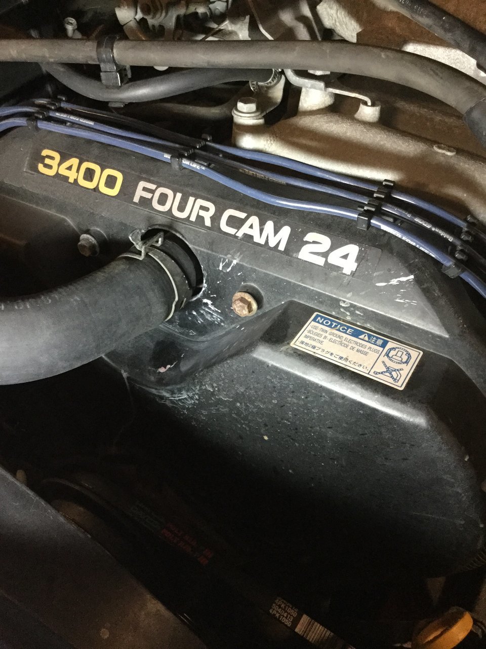

    I had a small coolant leak under the upper radiator hose where it attaches to the pump inlet. No leaks elsewhere. Upper hose is hot, lower hose is not. I suspected a bad thermostat and replaced it and the hoses after testing the new one. Tested the old one after replacement and it worked fine. Now there are no leaks but the difference in temperature is the same. I suspected an air lock in the block because I wasn't able to put back about a 1/4 of a gallon fluid from what I took out. Ran the truck with the front end parked on a snow bank for 10 min with the radiator cap off and I'm still unable to add more fluid. I do not see the fluid moving in the radiator to indicate that the pump is working. I drove it for about 15 min and the ECT registered 194F, it was -19F outside though. The fluid looked brand new with a minimum amount of debris, the heater works great, I don't hear a bad bearing... I'm out of ideas at this point. I've searched around in the forums but haven't run across a problem like this. Any help would be appreciated. Thanks in advance.

    It is not overheating, it’s running about 194F. I’m running it in the garage with a temp of 60F. I believe that there is no circulation of the coolant. When I say that the bottom hose is not hot, I mean it’s cold. While squeezing the hoses with the engine running no flow can be felt. I should also see fluid movement in the radiator with the cap removed, I do not. I’m thinking it’s a bad pump or radiator blockage at this point. Just looking to pinpoint it before ordering parts I don’t need. This is where the leak occurred, you can see the residual from the coolant as it sprayed out.Thanks

    If it's leaking at the top goose neck/radiator hose and onto the timing belt cover, the spring clamp you have there is not providing enough pressure. Replace with a hose clamp.

    Yeah I have that same problem, the hose clamps are worned.

    Yea me too was leaking feom same spot . It was a loose clamp .
