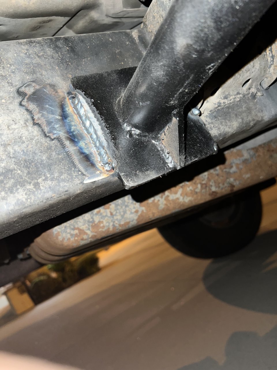

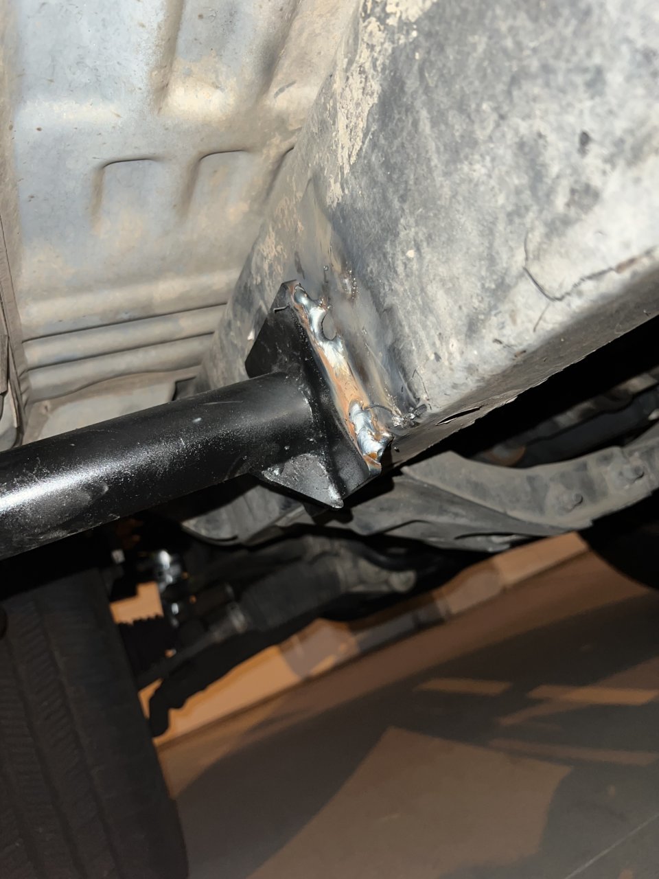

    Had some 4x sliders welded on and the welder had a really bad time. Spent 7 hours on it and looked defeated. Of course I paid him (and then a lot extra as a tip because they stayed way late). But the finished result doesn’t look good to me.
    issues I have:
    1)only the sides are welded
    2)the plate doesn’t sit flush against the frame for one of the plates
    3)one of the plates is a little lower than the frame
    at this point; he has offered to take it off and fix it in a few days, but wouldn’t that mess up the frame more?
    Should I just leave it, or will these fail me on the trail?
    the other side looks fine, but the sides of the plates are welded, not the whole thing around. I think the other side is better because he learned from his mistakes

    7 Hours was this a hobby welder or a seasoned welder that has never really done much welding on vehicles?
    I have seen welders that weld in a booth all day long suck when it comes to out of position.
    This can be some of the most difficult welding old rusty and out of position.
    Since he has offered to fix his mistake and you paid for the job !! Ask him why he had such a hard time a good person will admit his mistakes and if the job is beyond his skills. Sure looks to be the case here!!:annoyed::annoyed:
    See if he comes clean. Sadly the one good weld might have been pure chance and luck.
    I still come back to the 7 hours and such poor work. What did they do for 7 hours ?
    The next 2 lines might not apply in your case.
    (It happens we all can have bad days.)
    (Not being able to see unable to get comfortable long day and just being exhausted knowing we should just quit but keep going to please the customer.)
    One good impact on the left side that one just might break off.
    Speaking of your frame is that a bad spot on the right side in the left side picture.
    It comes back to your call !!
    If i was close I would help you out for Pizza, If you want to share what you paid drop me a message.
    The 7 hours keeps waving a flag to get my attention.
    Getting paid for poor work just encourages them to keep charging for substandard work:annoyed:

    Regarding the welding not going all around there is some legitimacy here. The forces on the slider are mostly in the direction of the vertical welds. This distributes the load across the length of the weld. A weld along the top will pretty much do nothing for strength and just cause a stress point where a crack can start after being flexed into from some hits. If you look at other weldments from factory they are engineered this way as well (front frame sections, engine mounts etc). I would still be inclined to put some weld on the bottom/back side as this is all under tension. It does not have to be full but would ask the welder to wrap the corners to prevent a crack from propagating from the bottom. Leaving a 1" or so unwelded portion on the bottom will give moisture a place to go as well (good idea to squirt some oil in from the top).

    If only that one mount plate is below the frame, then the poor guy was fighting fitment issues for a whole day. Lots of prefabbed stuff like this isn’t built right and doesn’t fit right….without cutting it half apart it’s tough to get it to fit right…takes lots of adjusting and then we arrive at a compromise.
    that being said…there’s no excuse for that first shit weld if this was a pro. Looks like some dude in his driveway that happens to own a welder, but needs more practice.

    First pic is he ran the bead downhill without cleaning the frame and puddle outran his movement, second pic is run uphill which concentrates the heat better, that one looks fine, but I can't tell you if it's what you want for strength. I would not seal weld it though it'll rust behind the plate. Like the one guy said leave a "vent" along the bottom if you decide to do that.
    If I was doing it, you could slick that on weld down then run a uphill bead like he did on the second pic, I wouldn't cut it off if it's possible, there's of chance of taking to much metal off the frame.

    If you want, you can keep everything on the way it is and get a proper bead run up top of the plate to the frame.
    You can also get another at the bottom of the plate.
    This way you'll have the plates welded all the way around.
    I do have to ask though, which wasn't mentioned.
    Was this a weld it yourself kit or was it prefabbed? Prefabbed can cause more issues unless they came from a reputable vendor/supplier.
    If it was a WIY kit, are they aware of how some of these kickouts are angled? Maybe he was having fitment issues based on a lack of experience with sliders?
