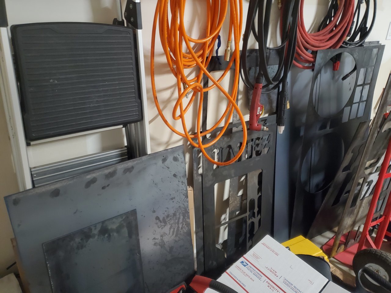

    Using a plate just means a larger contact to the frame tying it all in.
    As for "heavy duty plate" it's just 3/16" mild steel.
    Anyone doing fab work should have plenty of extra and scrap laying around -
