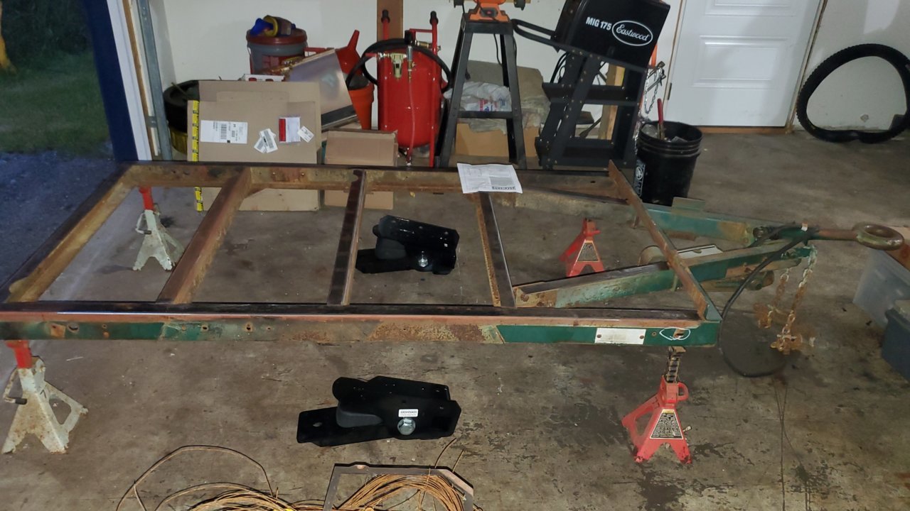

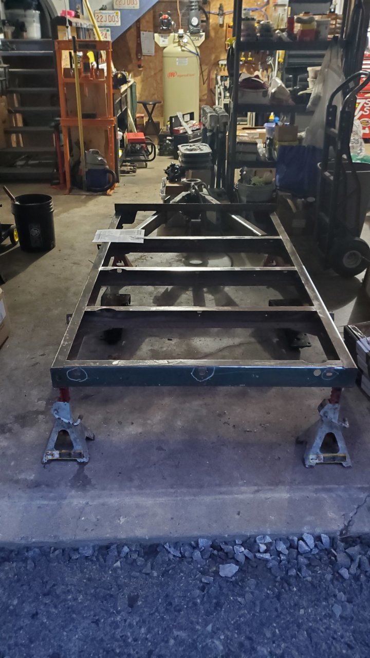

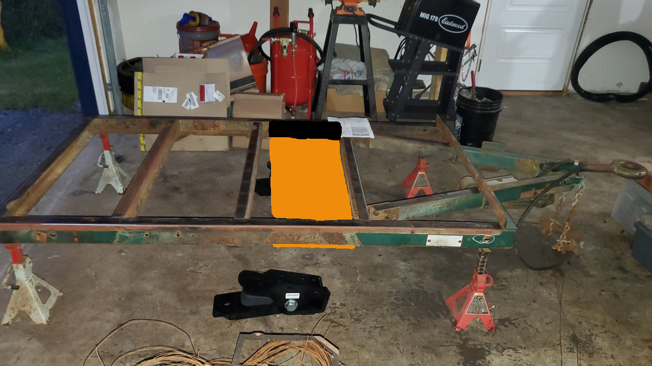

    Moved it into the garage to start working on it, now that I'm pretty well set up. Stripping off old paint and undercoating, toying with the idea of moving the axles rearward but I'll probably keep them roughly in the stock location.

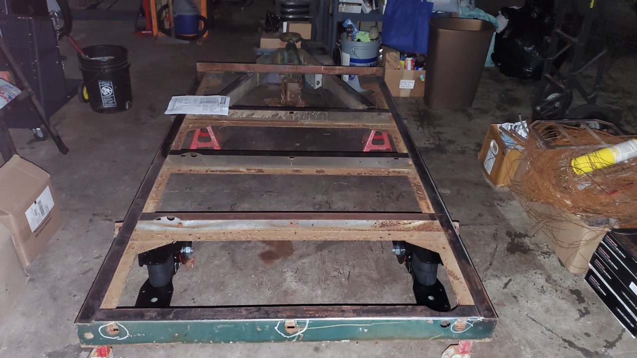

    So I was looking it over last night, and I think what I may try is to box the frame where the axles will mount and weld a plate the width of the frame across the bottom to connect the two side rails. I think that should help, along with the existing crossmembers, to stiffen the frame and give me something to bolt the axles to. The boxed section and plate are roughly illustrated below in black and orange. Placement isn't 100%, it's just a sketch, but you get the idea hopefully.

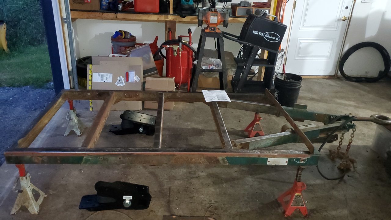

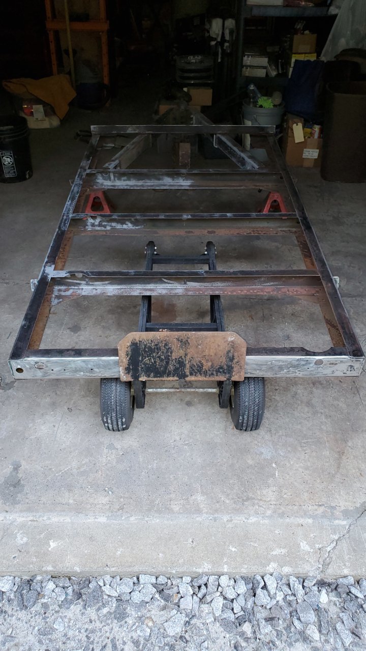

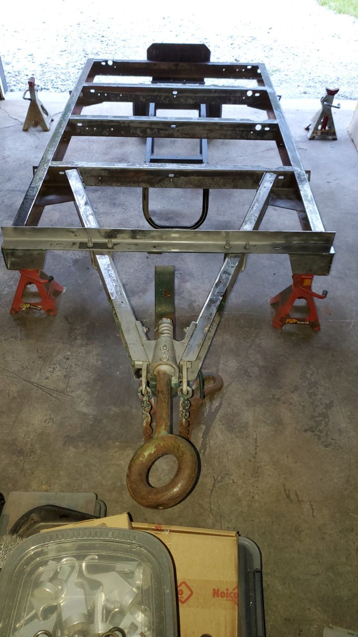

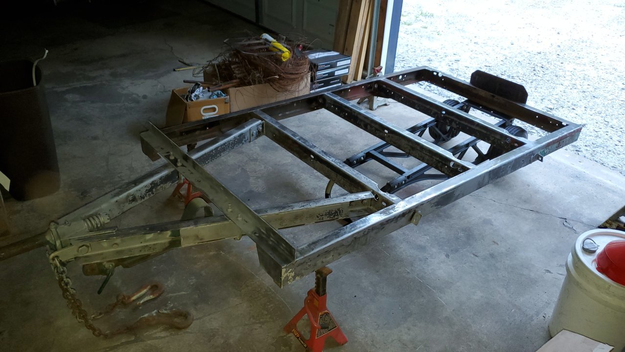

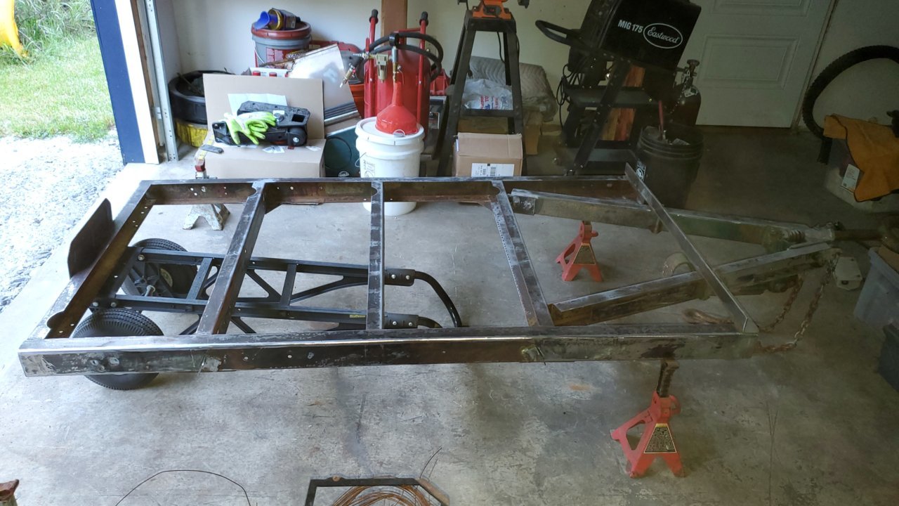

    More paint removal today. Gotta find a way to get my old 30 gallon compressor hooked up in parallel with the big one so that they can maybe keep up with the sandblasting. Gonna go through a lot of media getting this done. I sped through a 50lb bucket and haven't even got halfway through the frame. I'm not opening the sand any more than I have to, but there's a lot of undercoating that just takes time to strip.

    Beats an angle grinder on round stock sliders.

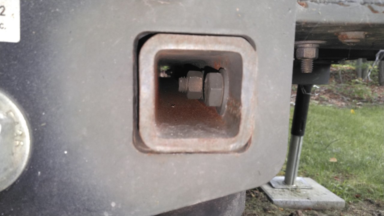

    It's a bit dirty, went to Rausch creek last weekend.
    I do have a bit of a slant on the tires (I forgot what it's called) but the angle looks like a /\
    To help it track and take corners.
    Every time I use it whether it's empty or full I'm always amazed how the suspense just makes it stay on the ground.
    Never any issues with chatter or bouncing.
    I have even purposely swerved to get a wheel off the ground and it came back down like it was landing on a cloud.
    I don't recommend doing this however I like putting things to the test!:rofl:
