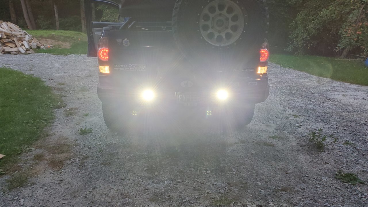

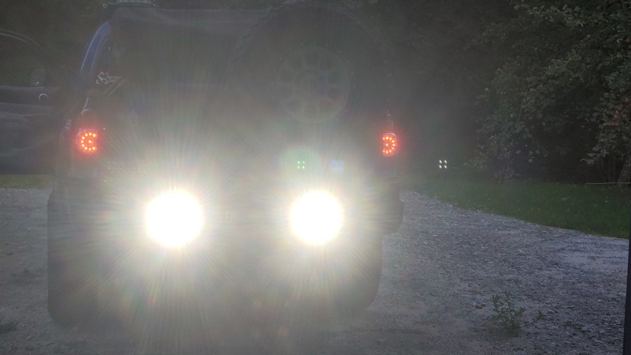

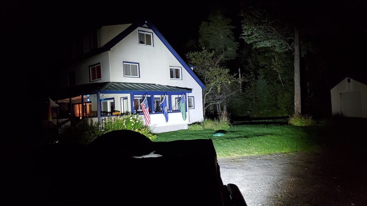

    Finally got around to installing some Rigid floodlights in the back bumper. Hooked them up with a SPDT switch and relayed through my Bussman fuse block. They can be always off, on with the factory reverse lights, or continuously on if the parking lights are on.

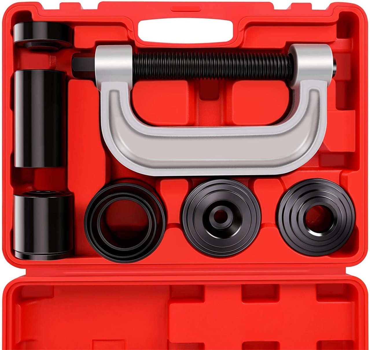

    One of these bad boys? I've got one, even has the universal joint adapters if that helps. Anything else that may come in handy? I've got an air hammer and a cordless grinder if you don't. I got the hardened drill bits with my order too if you don't have them either. I'm pretty sure I've got all the tools the job takes, but hanging out in the garage with a few other guys is my main motivation to take you up on this.

    The hand held grinder won't be needed. I have a handheld and a electric as well. That ball joint press is exactly what we will need....yes bring that. See if you can get a 3/8inch 2 inch long grade 8 bolt as well. Any 1/2" really good drill bits will be needed as well. Other than that I have an air hammer and compressor. I will talk with John this weekend to see if that date works with him as well. He is helping me install my ATH HC rear bumper this Saturday

    That bolt need to be threaded to the shoulder, or are we just using it to push rivets with?

    just pushing rivets

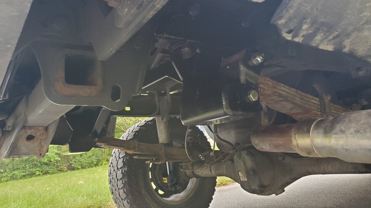

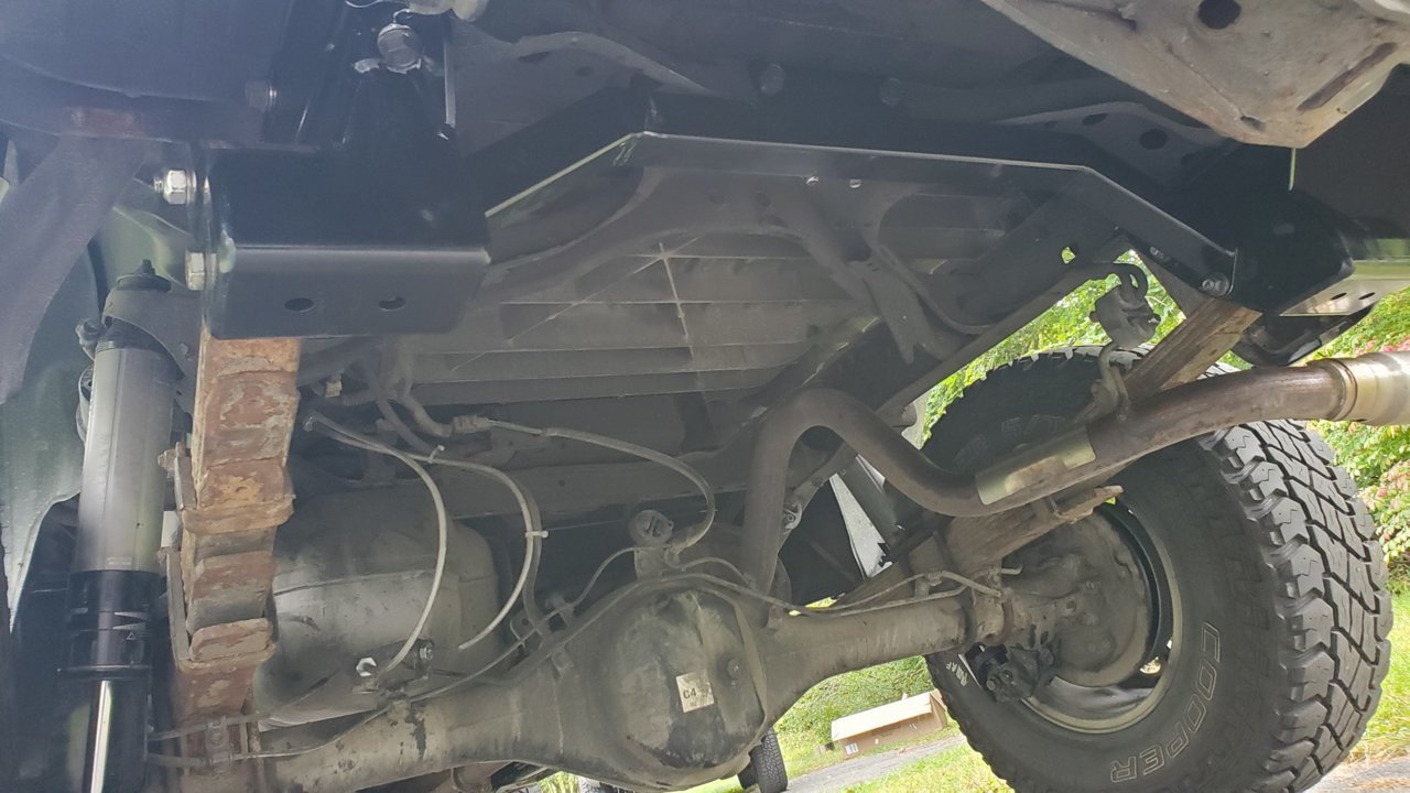

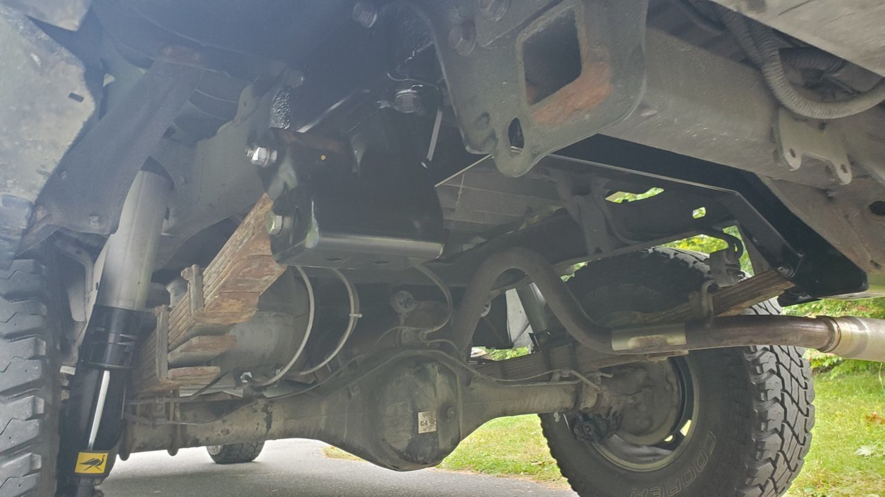

    Hammer hanger install went as smoothly as I could have hoped. Thanks again @crashngiggles for hosting and to @Taco01863 and @Brownmatthall for the help. I had a great time with y'all on Saturday. I haven't taken her up and class-4 roads yet, but the on-road handling is noticeably improved.

    Getting the truck out for some driving today and I'm impressed with the hangers. Even my wife has been able to feel a difference from the factory hardware.

    Crazy right? There are people who don't have them that say....."you really won't be able to tell the difference in a rear end of a truck".....they are so wrong.

    Took it up some nice washboard locally this afternoon and now, instead of the whole truck getting squirrelly over it, it just tracks straight where I'm pointing it.
