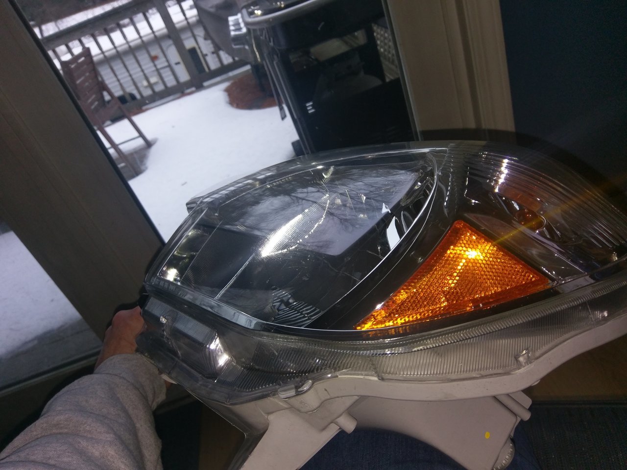

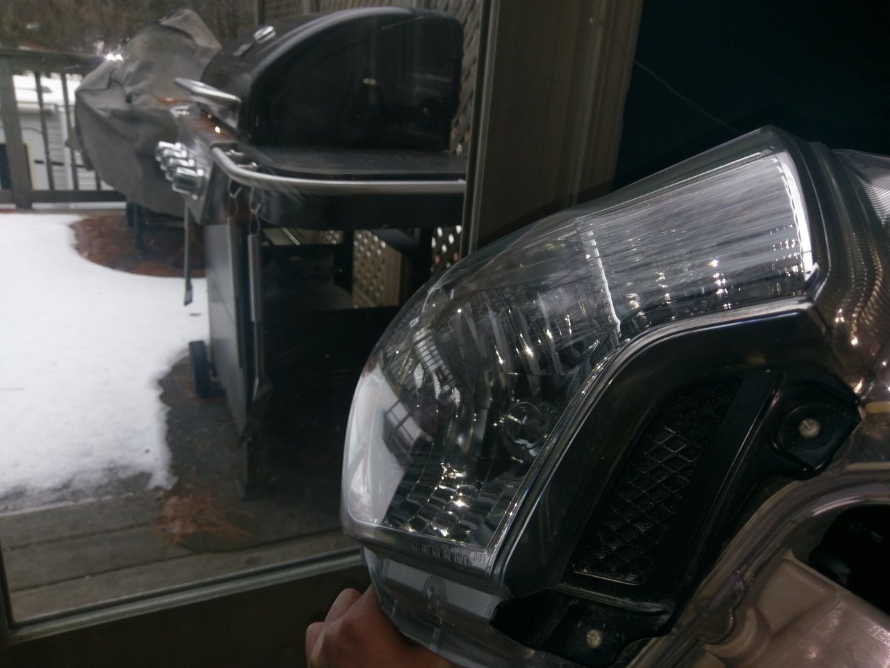

    Retrofit headlight build...step one, polish the lenses on the spare lights I picked up. I didn't think to take a before picture but they looked like they had been wiped down with a Scotchbrite pad.

    Came out great!
    What did you use to polish them?

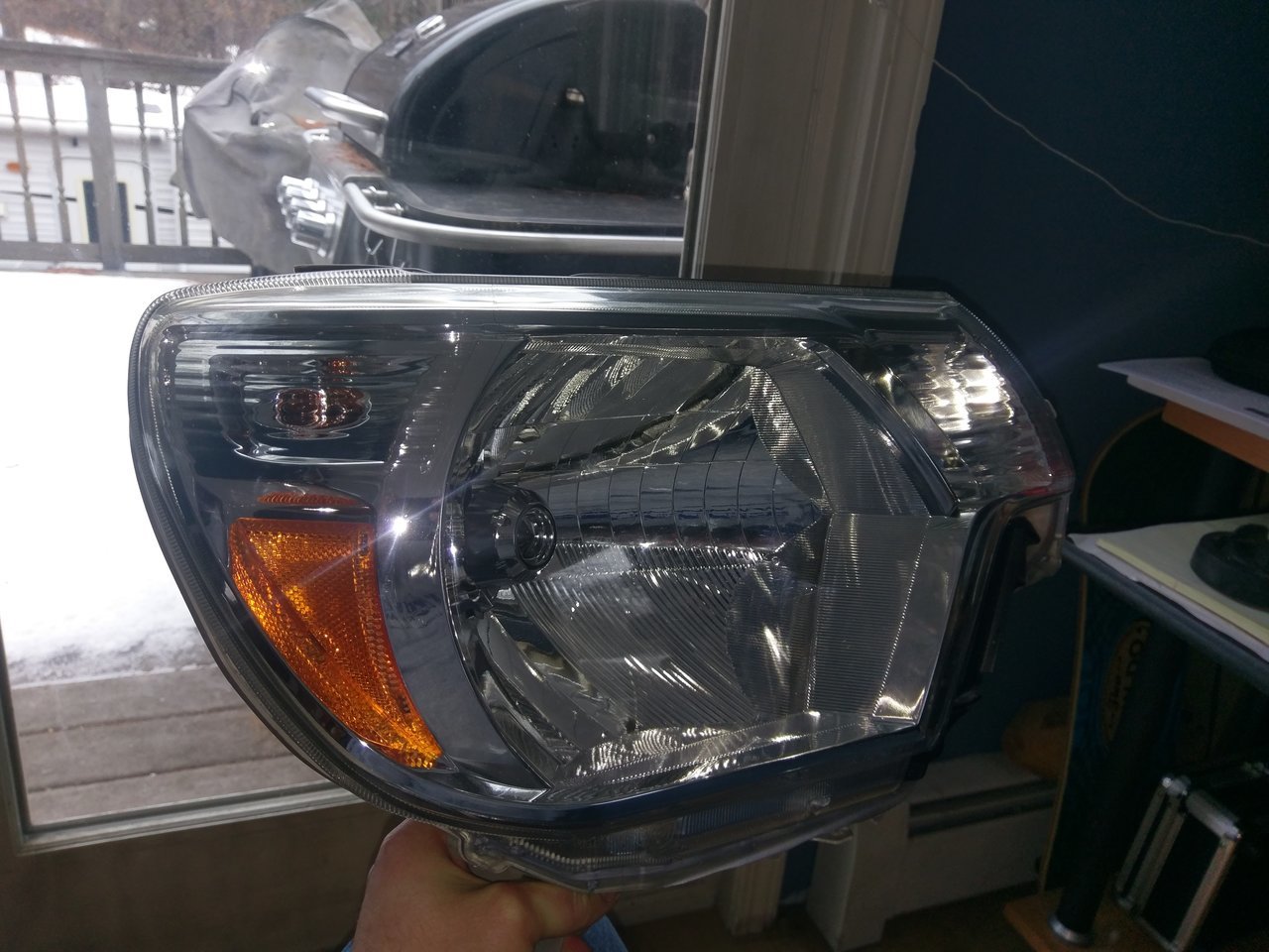

    Mothers NuLens kit. Didn't need to use the abrasives, got this good with just the polish and the foam ball on the drill. I decided I'm going to keep these for the retrofits and cover them with Lamin-X before reinstalling them.

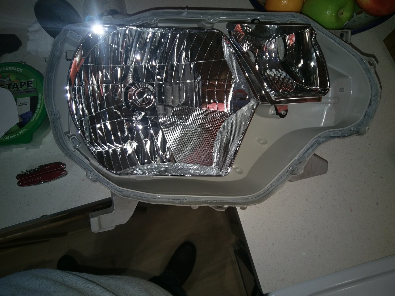

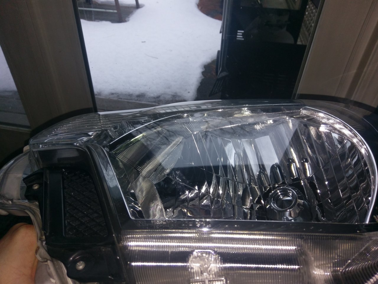

    And the driver's side, still no before pictures as I'd already done the bulk of the work on both a few days ago, but the finished product looks so much better. I've decided I'm going to make these into the retrofits and ordered some Lamin-X film to cover them with once I'm done. That should help hide the few imperfections that are left.

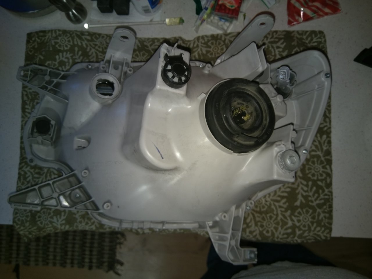

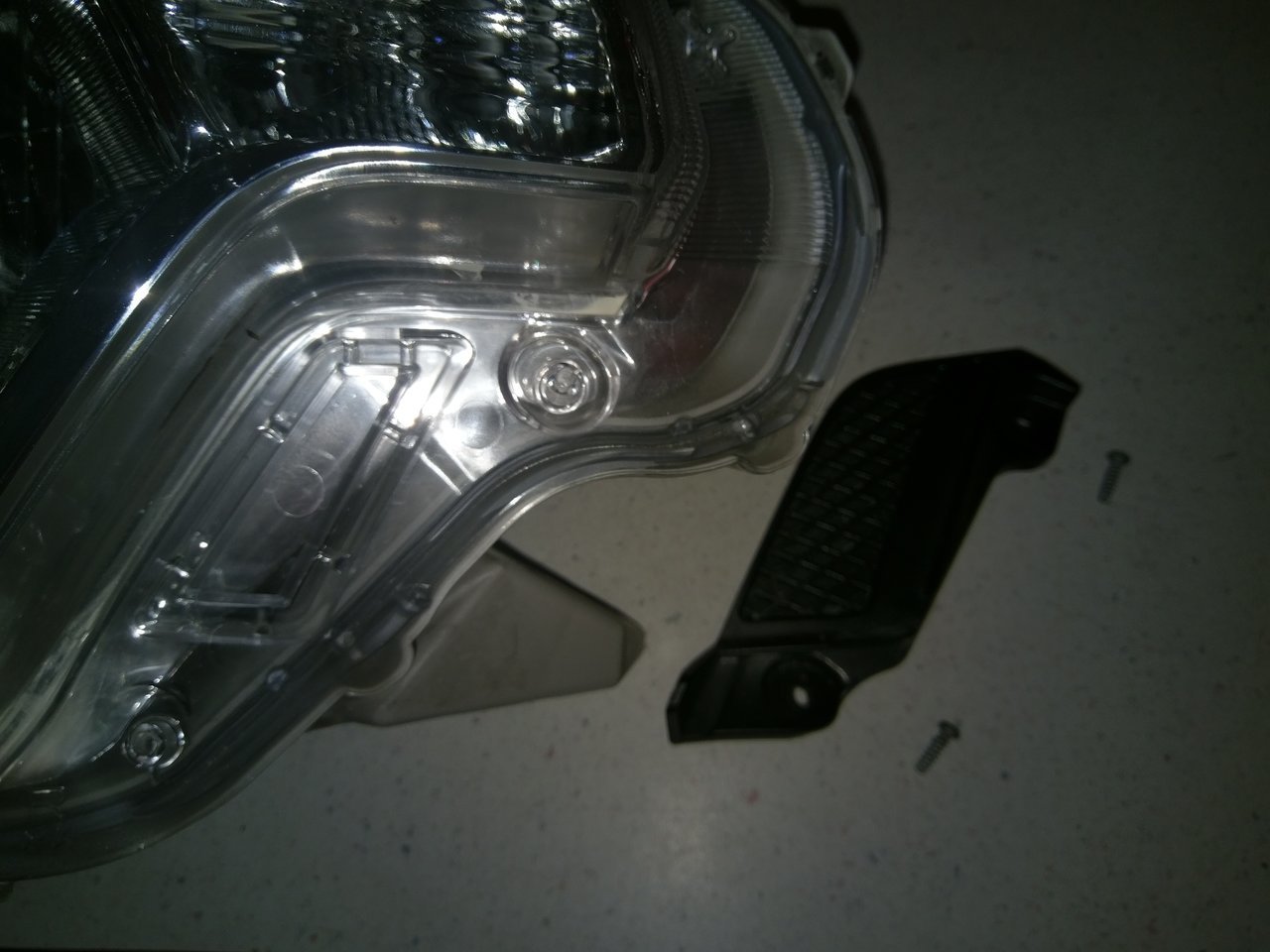

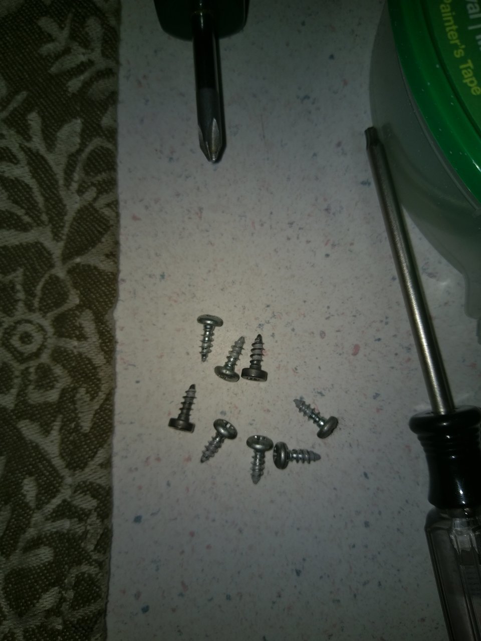

    Disassemble...

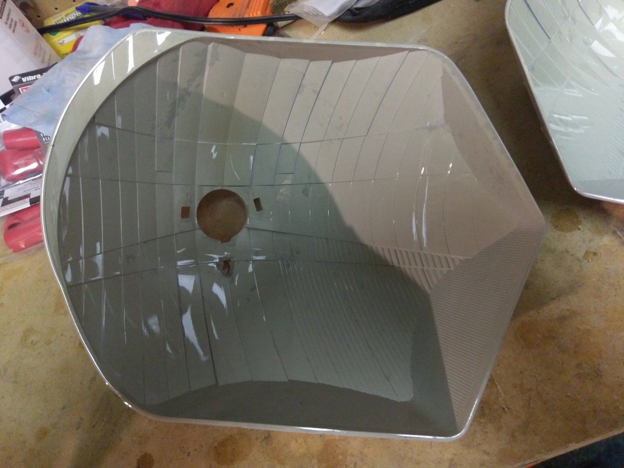

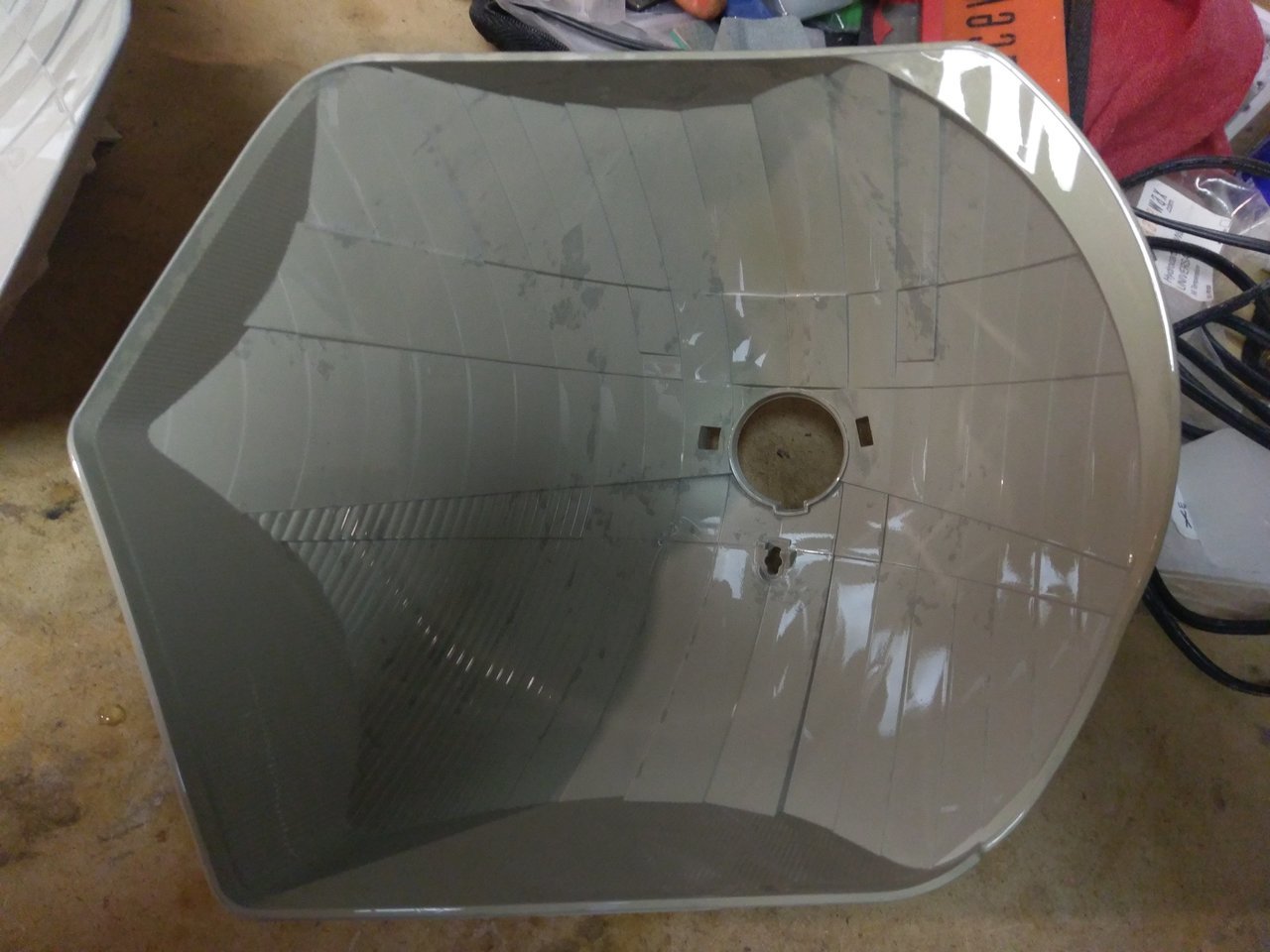

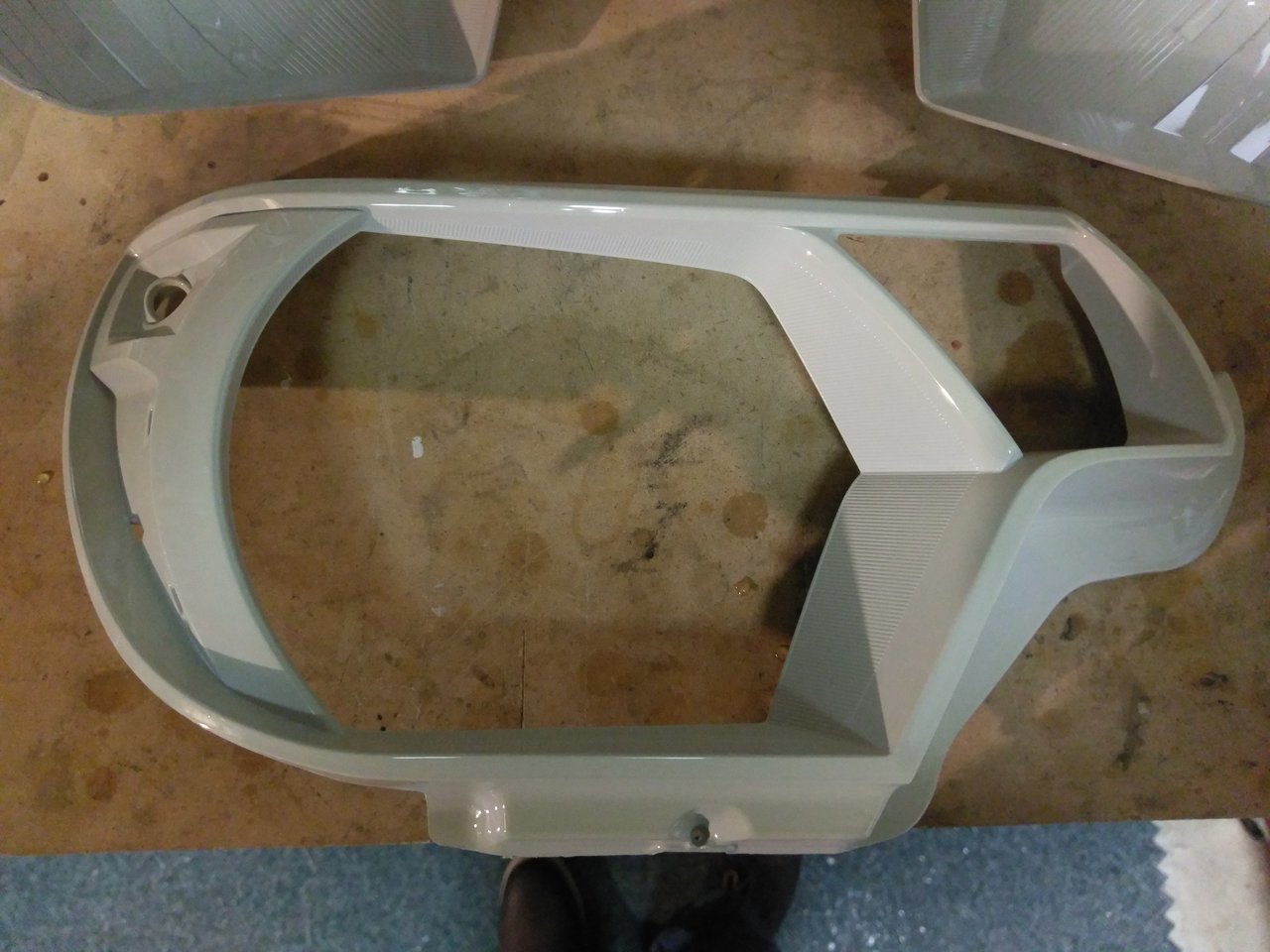

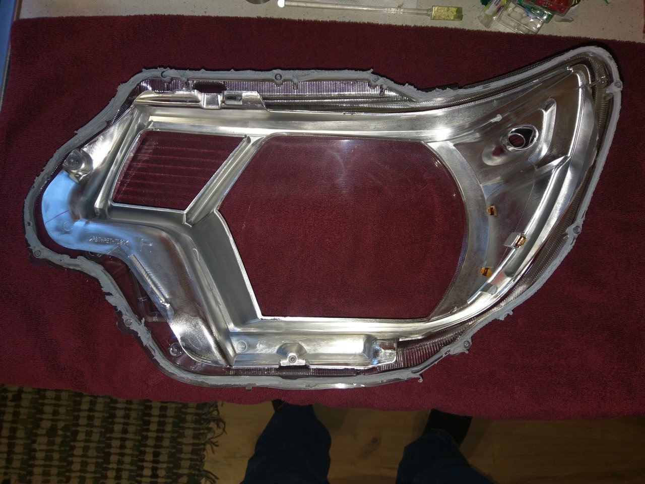

    Disassebled, de-chromed, cleaned the mounting tabs off the bowls. Ready to start the build.

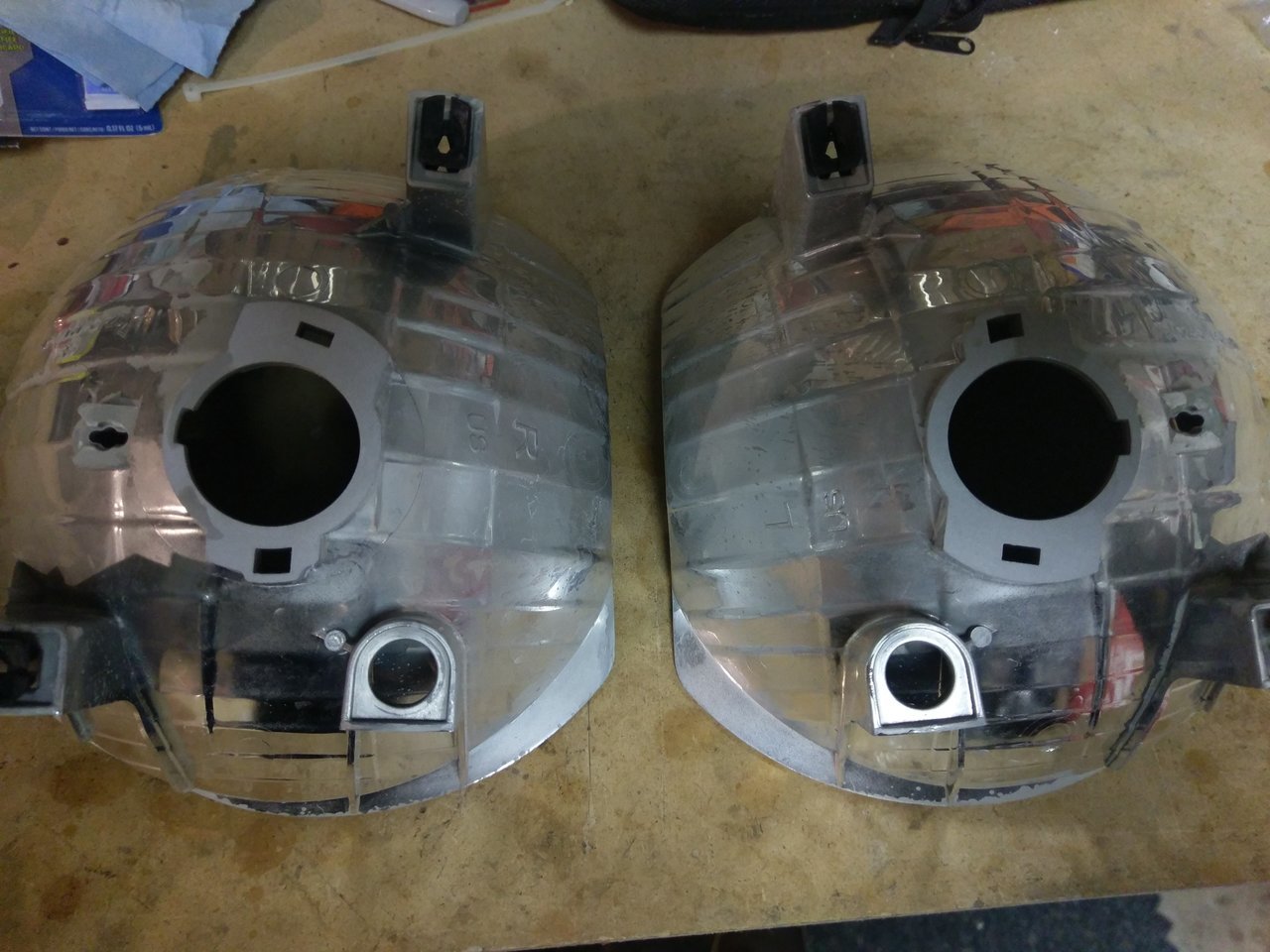

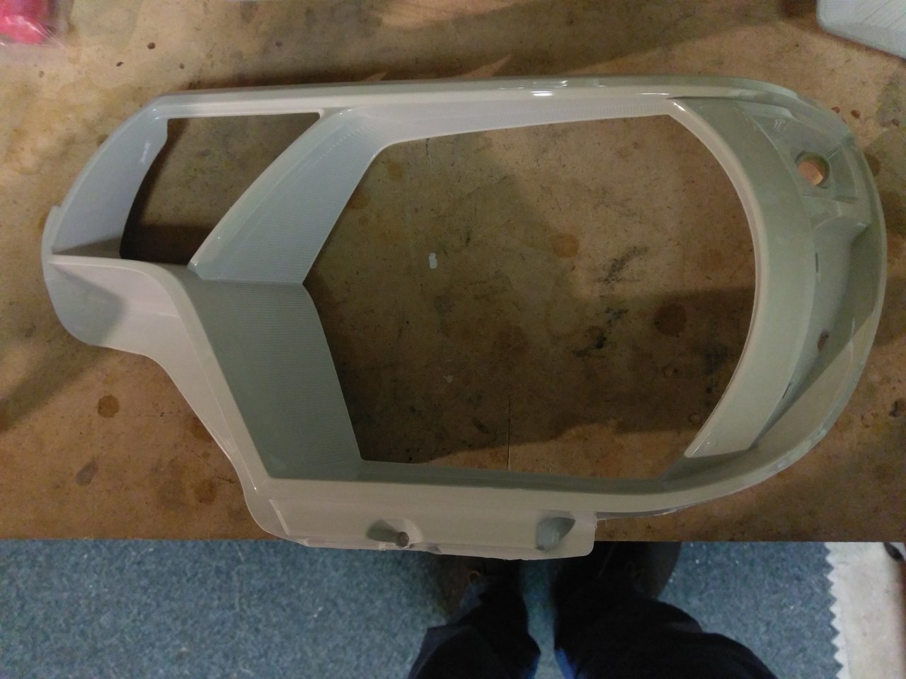

    Primer

    Well, true to form, I managed to botch the primer. Needs some fixing before the color can go on. I thought I was being so careful too. :goingcrazy: I managed to put it on a little too heavy in a few spots and got a bunch of tiny little bubbles and some uneven coverage.

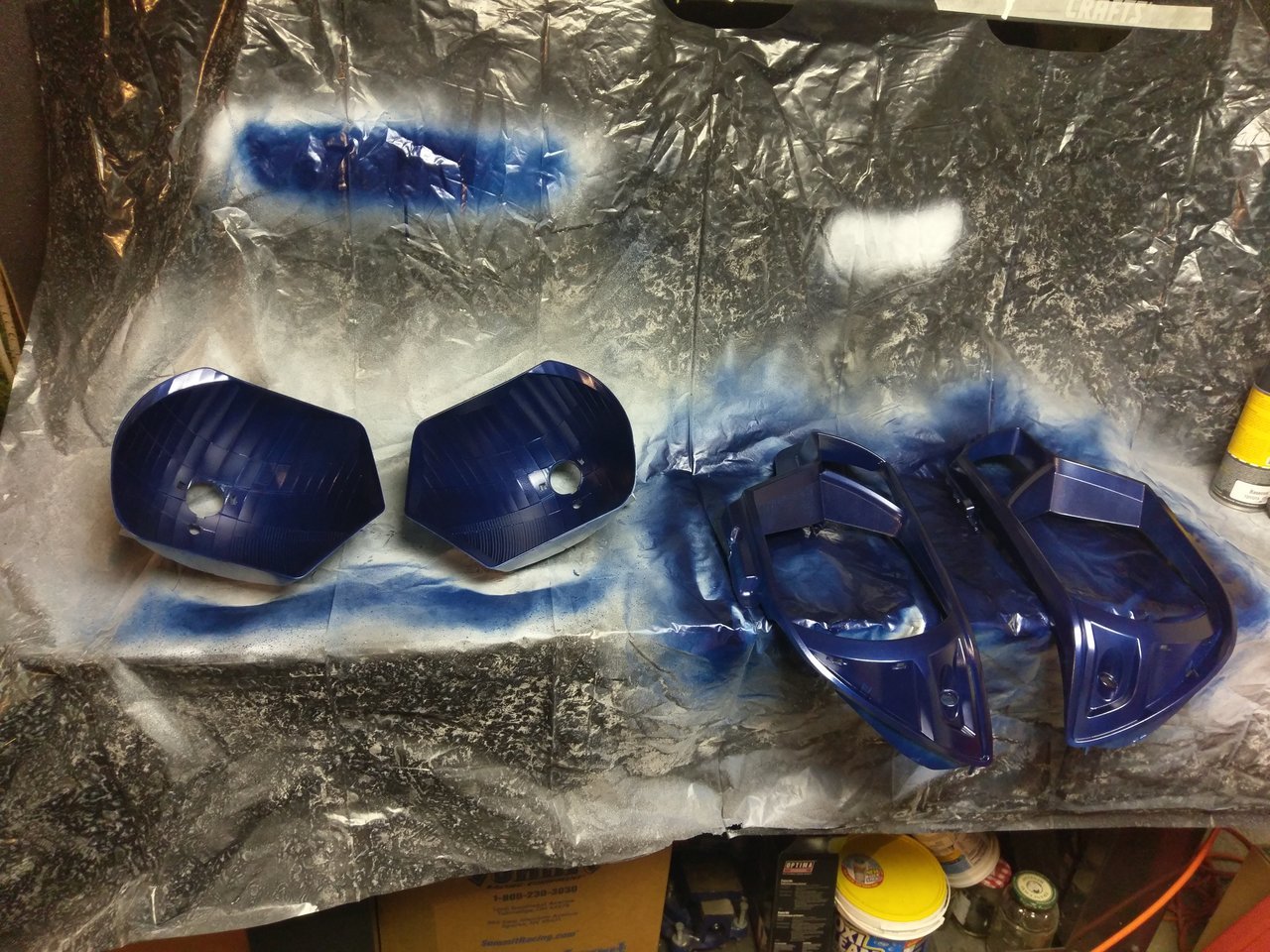

    And then they were blue.
