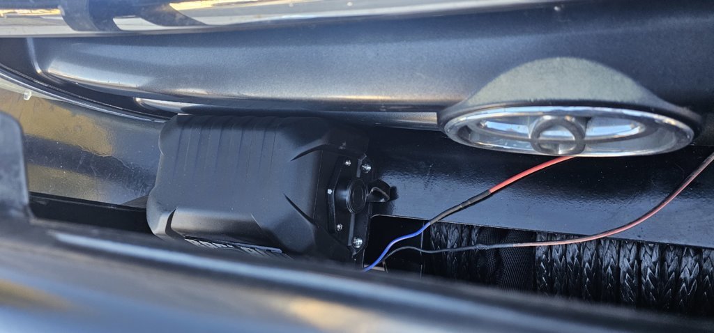

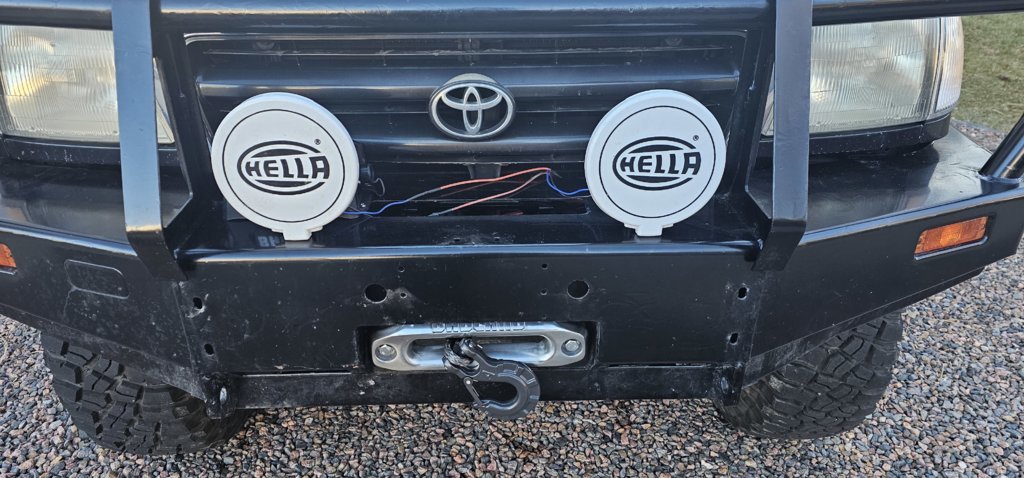

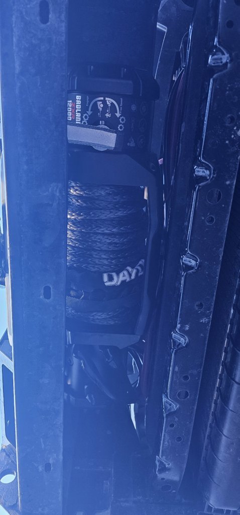

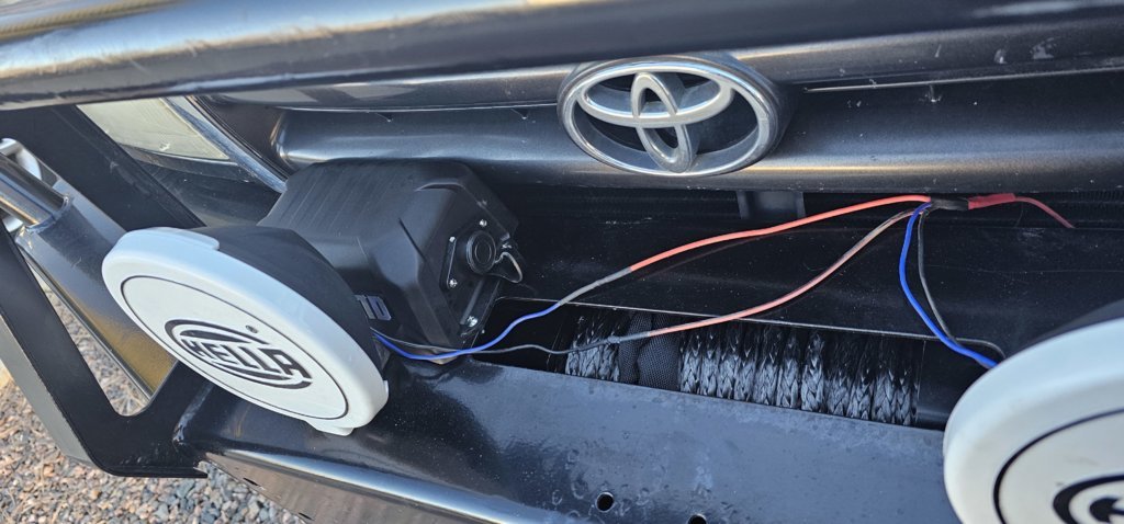

    I wanted the full functionality of the winch and didn't want to have to do anything crazy to get it.

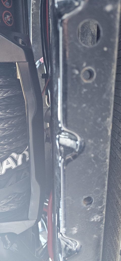

    I ended up installing their 12,000lb ZXR winch and it was tight! The top of the winch touches my radiator crossmember (edit, barely misses touching my radiator crossmember!) and where I chose to mount the control box is pushing in on my plastic grill.
    I swapped out the steel cable for a 70 dollar 25,000lb line from Amazon. I have a new hook and a few accutremon coming from Amazon as well. Overall, I'm pretty happy with the way it came out.
    I need to pretension the rope and then I'm looking forward to using it. Hoping to get into some snow wheeling soon.:mudding::yay:

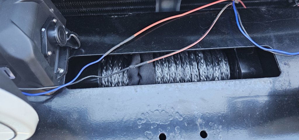

    Some pics. Please ignore the loose spotlight wires. I need to get some wire casing to clean them up.

    Got the same gnats ass fitment mine does to the core support. Just watch that the spooled line doesn't pile up too high there when winching or the line will fray on that support bracket.

    how's the access to the spool switch? would not for my truck skid plates in the way to get an arm up under there, hell my 09 getting to the control is a pain in the ass with the 9in lights up front!
  12. Dec 30, 2024 at 8:49 AM
    #32
    Dare Devil Diablo
    Dare Devil Diablo [OP] Well-Known Member
    Aug 2, 2020
    #336417
    404
    2000 TRD Offroad MT
    Spool switch is easy for me to get to. It sits right on the bottom of the winch as it sits in the truck.
    I would imagine even with a skid plate you could reach in from the side pretty easily. I'm not sure though. My truck sits on a 6" bracket lift so my skid plate is pretty far away. I have plenty of room. I can get at it without bending over too much.
