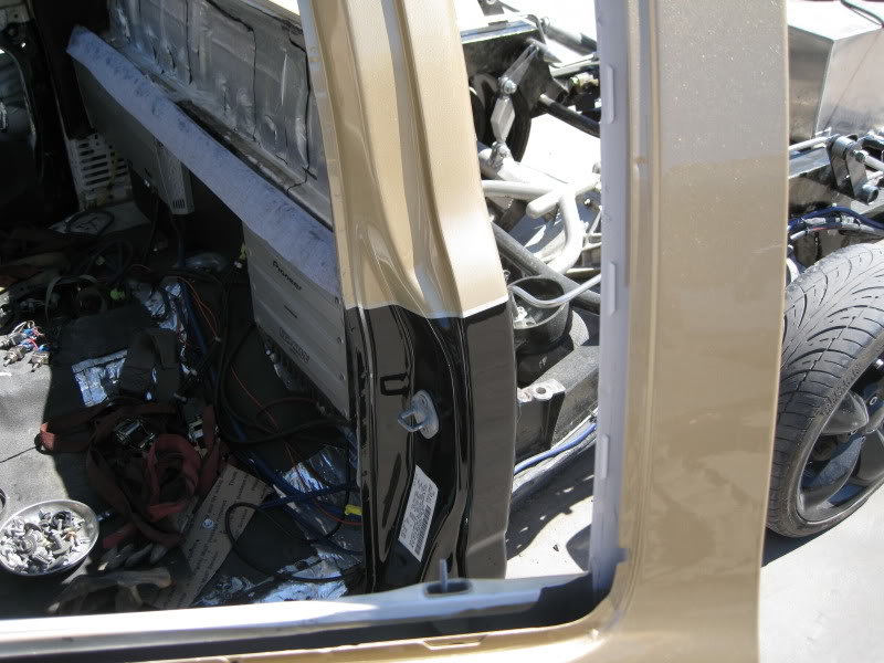

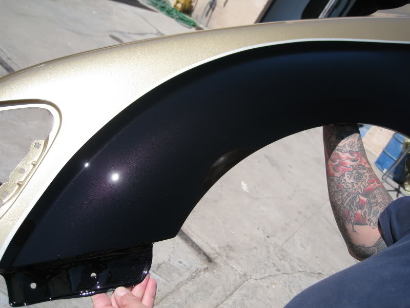

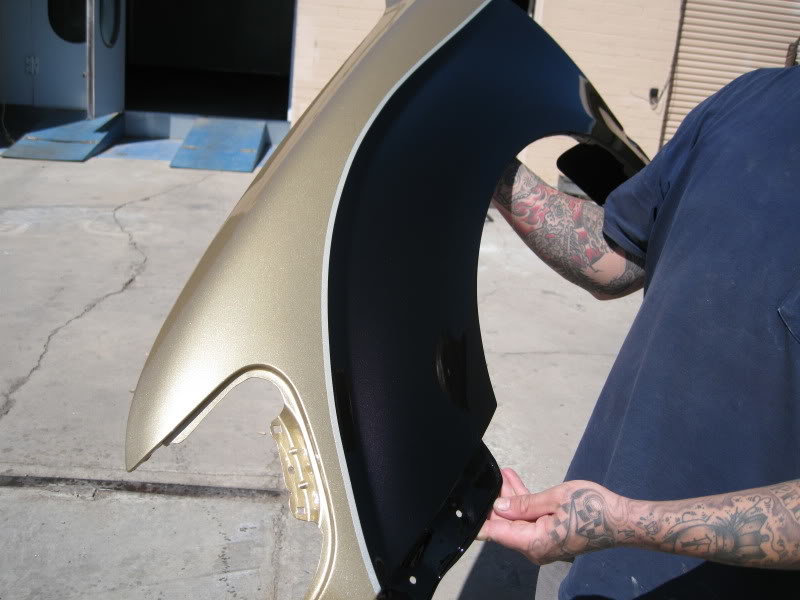

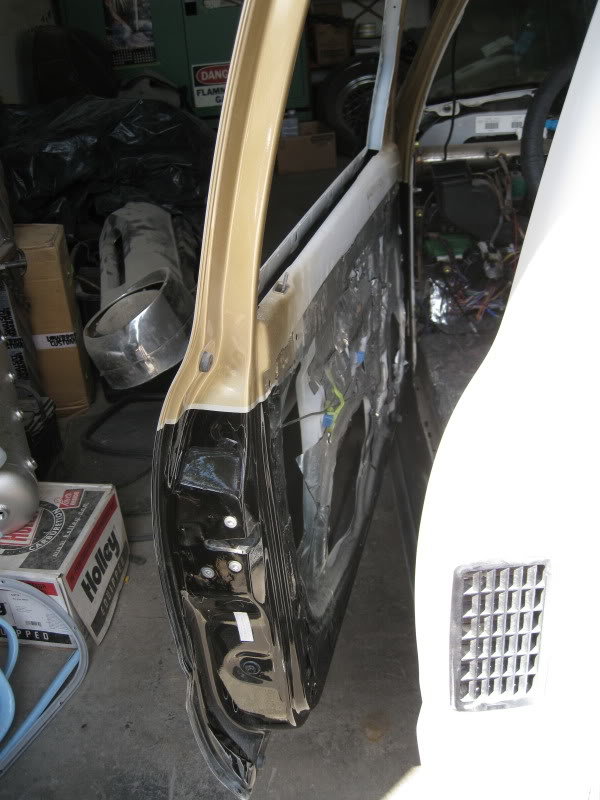

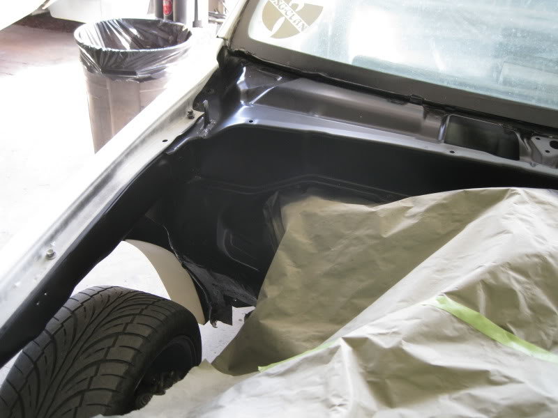

    Decided on satin for the engine bay, there is going to be so much bling under I thought it might be over powering to do it in gold as well. Will have to wait until it is all together to see if that idea pans out or looks like crap.

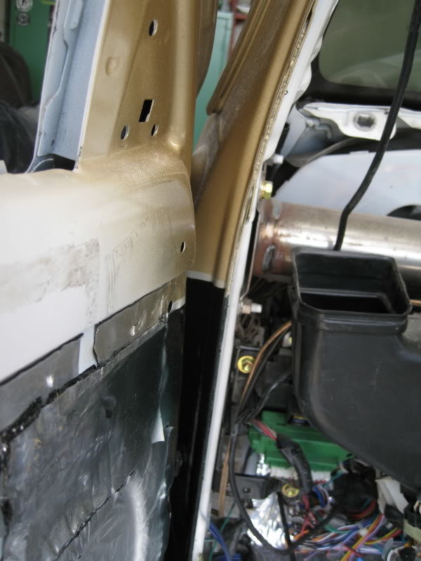

    they are pretty dusty in this pic, but I got the jams done.
    and the inner fender splash thingy

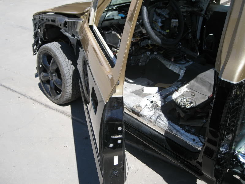

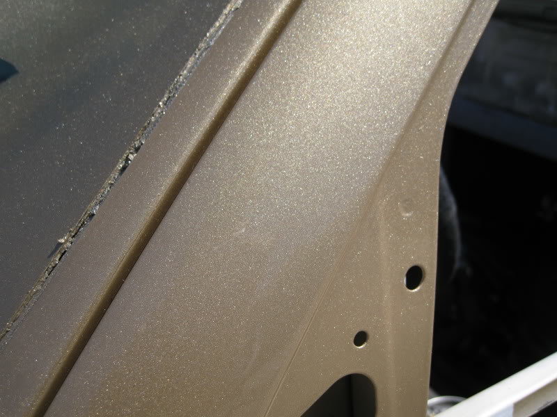

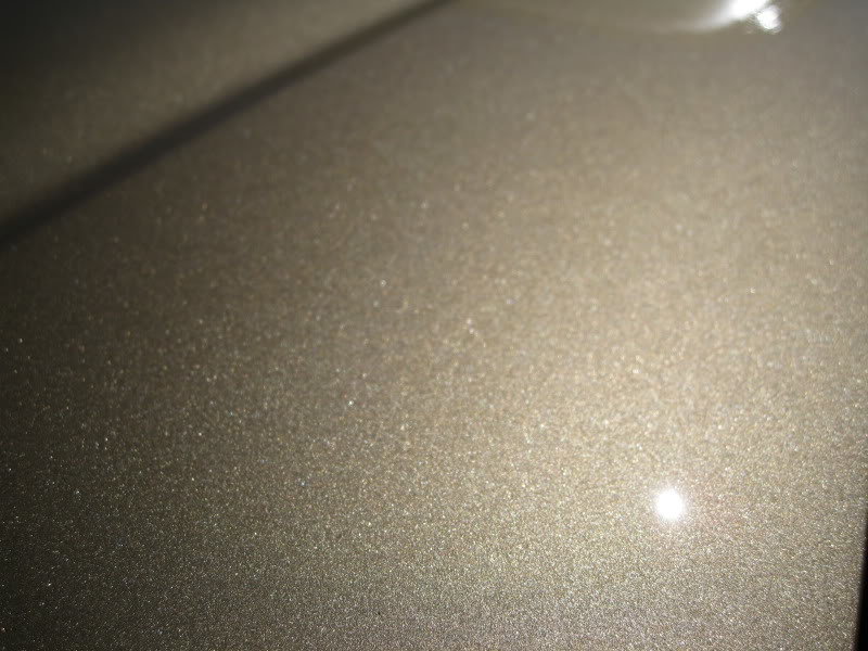

    more parts back from powder coating.
    IMG_3717 by BSGcustoms, on Flickr
    underside of the hood jammed in gold
    IMG_3711 by BSGcustoms, on Flickr
    IMG_3707 by BSGcustoms, on Flickr
    start of my new hood prop
    IMG_3725 by BSGcustoms, on Flickr

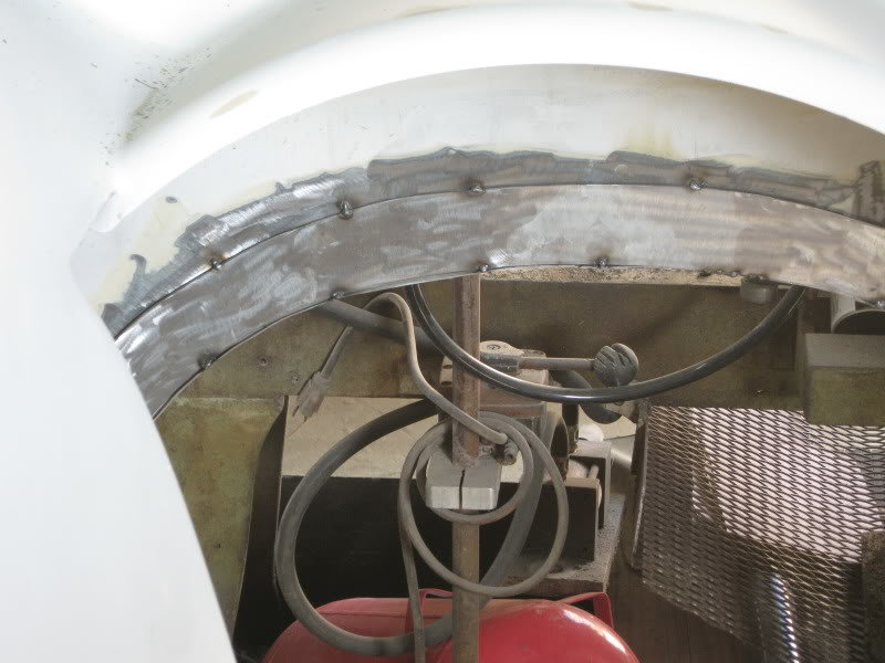

    I made some inner fender support things out of 12ga to beef up and smooth out the wheel wells.

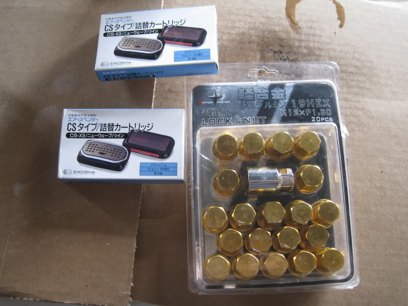

    hahahaha I got myself some new JDM goodies, gold aluminum lug nuts, and of course some squash air fresheners.

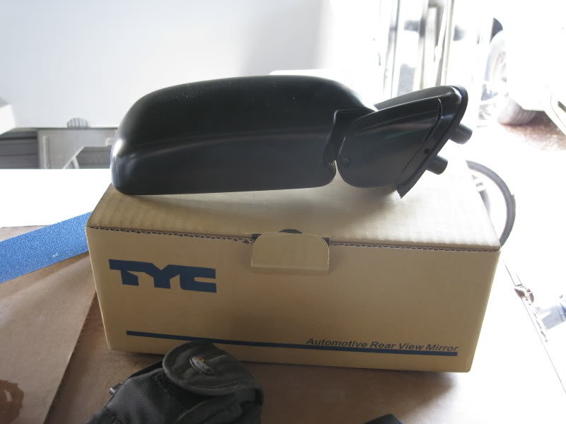

    also got a new side mirrior

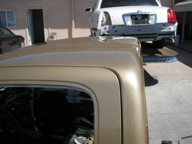

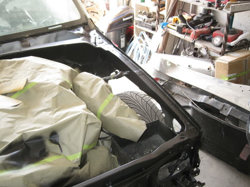

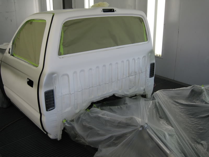

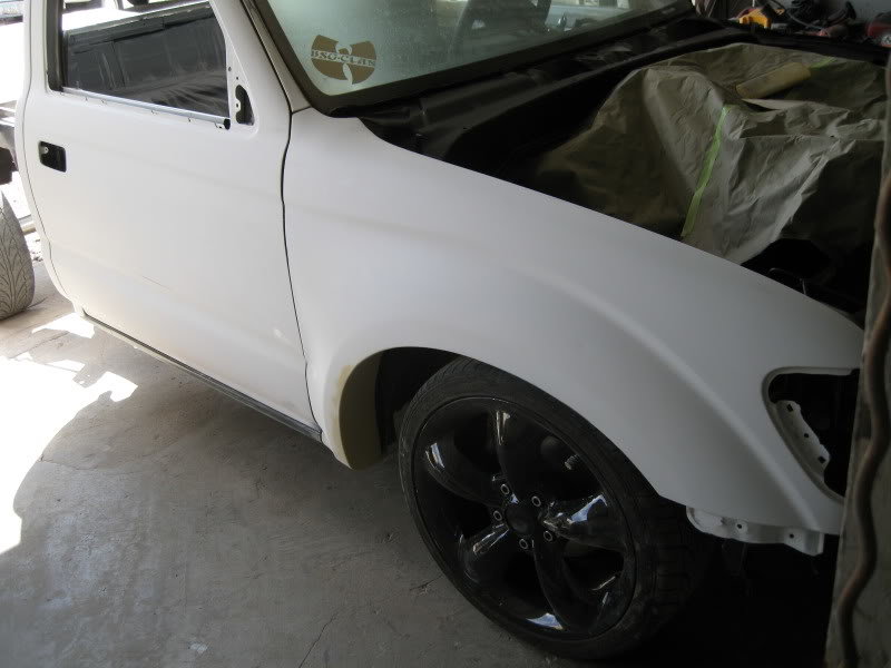

    Painted a bunch of parts, the black is actually a really cool color but it just looks like plain gloss black in pictures haha.
    IMG_3729 by BSGcustoms, on Flickr

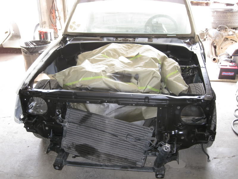

    the engine bay slowly but surely looking less haggard. I think I am going to put my yellow top in it before the show.

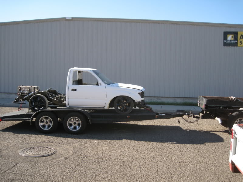

    Took the cab down to the booth today, my boy let me borrow the big ugly diesel and a huge thanks to Glenn for lending me the trailer today. The gold looks super sick in the sun, the camera just couldn't capture it. The plan is to paint my bed along with Damien's this Tuesday.
