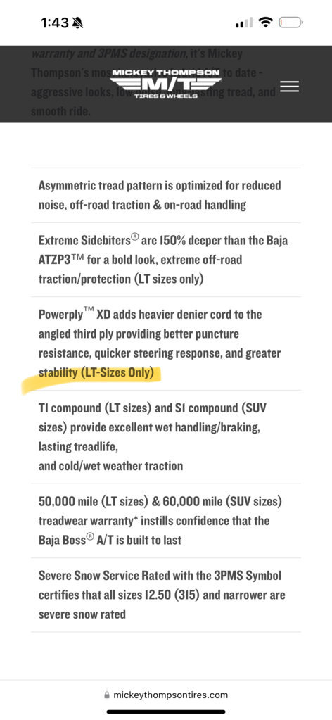

    What load rating are you guys going with/ have you guys chosen on the Baja Boss??
    interesting seems like there’s some additional “features” if you will depending on LT tire or not IMG_8502.jpg

    I did the SL rating in 265/75r16. I previously had the Yokohama mud terrains in 255/85r16 (55lb). The LT tire rides super rough, now that I have switched, I would highly recommend the SL. The truck really struggled to keep up with a tire that heavy. It wasn't that bad, but I really was paying for it through ride quality and especially mpgs. I have bilstein 6112s so suspension wasnt the issue.

    I inquired about the SL vs. LT differences. They basically said the SL is a highway tire whose main feature is a chunky tread; LT is all around heavy duty (emphasis on heavy). Was hoping for some sort of magic for the SL range but didn't sound like it's any more durable than a regular highway tire beyond its deep tread. But at least it's one of the lighter options, still a front runner for me when the time comes..
