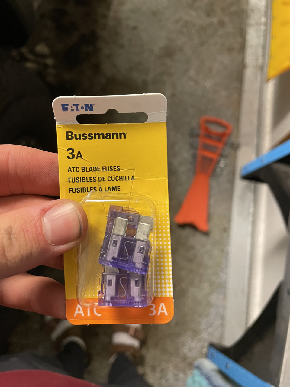

    E84093F6-D09C-424A-AB13-A0A1DE4D7358.jpg BF62FCF2-1EB7-4286-8796-1A5C3CD7F64F.jpg
    Put in a new fuse exactly as instructed. Still no luck with them turning on. Light bar still working properly. Any other issues?

    Got them to work. Had to strip down the wire with the broken metal and remove it. Thank you guys
