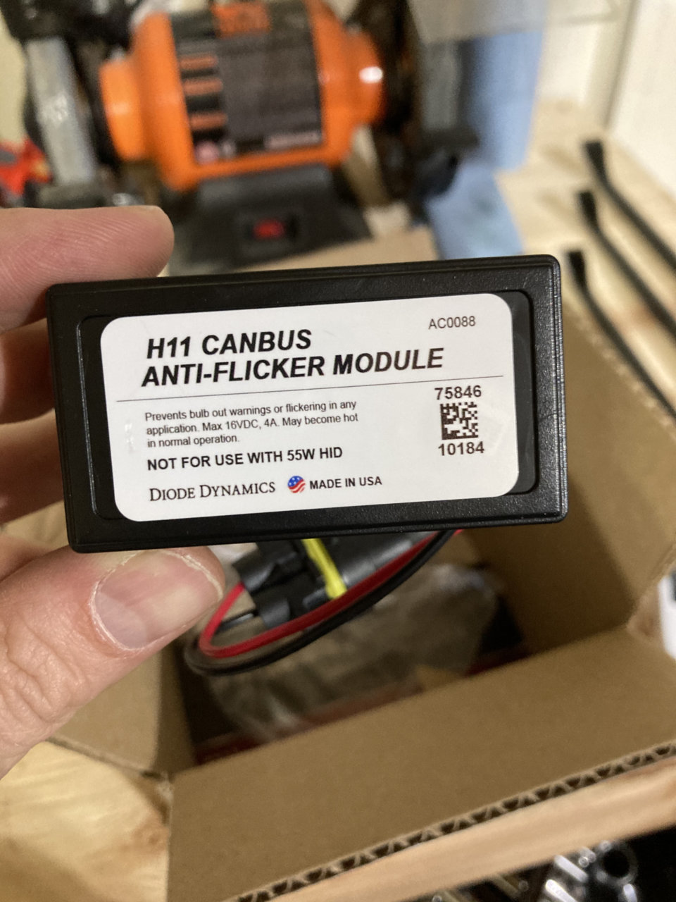

    @Diode Dynamics anti flicker kit showed up. I installed one of them in line on the passenger fog light. Just the one unit seems to have solved the issue entirely!
    kit is plug and play and only $30.00, well worth it if your flicker continues.

    Amazing!!! I’ll order one. Thanks for the update!

    Update: initial test with anti-flicker can bus — flickering has stopped. I will continue to monitor and report back in longer drives if the flickering persists

    I had a BD Squadron Sport on my motorcycle. When the voltage was low, the light would flicker.
    I don't have a measurement of what "low" is since I was never able to measure while riding and light was flickering. Installing a larger battery to the dirt bike converted to street legal dual sport fixed the problem.
    So if you're experiencing flickering, check the voltage at the terminals to where you are plugging in the lights to see if you're experiencing voltage drop. If so, you may need to wire a relay so the power is drawn straight from the battery to the fog lights.
    The DD box may just be a voltage boost/step-up converter that increases the voltage to solve the problem. It could also be a capacitor to smooth out voltage inconsistencies - that's basically what the battery did on my motorcycle.
