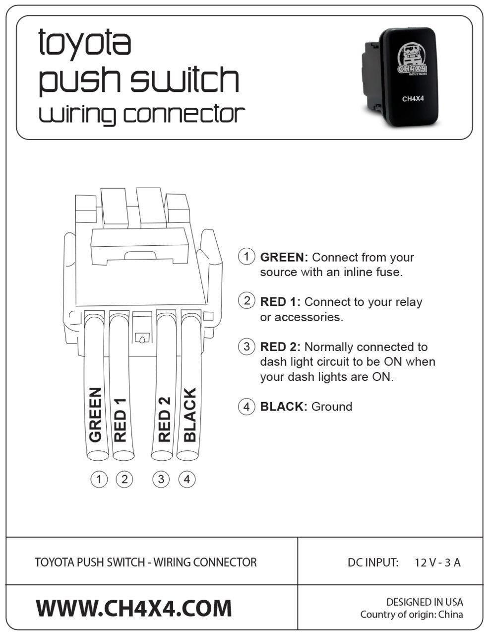

    So im having trouble getting my Squadrons wired up correctly. I have the Squadrons, BD harness w/relay and a Caliraised "OEM" switch. Could anyone shed some light on how i should be wiring this correctly?

    I don't have that switch but I can only assume it has four wires off the back which is what is throwing you for a loop.
    If it looks like this.
    Your BD harness has three wires.
    Your BD black goes to switch black, your BD constant 12v red goes to switch green, your last BD red wire goes to switch red 1. The caliraised red 2 then gets connected via an add a fuse to your "tail" circuit in the fuse box inside the cab.

    BD harness only has 2 wires from the relay which is where im getting stuck.
  15. Nov 11, 2019 at 6:20 AM
    #2855
    Rome604
    Rome604 I am the Captain now
    Feb 23, 2017
    #211478
    4,615
    Dave
    Alexandria, VA
    2023 TRD Pro Sequoia
    Those two wires should be going to the 'load' or otherwise known as 'lights'.
    You should have two wires with ring connectors that go to the battery + and -.
    You should have three wires that were connected to the cheap little round switch that BD sends.
    There are two more wires (Red and Black) that come off the relay and are connected to your lights.
    When you flip the switch it activates the relay and makes the red wire hot.
    Pictures are helpful if you need more assistance.

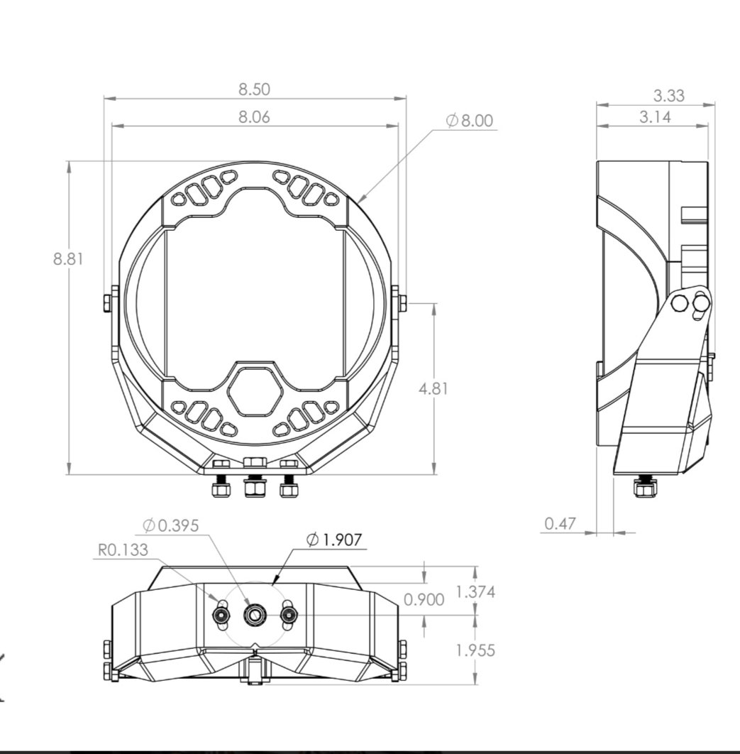

    Are the LP6 and LP9 the same depth, 3.33?
