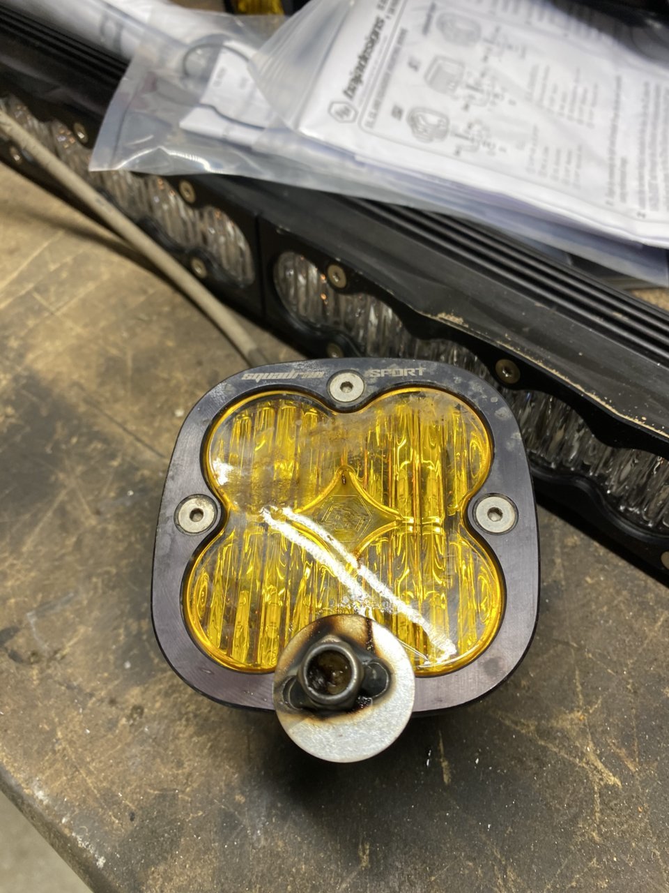

    2017 4Runner
    I had this happen to my squadrons. Dunno if you have a welder but this was my fix. Weld the washer to the stripped bolt, then weld a nut to the washer. Just a couple tack welds is all that’s needed.

    Aren’t they useless anyways since they’re stripped? Whenever I strip a screw my goal is then removal however necessary, and replace with a new one.
    edit: you could take a non stripped one to a hardware store to source a replacement

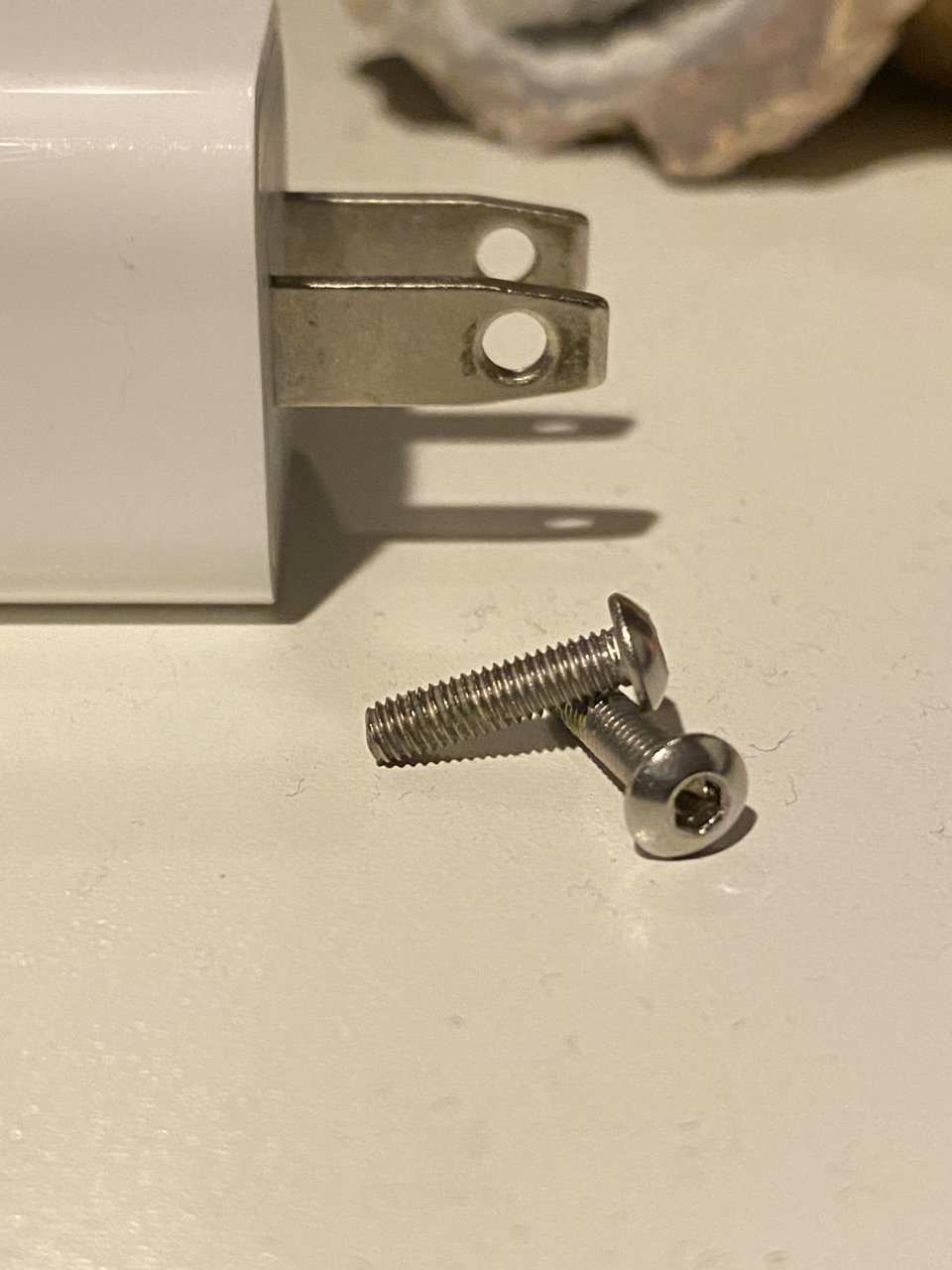

    Hi SendinTheCavalry,
    The correct bit is a 5/64". To remove a stripped bolt on the S1, we use a T9 torx bit. When the light is removed on a level surface, you can seat the torx bit with a slight tap from a hammer. If that doesn't work, we can start a warranty claim to get this resolved. PM inbound.
    -Paul M.

    #145889
    2,948
    San Marcos, CA
    The S1 uses an M3x12mm Button Head Bezel bolt. It's a little bit smaller than the bolts found on the Squadron series.
