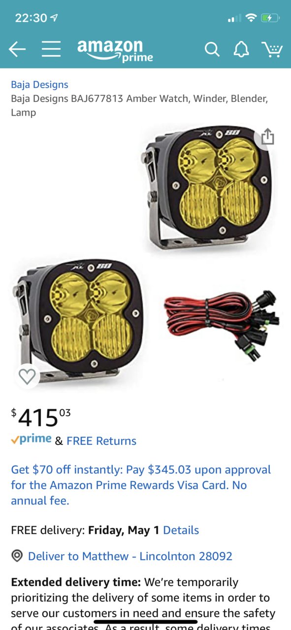

    Shittttt....looks like I just bought some new ditch lights. Now gotta figure out what to do with these squadron pros I’ve got and was planning to use for ditch lights...

    Either they’re knock offs or that’s only for 1 light

    shipped and sold by Amazon, sku# is for a pair. If they are fake or whatever then I’ll have amazon refund me, not a big deal and worth the gamble.

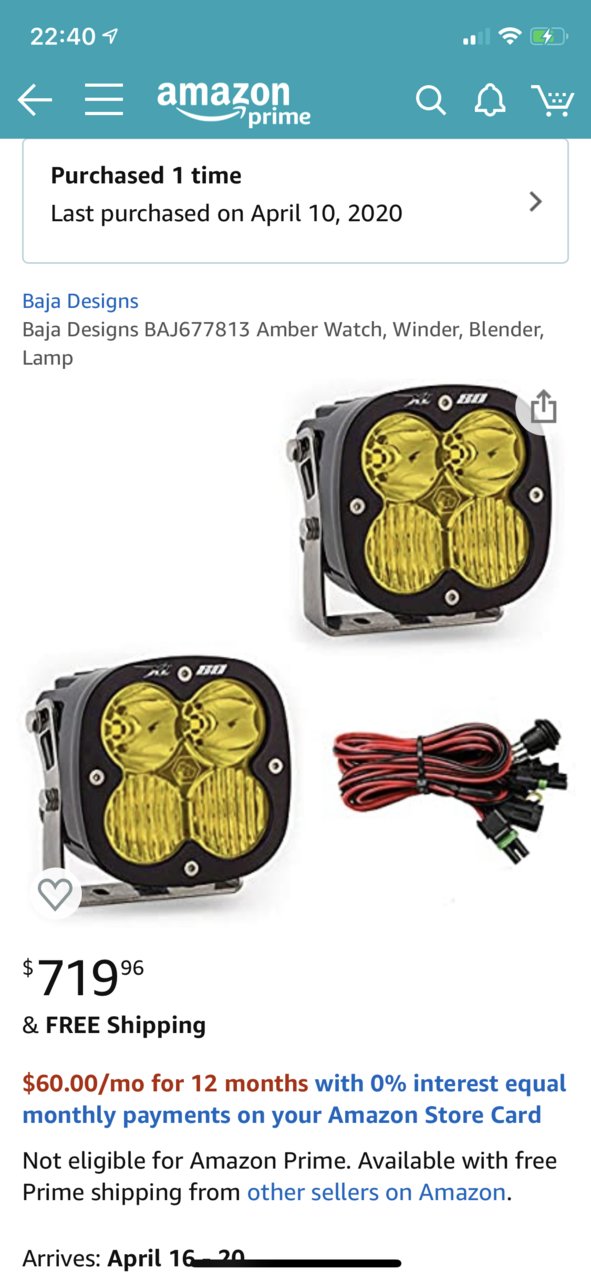

    price just went up:

    Seems they realized their mistake

    Yeah. They have price flukes like that sometimes. I’ve gotten lucky a few times and gotten stuff 50-90% off. It’s luck and perfect timing I reckon.
