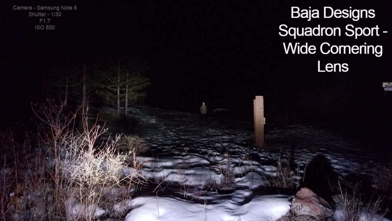

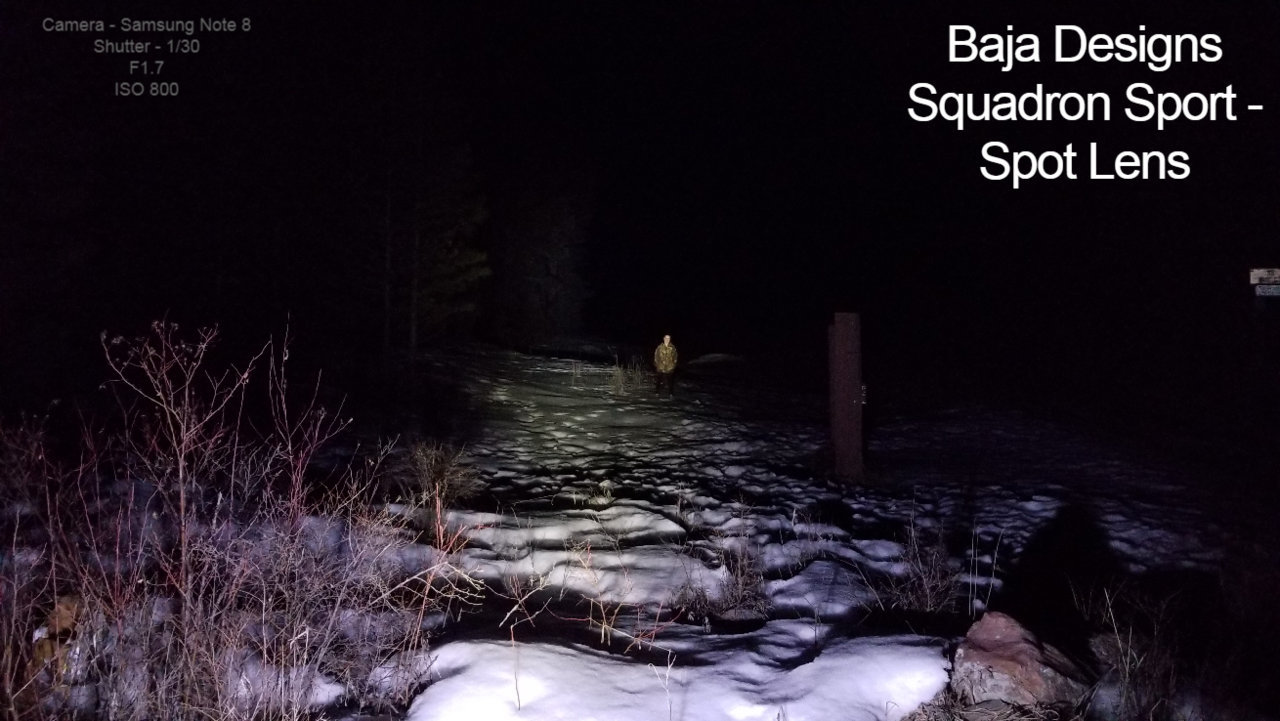

    I was just saying that if you used the LP series of light as "fill" you could devote more effort to power right at the edges.
    Here's a quick comparison between spot and wide cornering lenses. LEDs are victims of optics so even with the spot lens there is still some decent dissipation and degredation of pattern at distance. If you went with a spot lens and pointed it at the edges of the road there is a little bit of light bleeding that occurs anyway. If you had the shorter distance foreground covered with an LP light or a light bar for example you could give yourself additional assistance in one of the areas that we generally complain the most about. If you wanted more coverage within like 100ft then you are right, you'd want to go wide cornering.
