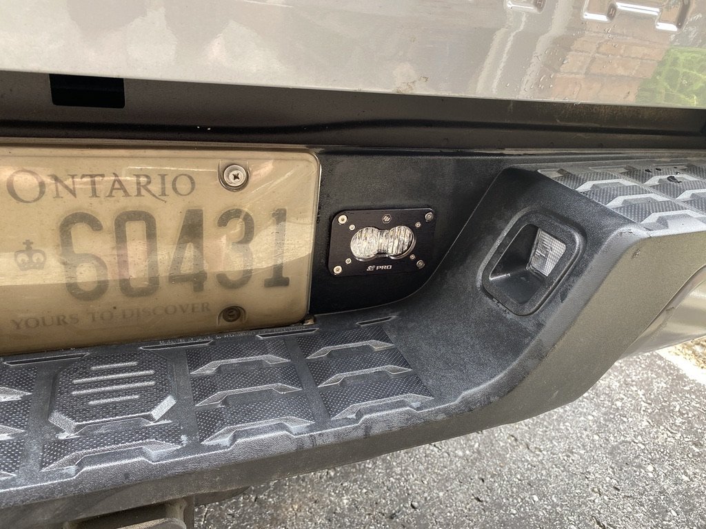

  3. Jul 19, 2020 at 1:36 PM
    #3463
    mrCanoehead
    mrCanoehead Well-Known Member
    Nov 9, 2017
    #235493
    758
    Ottawa
    2018 DCSB Sport manual 3.5 l
    Nice. I have a 20 gauge wire that runs from an auxiliary fuse box under the hood to some LED lights in the bed. The Baja light will only be about 1.5 metres from my splice point. The total current on that wire will be 3.7 A because the Baja light is only 1.7 A. I will have a 5 Amp fuse on the wire at the Blue Sea auxiliary fuse box. The bed and Baja lights will never be on at the same time unless I leave the bed lights on by mistake.
    The other feed is from the trailer hitch, I think the run is less than 0.5 metres.
    I am going to drop the idea of a switch in the cab because I can't name a specific use case for it. All I have to do is put the truck into reverse if I want to turn the light on.
    If I get under there and there's an easy way to run a new supply from the Blue Sea auxiliary fuse box under the hood, I'll run a new 16 gauge wire because I keep finding new stuff I absolutely have to have. This truck is a disease.
  4. Jul 19, 2020 at 1:52 PM
    #3464
    Jnull
    Jnull Well-Known Member
    Mar 22, 2019
    #287519
    288
    4 cummins trucks!
    Little different but I have 4 rigid pods in my rear bumper that I would not want activated every time I put it in reverse. If you have to back up on the street, when you’re in a parking lot full of other drivers and other scenarios are the reason why. I simply put mine on a switch so they’re activated only when I want. Just my $.02

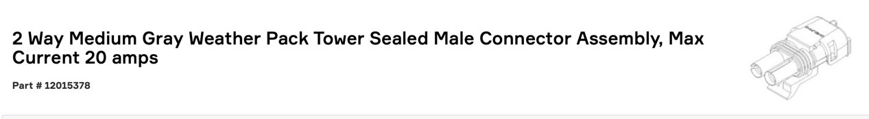

  7. Jul 20, 2020 at 10:07 AM
    #3467
    Baja Designs
    Baja Designs [OP] The Scientist of Lighting Vendor
    Jan 8, 2015
    #145889
    2,945
    San Marcos, CA
    We use weather pack connectors with our LED lighting. https://www.amazon.com/conector-ter...s=weatherpack+connector&qid=1595264522&sr=8-3 Let me know if this was a brand new light purchased and if it was missing the connector. I would be happy to get a set sent out ASAP.

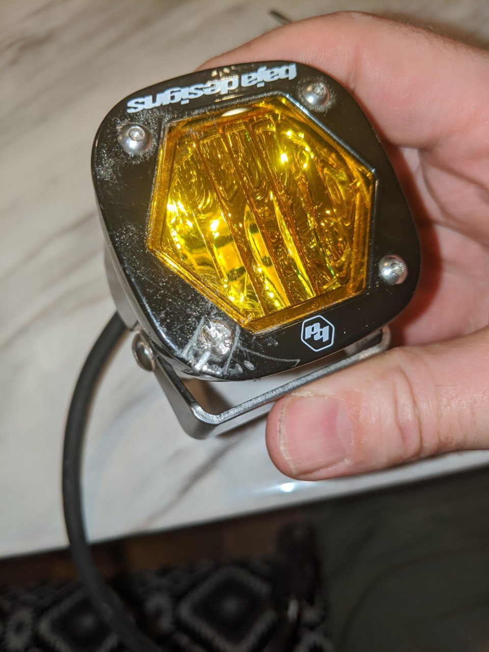

  8. Jul 20, 2020 at 10:09 AM
    #3468
    Baja Designs
    Jan 8, 2015
    #145889
    2,945
    San Marcos, CA
    That wouldn't be considered normal but it is covered under our limited lifetime warranty. I will get new bezels sent out today, PM inbound. Thank you!

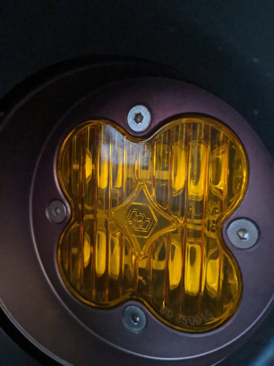

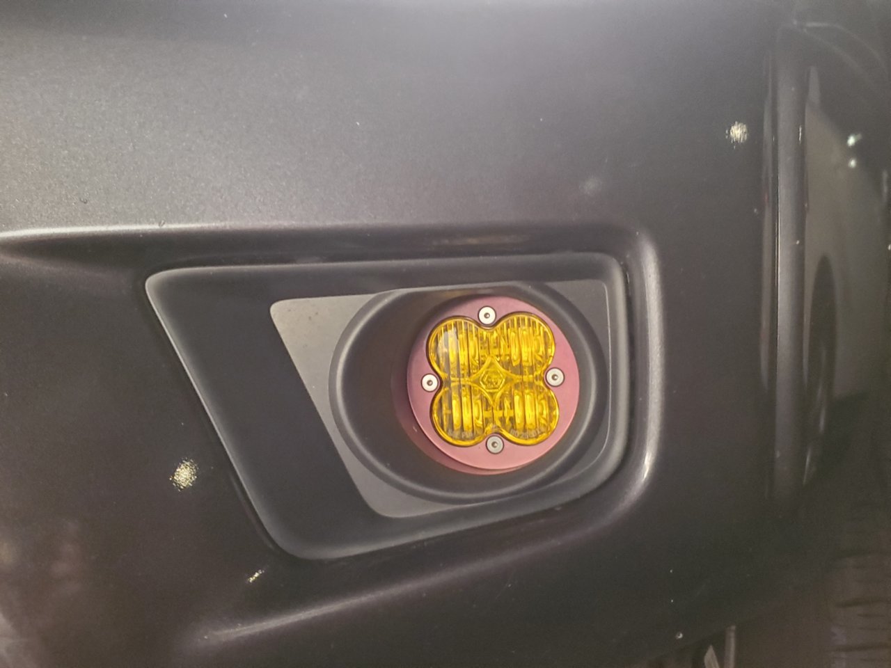

  10. Jul 20, 2020 at 6:10 PM
    #3470
    CttAznRanger
    CttAznRanger Crazy NE Asian with the Cali Lean (temporary)
    Dec 3, 2018
    #274702
    4,757
    Brandon
    Boston, MA
    2018 Tacoma TRD Sport
    I got a similar issue on my pair as well as my uncle's. First pic is mine, second is uncle's. I can get more photos if necessary.
    YMMPRO likes this.

  12. Jul 23, 2020 at 5:33 AM
    #3472
    EatSleepTacos
    Mar 24, 2015
    #151688
    59,846
    Randy
    West Valley, AZ
    2017 4Runner
    What is the thread pitch on these? M3x0.5mm or M3x0.35mm?

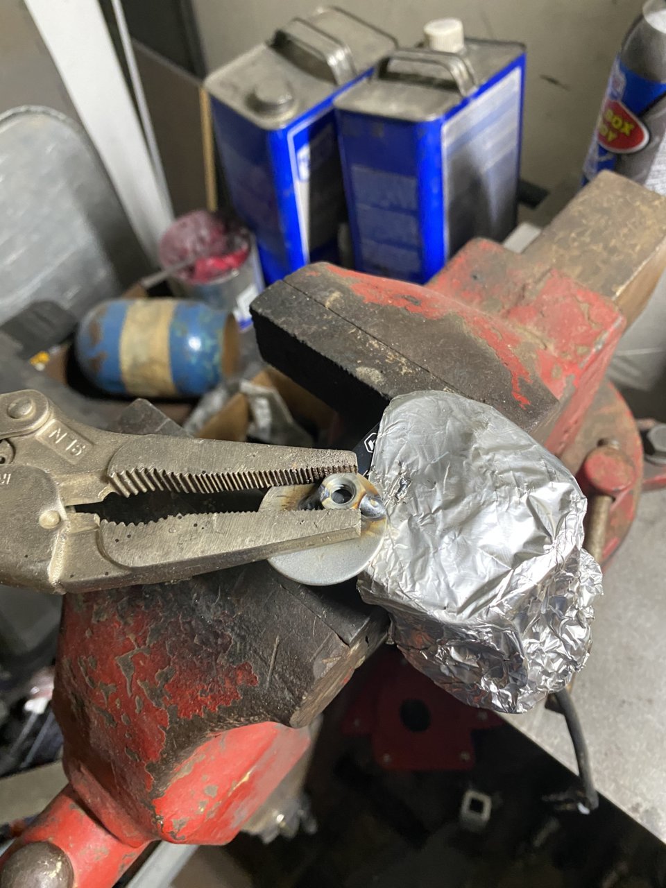

  14. Jul 23, 2020 at 6:01 AM
    #3474
    EatSleepTacos
    Mar 24, 2015
    #151688
    59,846
    Randy
    West Valley, AZ
    2017 4Runner
    I was sooooo close today to not rounding them out but I didn’t quite make it. Couple of tack welds and good to go, no damage to the light.
    20BB1F24-37D2-4B6C-AAB7-45E11B1CBE42.jpg C8119D97-60C7-4F24-8565-06FC6158B548.jpg D74B787A-0C49-4BEC-9DAC-E8C9AF6F4C4E.jpg
    Hawk373 likes this.

  17. Jul 23, 2020 at 6:17 AM
    #3477
    Rome604
    Rome604 I am the Captain now
    Feb 23, 2017
    #211478
    4,615
    Dave
    Alexandria, VA
    2023 TRD Pro Sequoia
    Mine was the LAST screw.....I was able to loosen/remove the other 7.
    Since I don't have welding skills I had to cut a slit in the button head and remove it with a flat head.
    Since I'm replacing the bezels with flush mount I didn't care about being nice to the bezel.
