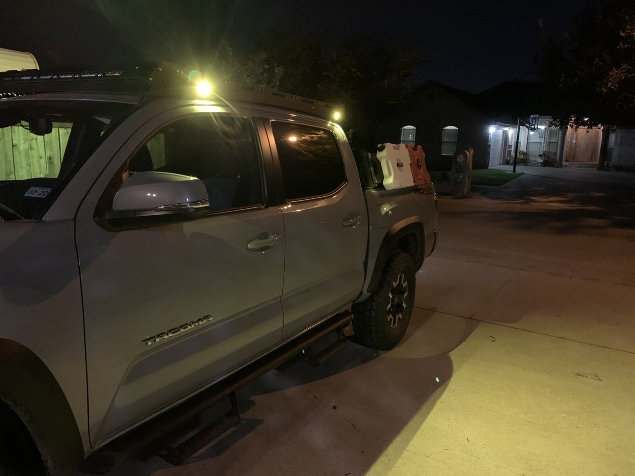

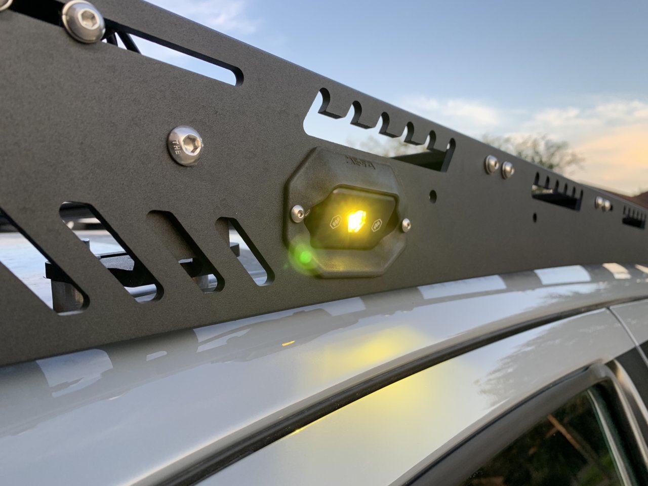

    Alright. I was able to get all that in with your advice. Now my next problem. I wired it all up and as soon as I flip the switch I blow the 15A fuse. Now I’m pretty sure I wired them in the correct way. Theoretically, if I wired one reverse, would it cause the fuse to short out or would just that light not work? I will admit, I ran the harness down the passenger side along the window and i put the ground on a bolt there by the hood hinge. I then ran an extension wire from the positive line all the way to the battery since it didn't reach. I doubt an improper ground would blow a fuse. So my guess is i either cut a wire somewhere or i wired up some of the rock lights in reverse which i highly doubt.

    If one was wired reverse, it would blow the fuse because it's grounding out the circuit. Does the fuse blow when all four lights are unplugged? If not, we can do a process of elimination by plugging each light in to see where the disconnect is.

    Ahh. Ok thats all I needed to know. I'll check them out later. I probably had one reversed. Thanks again Paul.

    Came out great!

    Looks awesome! Those MESO mounts are super clean too.
