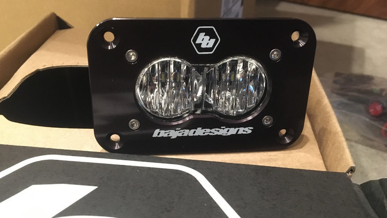

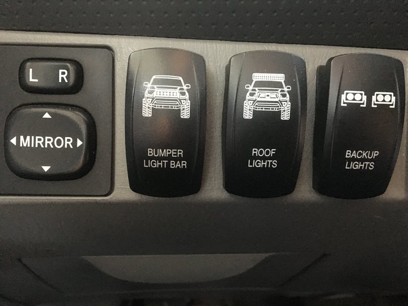

    Just installed my new S2 Pro backup lights today. Had a custom bracket made to mount the lights to the trailer hitch. I'm liking them!

    Did you wire into the backup lights, or did you put in a separate switch?
  11. Oct 9, 2016 at 11:01 AM
    #371
    Tacoma005
    Tacoma005 Well-Known Member
    Jul 13, 2014
    #133821
    272
    Bellingham, WA
    2005 DCSB TRD Off-Road 4X4
    KMC Crank Rims, 30" Baja Designs light bar, HomerTaco front grill
    Separate switch.

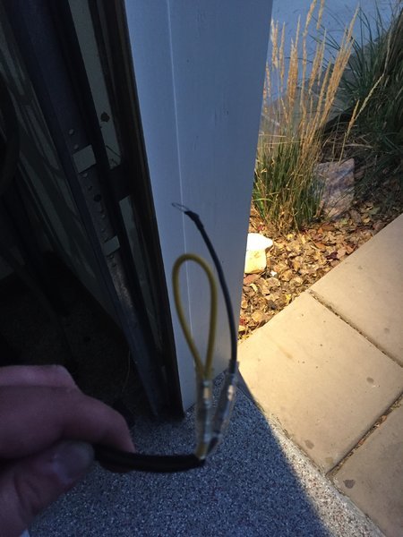

    Just got my S8 20in light bar had no idea it had amber backlit feature till i got it. Added bonus. Really liking the lights happy you include an extra all weather connector if wiring to a different switch!
    Have a question on the wiring harness. There is a yellow wire loop thats been conected to it self. Is that supposed to be that way? Picture below just making sure im reading everything right!

    That is correct. If you wanted to use High Beam activation you disconnect those and connect them to high beam Positive and Negative. Please run the Black Wire with Ring Terminal to a Ground.

    Gotcha thanks for the reply. I plan to run everything to my switch pro, but looked at the harness and tested it making sure everything was working and how it worked. Was confused on that little yellow wire wondering if i was missing somthing else. But all i should need to do is run the two hot wires each to a switch on the switch pro and the ground to ground that is if i want to use the backlit feature.
