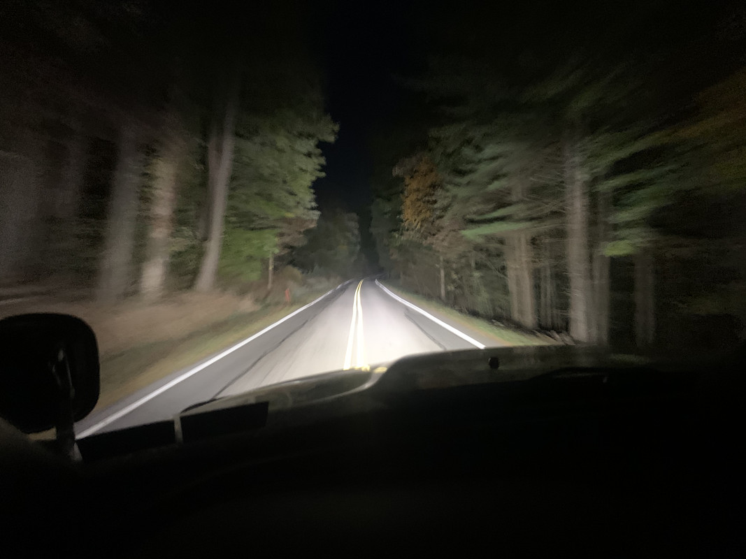

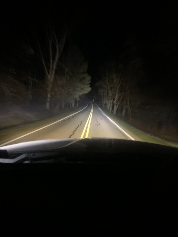

    Since I’ve mentioned it a couple times recently I figured I’d dust off the XL80/S1 ditch light combo for a comparison against my 40” onx6 hi power. I haven’t really used my ditch lights since installing the onx6 since it’s way more light and is faster to turn on/off, and I keep covers on the 80s.
    Obviously the onx6 is a lot more light then the pair of XL80s as it’s essentially 4 XL80s and 2 XL racers, 19,000 lumens vs 46,600 lumens. The onx6 is mounted just above the top of my bumper and the 80s are on the A pillars so a considerable height difference.
    Having said all that the 80s certainly hold their own against the onx6 and they made a big difference when switching them on with the bar already on and I suspect it’s mostly due to how much higher they sit on the truck. While the pictures aren’t exactly comparable since they were taken on different days and different spots on the road they’re still a good comparison. If you take the same light mounted low and high you’ll see a big difference in output.
    first ones the ditch lights and second is the 40” onx6.

    That's pretty impressive. It looks like the bar does a really a good job illuminating the periphery! Are those XL80's aimed straight forward? What type of lens is on the XL80's? I think you have the driving combo on the 40". Though if I am right, with the driving combo on the 40" there would still be 8 reflectors diffused into the wide cornering pattern, yes?

    The bar throws an awesome amount of light to the sides, and yes it’s a driving combo. Each 10” lens section has 2 diffused covers, one at each end of the lens. So you’re correct there’s 8 total diffused leds.
    The XL80s are pointed straight forward and they’re wearing spot lenses, however I just eyeballed and never actually “aimed” them so I’m sure there’s slight room for improvement. I also have wide cornering S1s mounted to the sides of each XL80 pointing toward the ditches. Even with the spot lenses on the 80s they still throw a pretty large beam illuminating the entire road including roadside trees.
