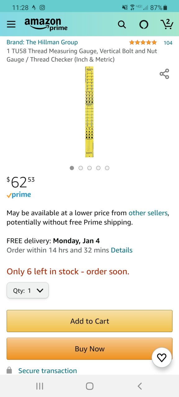

    4 cummins trucks!
    Lol you’re the one that specifically said go to the hardware store.

    Things
    1/4-20 thread
    not sure on the length

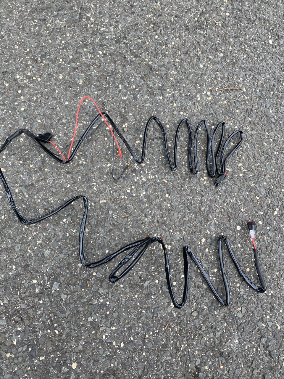

    I have my S2 pro pods and was FINALLY going to install them today. Love the wiring harness that came with it but I am using a switch pro so I don’t need the switch. I’m guessing I can cut the wires off that run to the switch after the inline fuse?

    Yup

    Cut them before the fuse, so you just have two wires, + and -. Your switch pro should have each circuit fused, no need for the redundancy.

    Yep, it'll auto-off that circuit if it exceeds 18/35 amps (depends on which downlead) for ~5 seconds.

    Thanks guys!!!! Appreciate it.

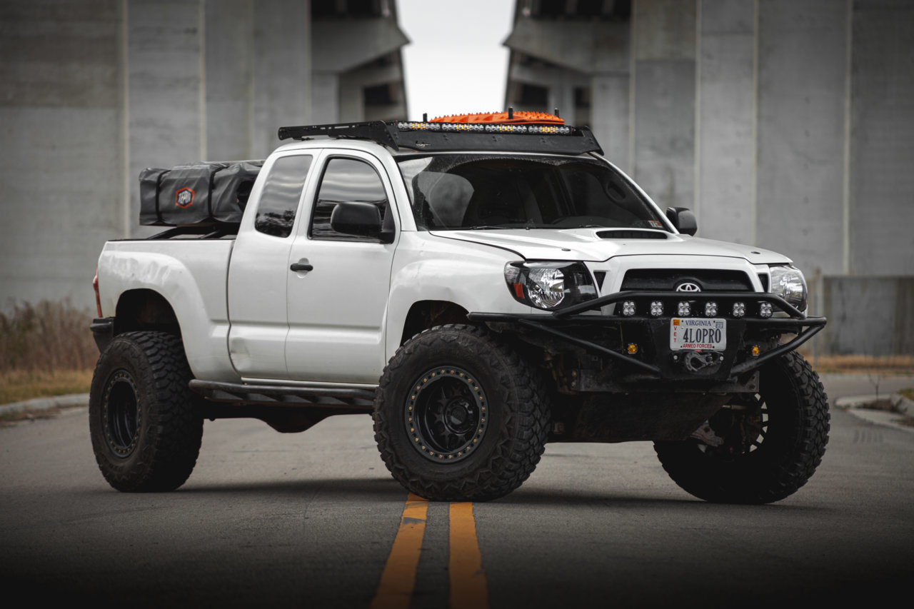

    Look at all that BD goodness. 40” s8 on the prinsu and six squadron sports down low. And of course a couple of S1’s thrown in the mix.
