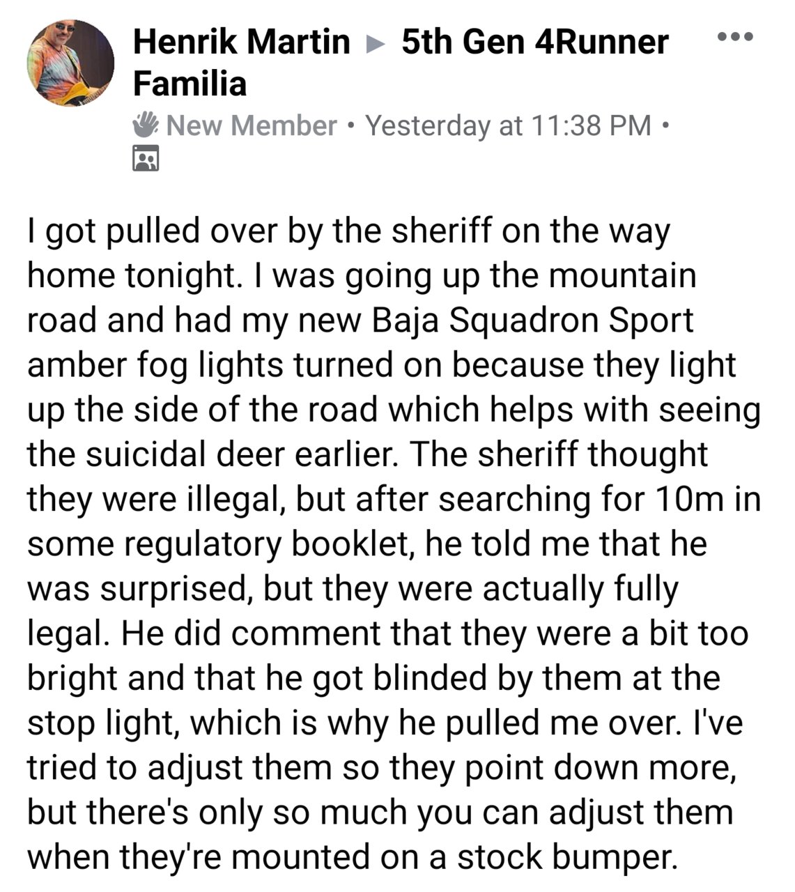

    Yep, what these guys said. Under most conditions, the Sport will not be legal as a headlight, nor will the SAE when used in that location. Have I seen it done? Yes, there is a local 4Runner guy with Squadron Sports retrofitted into the headlight, and they perform exceptionally for what they are. That said, I can almost certainly guarantee that you will be blinding oncoming traffic and probably breaking a local law or two.
    Disclaimer: The following is not legal advice, and is only provided for those that have situations in which these modifications would be permitted:
    I've run Squadron Sports (1800 lumen) in the fog location under daily driving circumstances for many years, with no issues at all. They give me a bit of extra visibility in conditions where the stock headlights don't allow me to see well enough. I've found many common factory headlights to be more obstructive/offensive than the Sports *shrug*. I also run my Miata with the SAEs essentially as my driving light since the factory headlights suck so badly and I don't care to replace them with the retrofits/alternatives on the market - most of which are not SAE compliant either. They function great and provide much better visibility than the headlights, without impacting oncoming drivers from what I have gathered. However, not a legal solution for most people and I'm sure some of the TW police will be upset by the mention of it. Again, only sharing for those that are either exempt, or are already running illegal lifts, tire/mudflap combos, powertrain mods, etc.

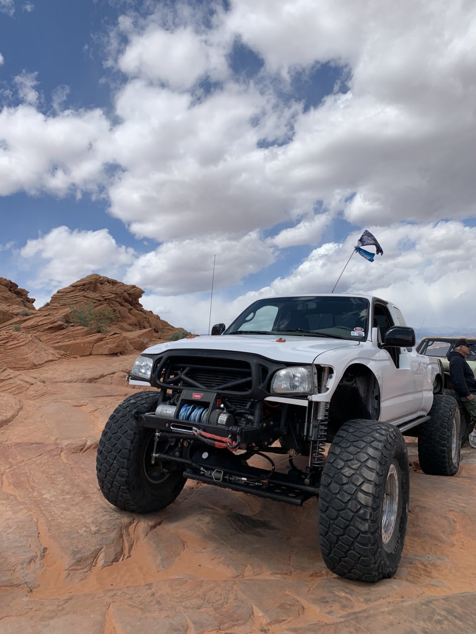

    Long story short. Tubed the front end out and can’t get the headlights to sit level. Plan is to put a squadron and s2 on some aluminum in the headlight position. Rarely drive at night so a decent fog light will be enough for the few occasions I do with the right angle to not blind others.

    Short of like 45* angle to the ground, there's really not a good BD product to do what you're trying to do safely and give you any sort of visibility range. You're gonna blind the hell out of anyone you pass.
    A BD competitor's fog option has a brighter light with better cutoff, but even then, I don't think you'd find it practical at all.

    If you plan on driving that on the road at all, please do not use off-road lights as headlights. It's blatantly unsafe for you and for oncoming traffic. Figure out how to remount the stock headlights, or buy a pair of DOT compliant bucket headlights and mount them to the bumper. Several companies make them, like JW Speaker and KC.

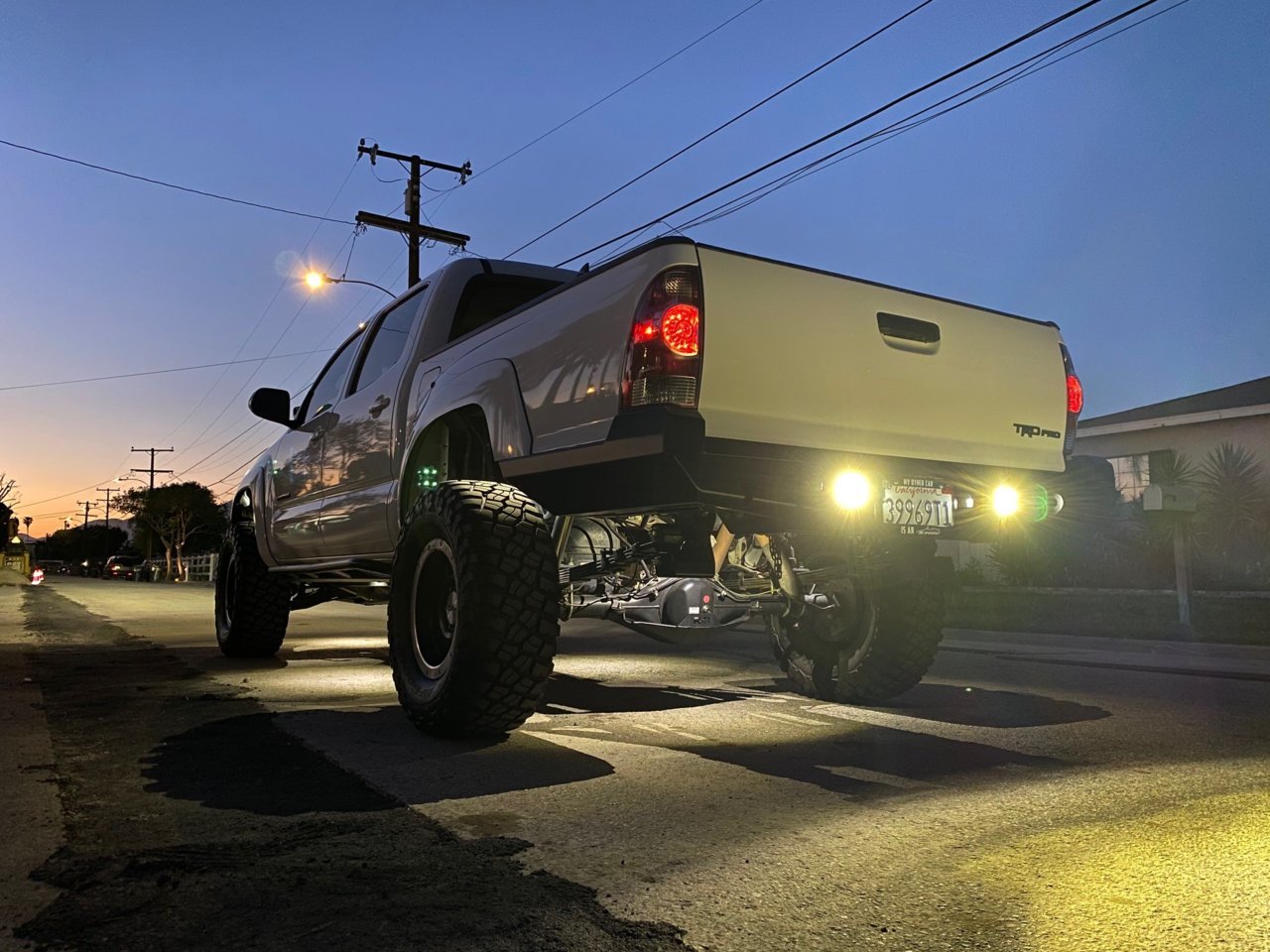

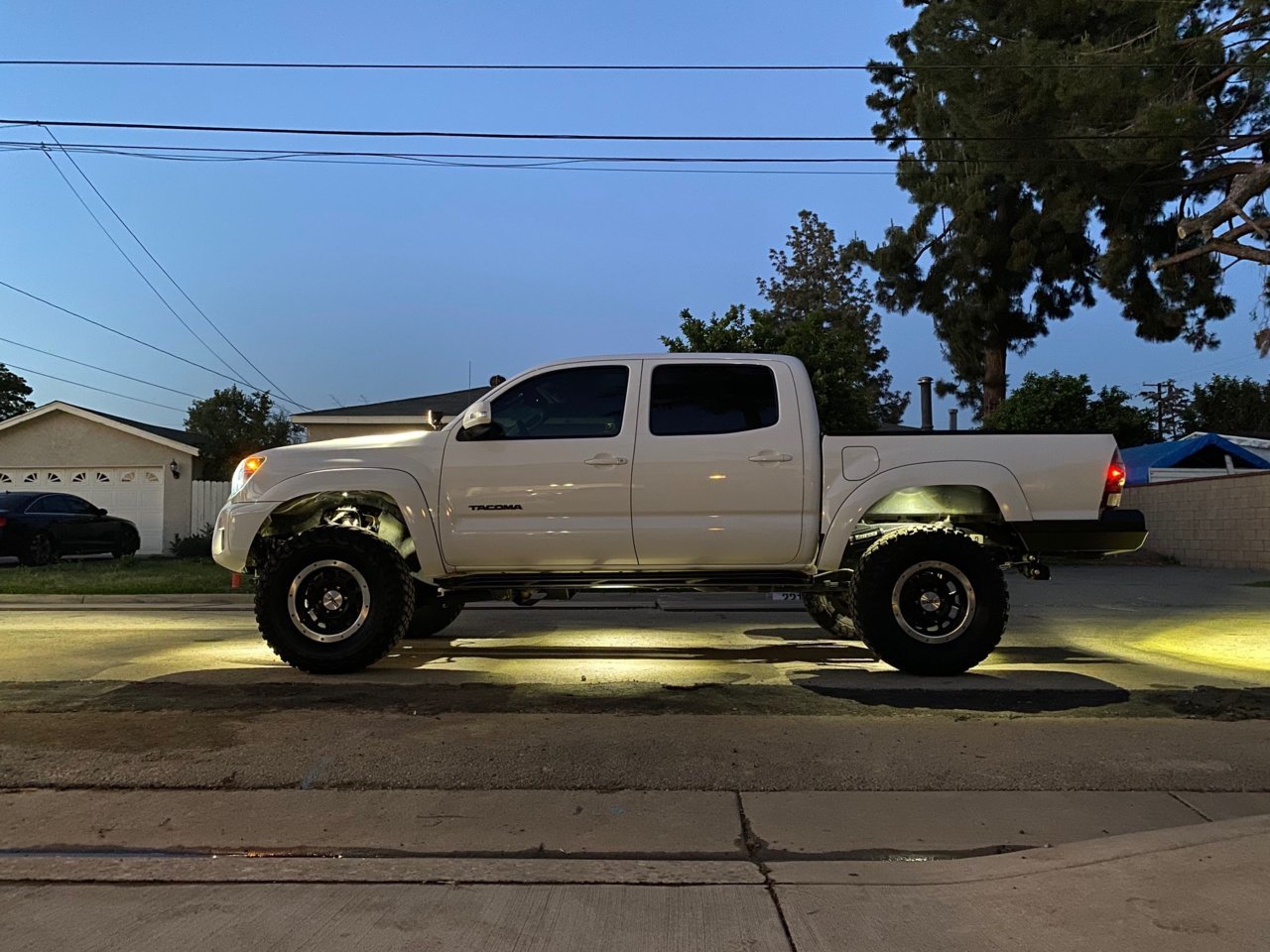

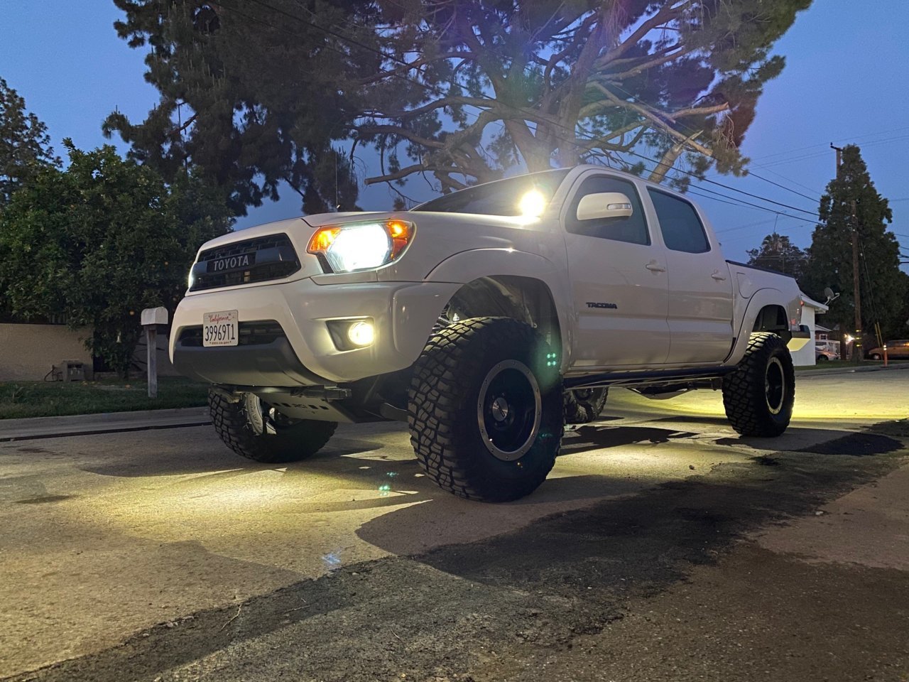

    Well they are all wired up and functional. Squadron pro's on the a-pillar, sae fog light kit, squadron pro rear flushmounts, 8 rock lights. I have two more rock lights I will be using as cargo lights, but I ran out of time to install them before my moab trip. Shoutout to @ShowstoppersUSA for getting me the lights and switch pro!
