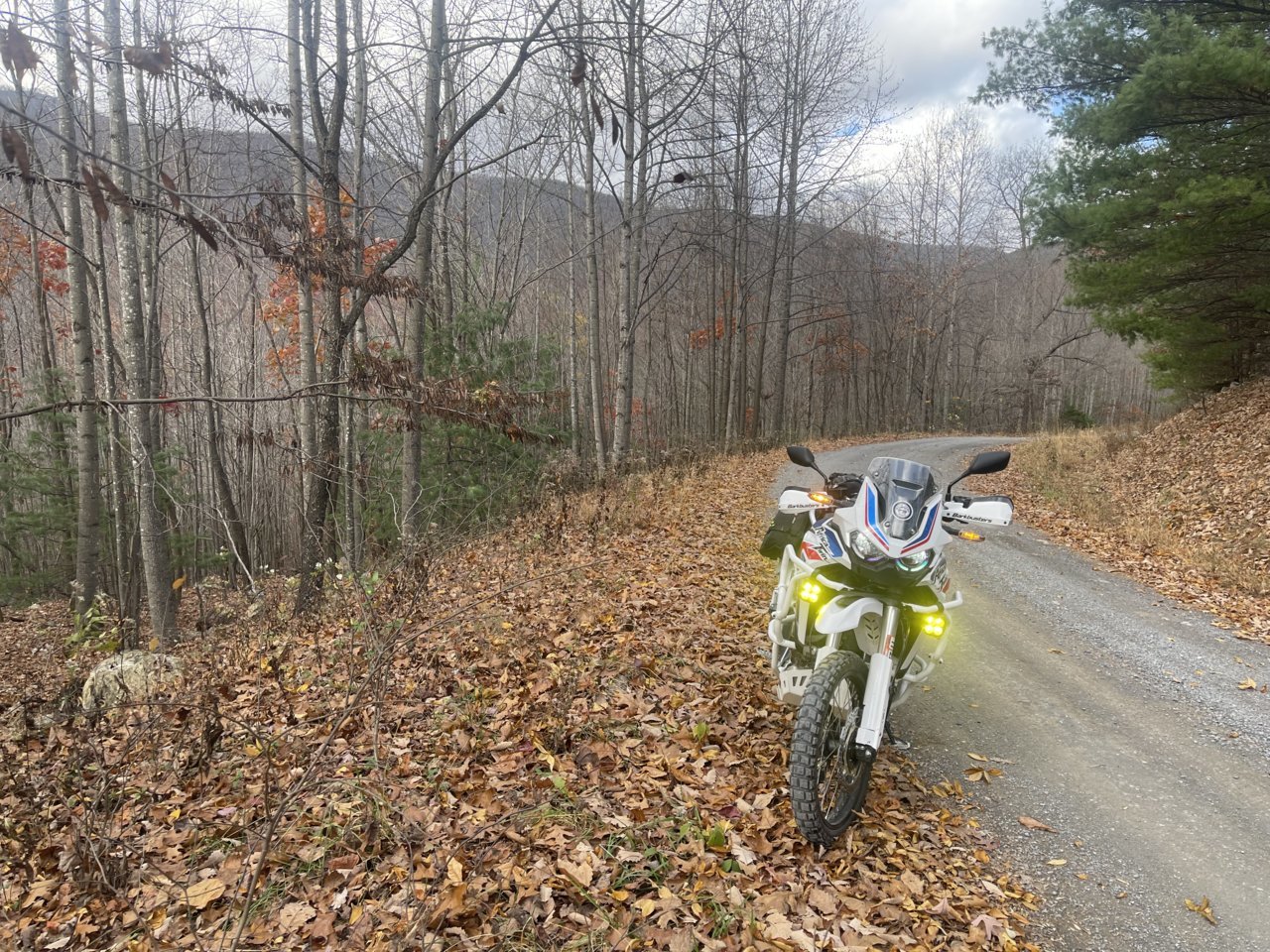

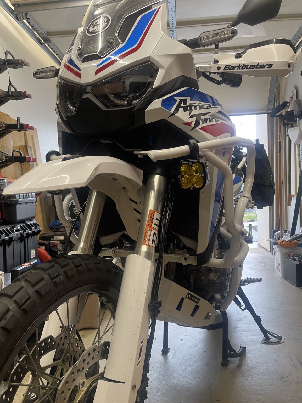

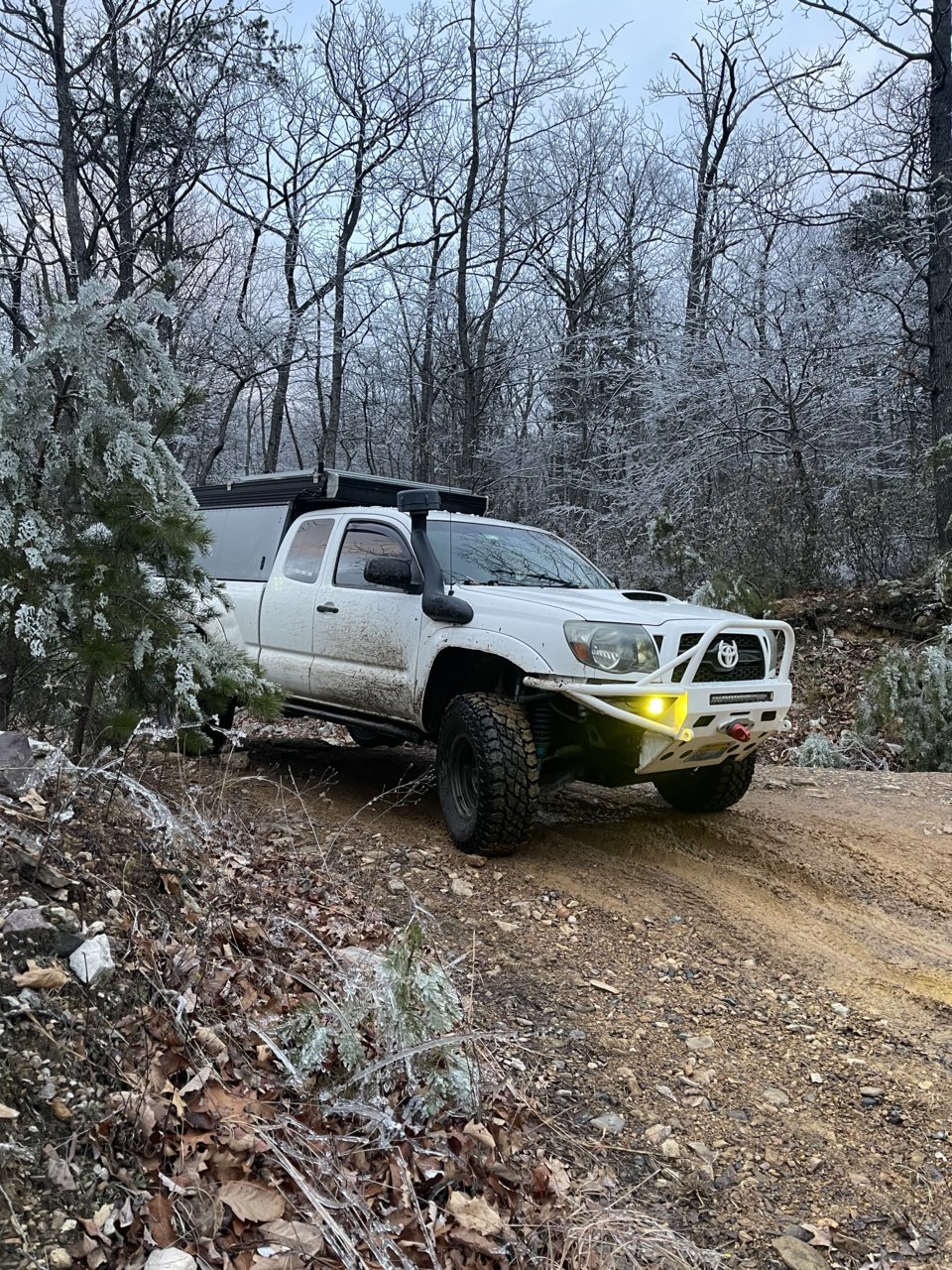

    Squadron Sports as fogs on my truck and bike :headbang:

    Looks great @fatfurious2. What lights on you running on the African Twin?

    He says Squadron Sports on both truck and bike.

    Gen 1 Squadron Sport
