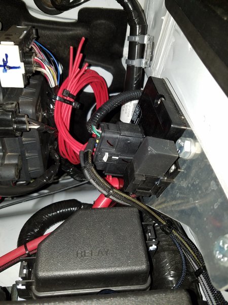

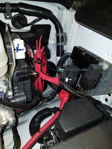

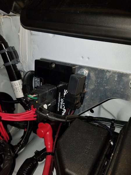

    So, what I did with my S8 to eliminate one switch from the equation was to wire the backlighting directly to my DTRL. That way, they are technically on a switch, however will be on whenever my DTRL's are on. As for the rest of my lighting, the Squadron fog lights are plugged into my factory wiring/switch and the S8, OnyX6 and Rear facing squadron all terminate at the Switchpros "brain" under the hood. I'll upload a picture of that in a sec. Anyhow, this turned out to be a super clean under-hood setup and doing the backlighting on my DTRL's left valuable output space open on my Switchpros for something more important.

    Wow - Looks great! Thanks for the photos and advice to you both.
