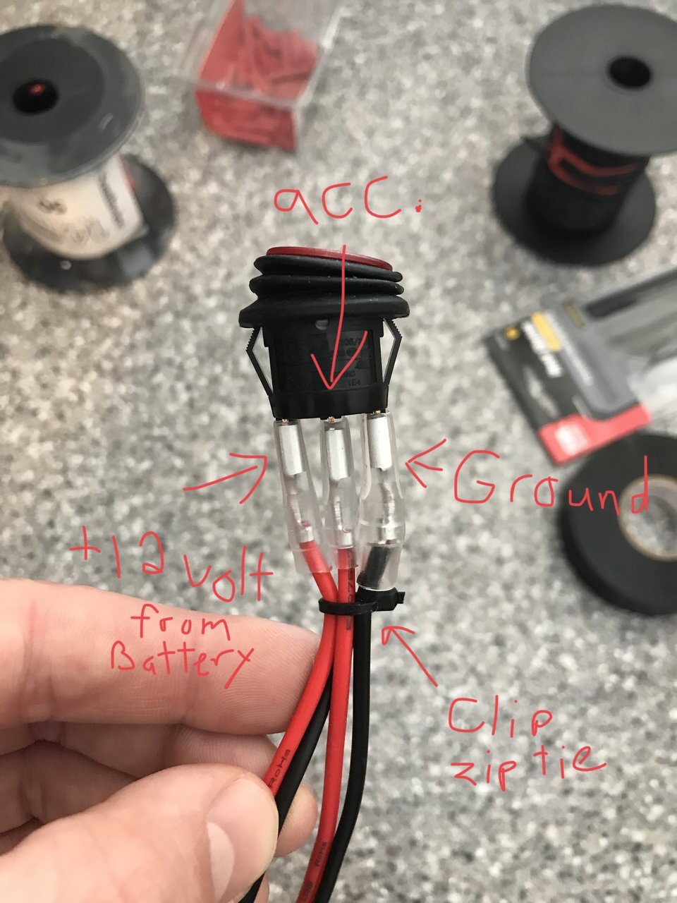

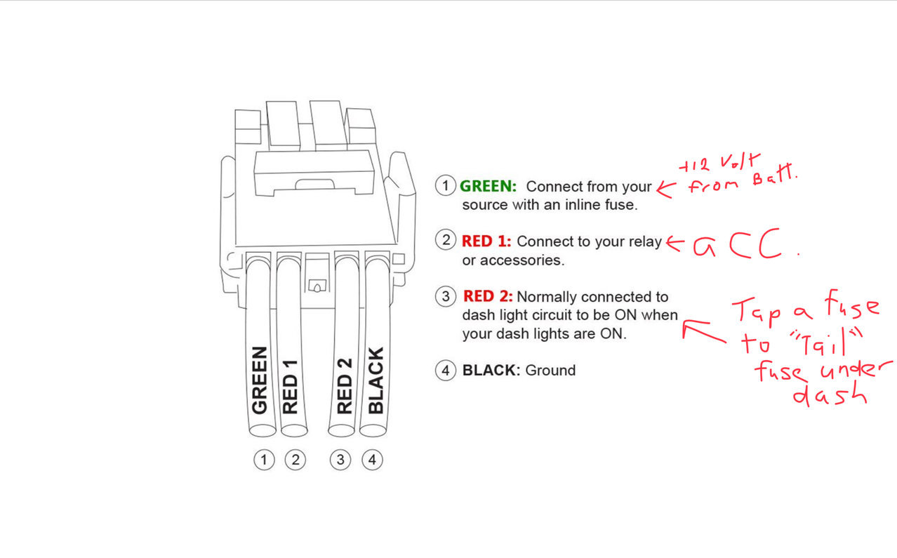

    So I left my computer that has Visio at work but I did a real quick “paint” mark up for you on my iPad. It’s a little rough but you should be able to follow it. Let me know if you need more detail.
    Basically you’re going clip the zip tie on the Baja switch and cut those connectors off so you can attach those wires to the new switch. 1267F91C-DC88-4190-BCE6-9EDD4D027974.jpgC3D2BF07-3586-430E-9837-04F40CE8BE04.jpg The fourth wire on the new switch is the switch illumination. So basically it’ll glow when you turn your lights on at night. You need to run a wire from that to the “tail” fuse in you fuse box near your left leg in the driver seat. You can use a “tap a fuse” so you don’t need to cut your truck wiring.
    Next you’ll need to run this plug to the Baja lights.C4AC5F33-8DF2-46A6-BCCF-C37E137CCCA8.jpgThen once all that is complete you hook up to the battery with this end.
    Let me know if that makes sense @KnckleChldrn

    Awesome. Thanks for that. I’m hoping to get to it this week. I’ll let you know how I make out. I appreciate you taking the time to do that.

    @Rome604 I too was searching for this info. Thanks. So does wiring it this way mean that it will always be drawing power from the battery? Also I might have missed it but what does the acc wire hook to? Thanks

    The lights can have the option of always being on. So if you forget to turn them off when you park the truck they will stay on. One way around that would be to use a relay but that will get a little more complicated. If you turn the lights off they should not be drawing power.
    The accessory is your Baja lights. So the other end of that acc. wire is the plug that clips in to the light.

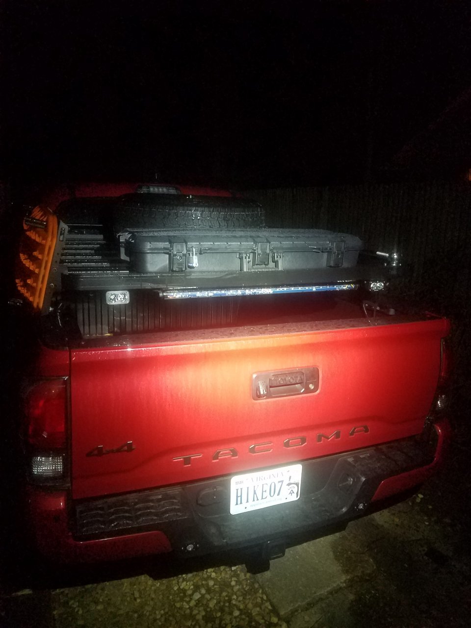

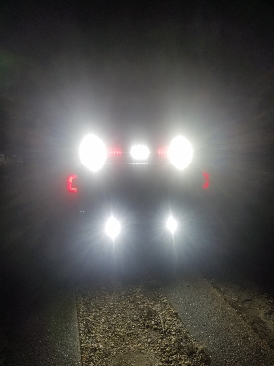

    You can do a lot of fun stuff with relays. I just finished wiring up some Baja S2 Pros with my RTL-S. I've got them running off a relay so that they come on with my reverse lights OR when I press a button.20180325_220648.jpg 20180325_220515.jpg They are stupid bright.

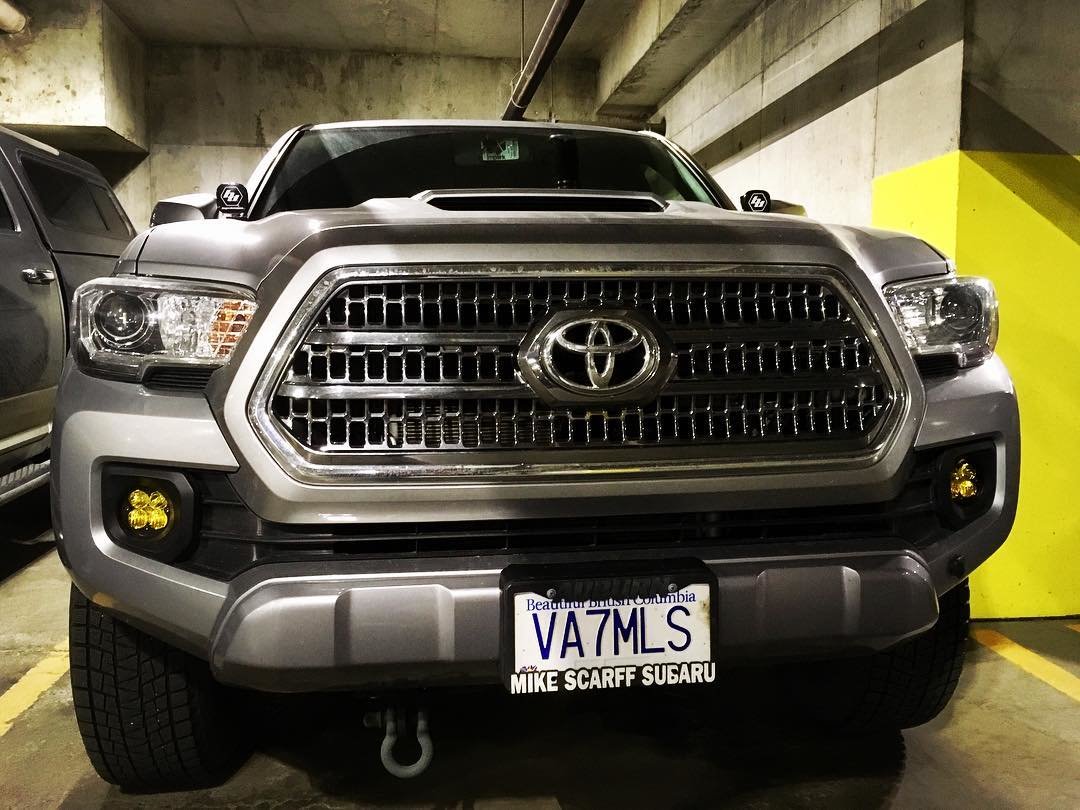

    Sports in the holes and Pros on cbi ditch brackets;
    30085699_166944920689320_813075759827517_0742e31a84e172871ee85fa25771219f279e8cb6.jpg
    Can't wait until it gets dark..

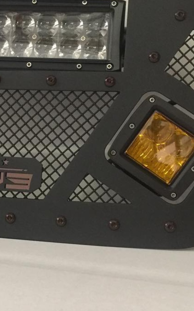

    Is the square bezel dimensionally the same as other brand square lights? Would like to replace my grille lights with some squadrons but the cut out in the grille is designed around the other brands.
    Photo of grille light pods
