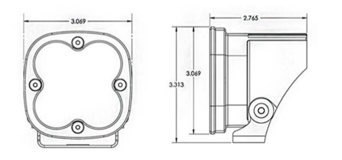

    The lights are still 3"x3" but ours have a rounded edge instead of a squared edge. Our Squadron Series will fit, but you might have gaps at the corners.

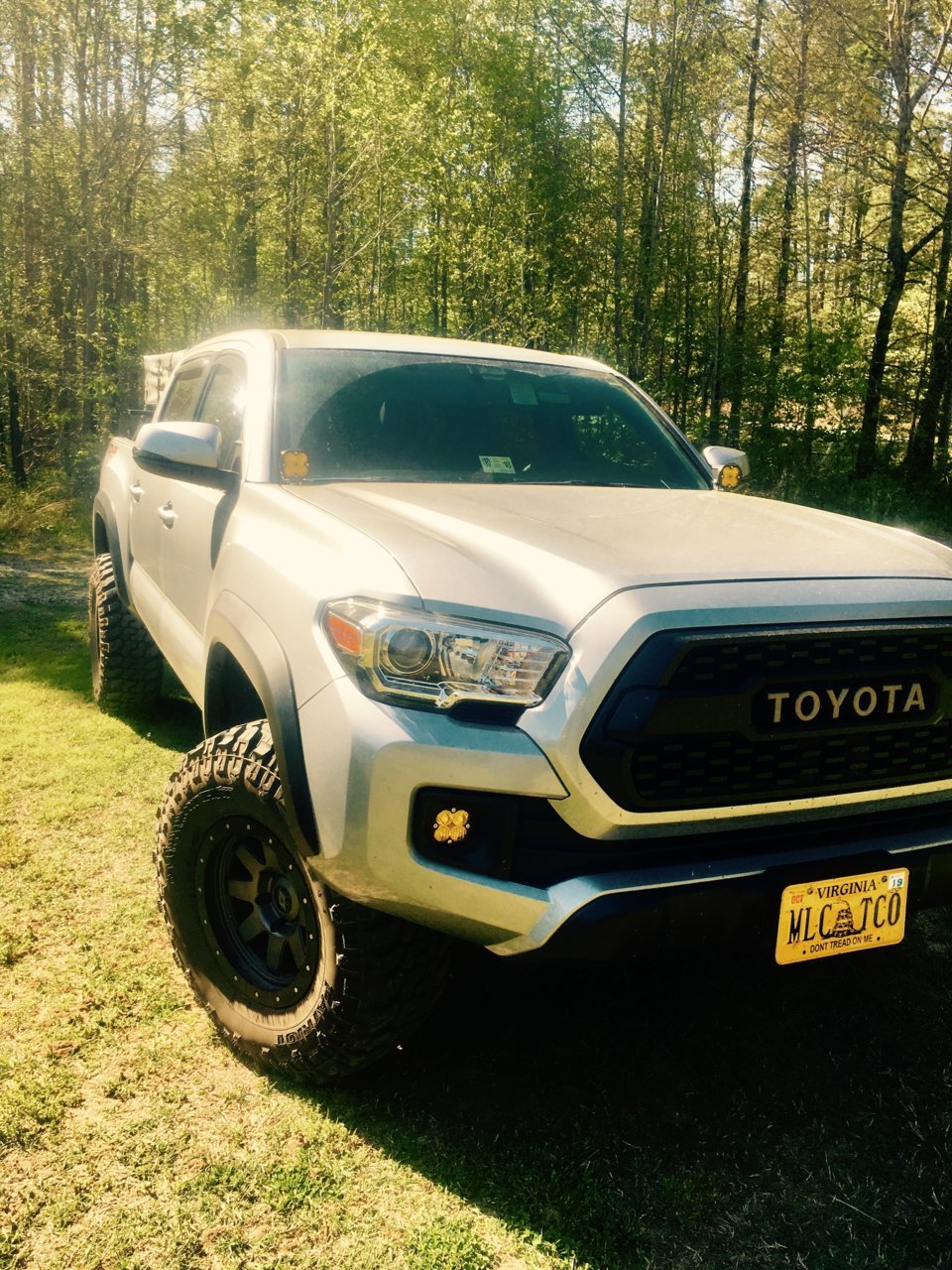

    IMG_2357.jpg Really liking these squadron sports I have the driving combo in both the fogs and as ditch lights. The fog kit and angled bezel made installation pretty simple. These things are super bright I can't even imagine what the pros are like
  15. May 1, 2018 at 12:39 PM
