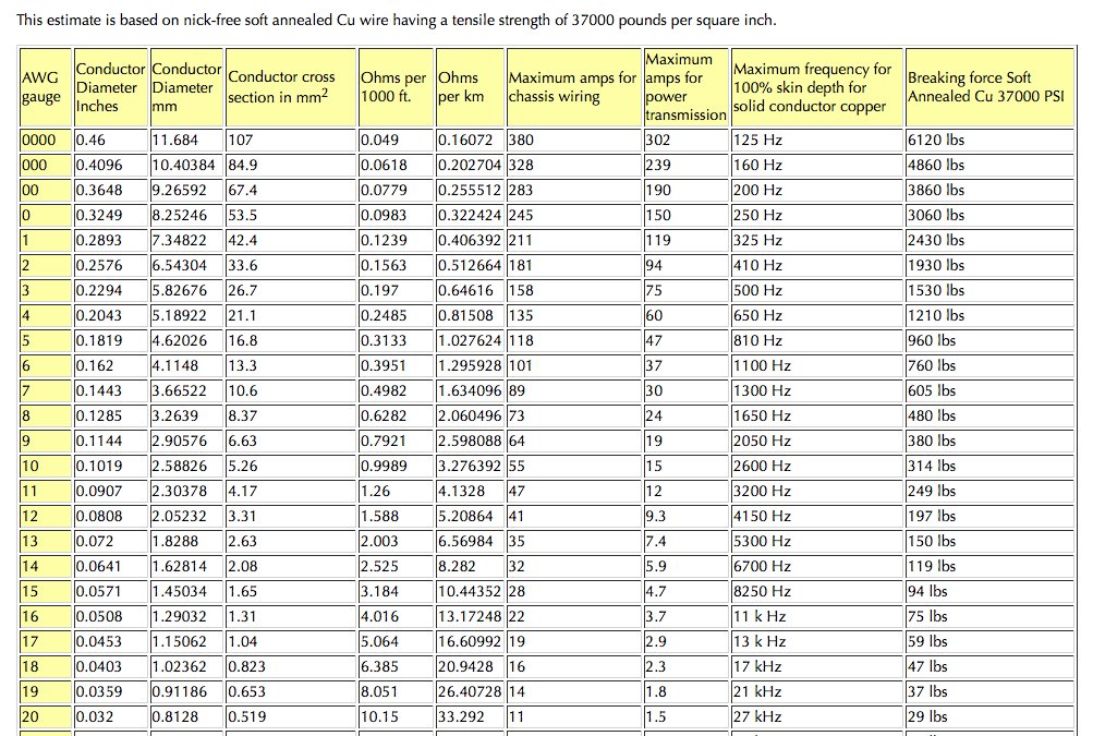

    4,897
    Maricopa AZ
    2021 T4R SR5
    Hey @Baja Designs , quick question(s).
    I'm working on integrating my new XL Sports into my wiring harness setup and I had been using 16-14 gauge Deutsch connectors on everything...
    The wire coming out of my XL's is much larger gauge though, I think it's 12ga? Point is, my little 16-14 crimp on DT terminals don't look like they would be a secure fit on this.
    So then,
    • Can you confirm that the XL's wiring is 12ga? As long as I can confirm the size I can just order a different style connector that does larger gauge.
    • Since the amp draw per light is 1.5/20W (same as my Squadrons) and I'm only going from the battery to the front of the truck, I can still stick to using my 16ga primary spool to make my harness, right?
    Thanks so much and super SUPER stoked to see these in action. :D
  19. Aug 12, 2018 at 3:11 PM
    #1499
    TACOVRD
    TACOVRD I Identify As A Prius
    Jul 11, 2015
    #159264
    6,439
    TW Addict
    AZ/WA
    2019 T4R ORP - Formerly 2013 DCSB OR Spruce Mica
    Workin' on it....
    According to this you should be good.
