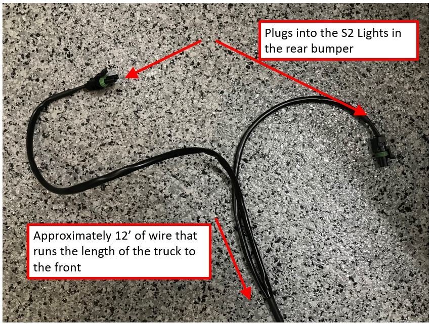

    I recently purchased the S2 Pro, Pair, LED Wide Cornering, Flush, Backup Kit (SKU#: 487807) for my new bumper and had a question about the wiring harness. The directions that come with it mentions like yellows wires and sorts which the harness I received do not have, which is no big deal, i can figure it out. But I have a 3 weather pack connectors on this harness. The 2 at the end of the harness plug into each light, but there is another one towards the front that is like 12" long that comes right off the relay. What is that one for? I have attached a couple of picks.
    Also, I was going to wire it to separate switch inside the cab, but was wondering if I could just wire it directly to my reverse lights via the trailer plug if I just tap into that harness? Would that be acceptable to do and not use any of that harness supplied with the lights?
    Thx in advance

    Good morning!
    The connector near the relay is another positive lead. You can use it for another accessory or leave unplugged.
    We wouldn't recommend tapping into the trailer wiring unless you use the relay. Instead of a switch you can use the reverse light wires as the trigger.

    Thanks for the info. I will run it to a separate switch. I will just cap off the 3rd plug
