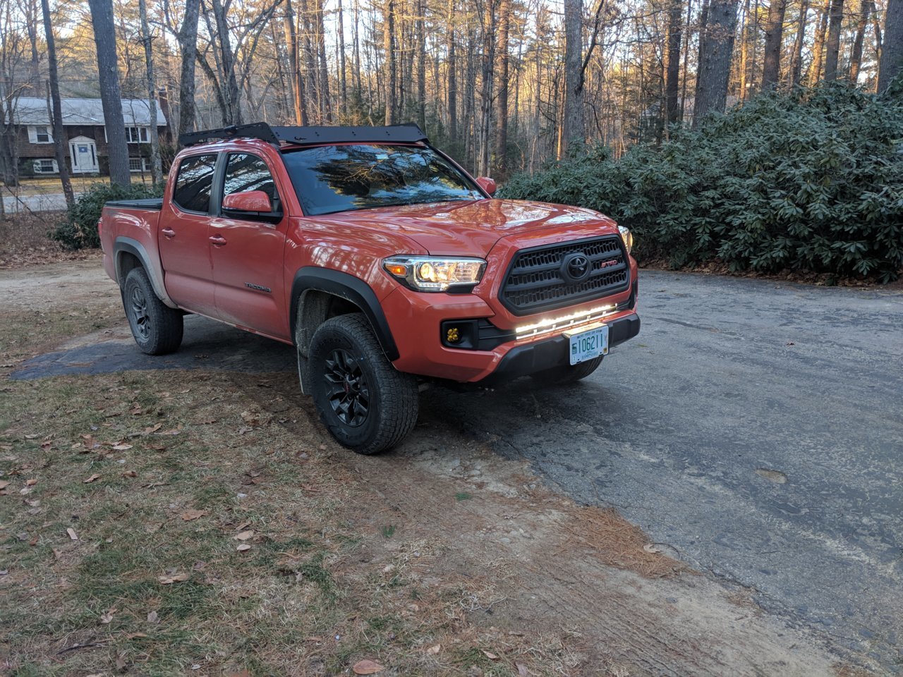

    For now its wired on a switch on the switch pro. If I ever need that 8th switch I'll probably tap into the ignition or the headlights for the back lights.

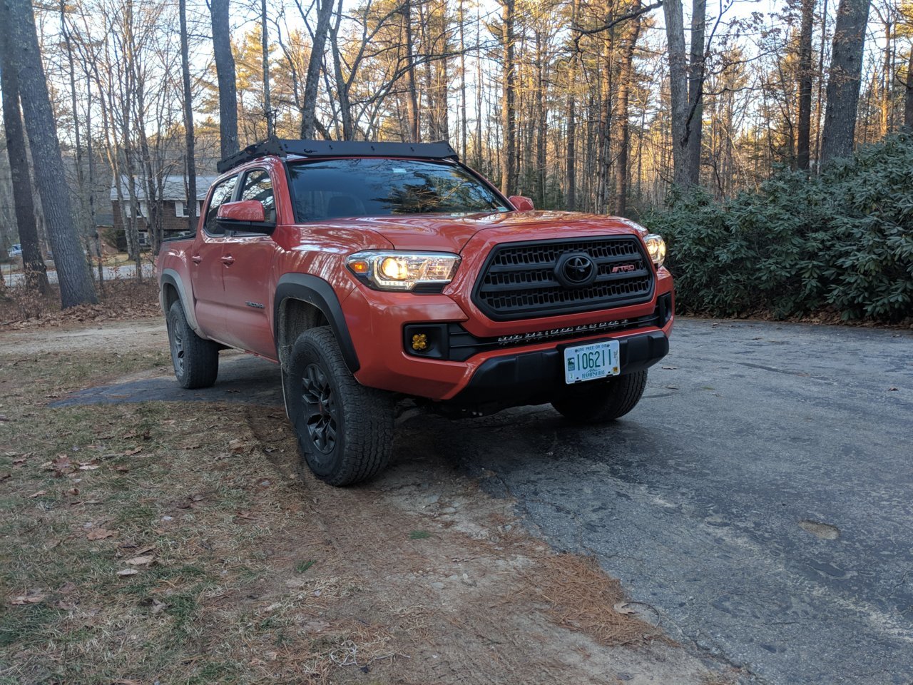

    Thanks so much for the tip! I guess I was just being a bit dense but I was mainly trying to push and pry at the edges only. Pressing with my thumbs on the center makes even the S2's covers come off way easier, although yeah the S2 is still probably the hardest to get popped off.
    I also tweaked the spacing and alignment of my lights... new challenge, how may Baja Designs logos can I have on my truck?? :D
