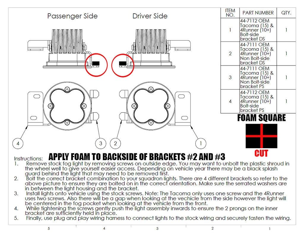

    Thanks for the video! The bezel seemed pretty self explanatory. I’m sure I can guess bracket orientation once I pull the factory fogs. Just wondering- do I tilt the lights on the brackets? How do the pigtails orientate? What’s this foam for? Etc. I think I’ll just muddle through.

    here is how the foam goes. I believe you do tilt them on the bracket to aim them. THe pigtails are generally not inserted into the end due to how different cars are wired. so you will want to carefully plug them into the light with out the end to make sure you get the correct polarity. once you have that then you can put them into the wire end.

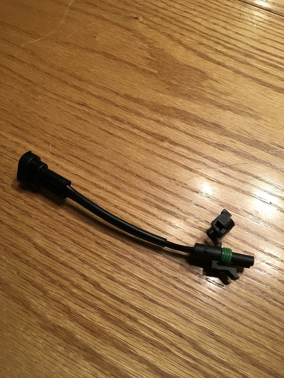

    Thanks again. One more. Once I’ve installed this backwards, is there any way to get it apart?

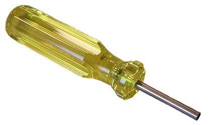

    without the proper too, its bitch. you need this.
    Delphi Packard Weatherpack tool

    cant see why I would need to use the foam pads on a Tacoma. can someone share pictures of the install.

    The foam is designed to reduce vibration found in some models. Here is a pic of it installed with bracket and foam:
