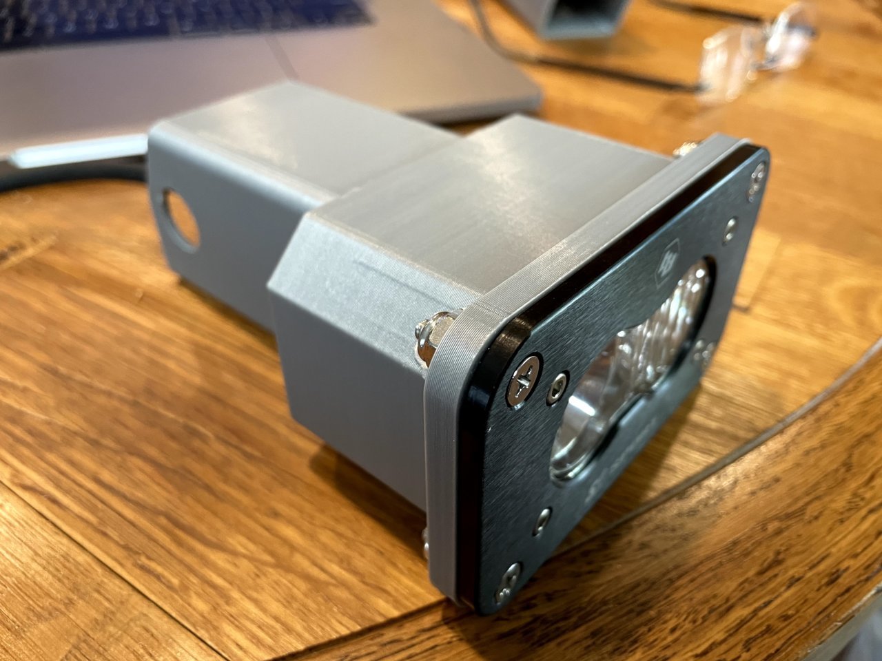

    I originally ordered an S2 sport to cut into the back bumper next to my plate. My tools however are not at my house, and I had a case of insomnia last night, so tip of the hat to meso, I designed this and printed up a test one. Pay no mind to the crappy hole I drilled, I have that integrated into the design now and will be reprinting this with better materials. What do you think though?

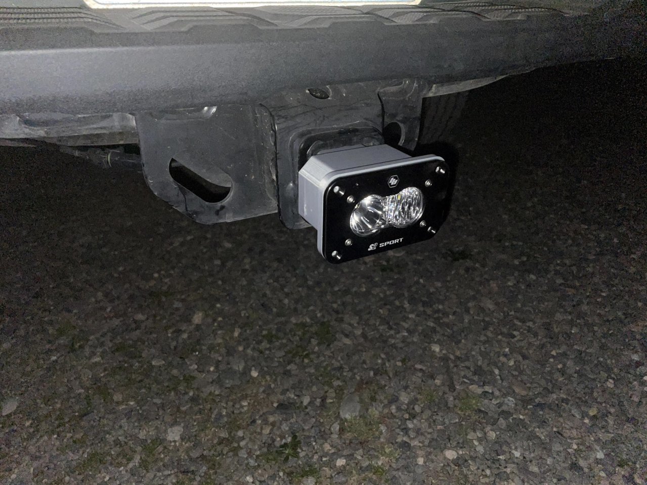

    Cant speak for the S1, but this S2 puts out a ton of light. Almost to much for the camera as the center of the image was really blown out hahaha.

    I stopped drilling it because I saw it going sidwards and didn't want it to blow out the print. The final one I am printing the hole right into it

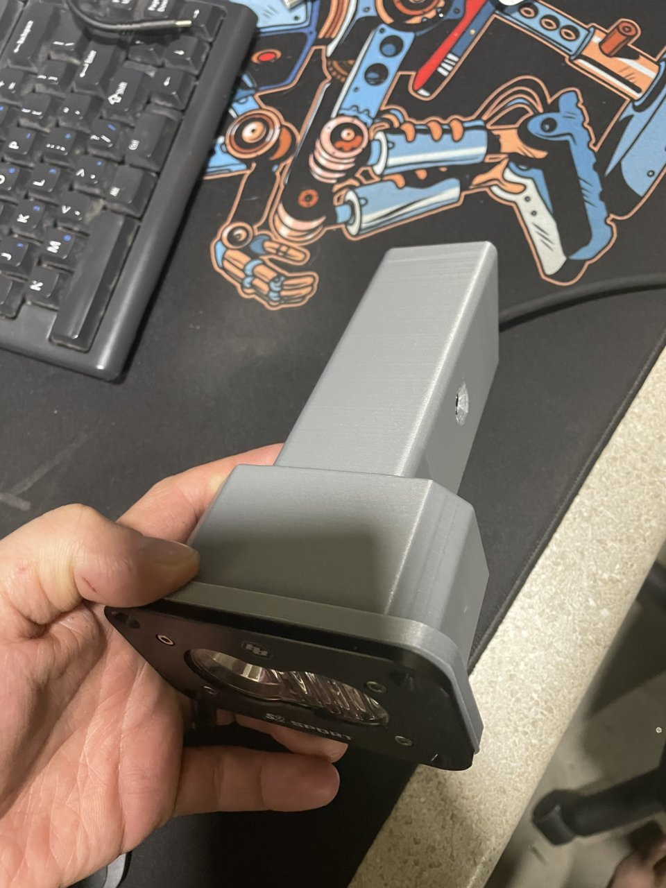

    Fired the rabid beaver and just printed the hole myself. Also shortened it up a bit. Pretty happy with how it turned out. The final one I plan on doing with nylon/carbon. Another change I made which isn't pictured here is I radiused the inside behind the light to remove the need to print with supports as well as add more rigidity at the transition in the rear. Everything fits really well. I think the final one I will do thread inserts as well instead of screws and nuts. Heading out on a trip for the next few days so we will see how the PLA holds up in the short term :p

    Looks good. Id think your current setup with nyloc nuts would be better in the long run, as opposed to threads directly in the material. But maybe not

    Hey @malichite what 3D printer are you using, that print is flawless.

    Ender3 V2. Only mod so far is the bl touch level. I have a micro swiss direct drive and hot end showing up today though.
