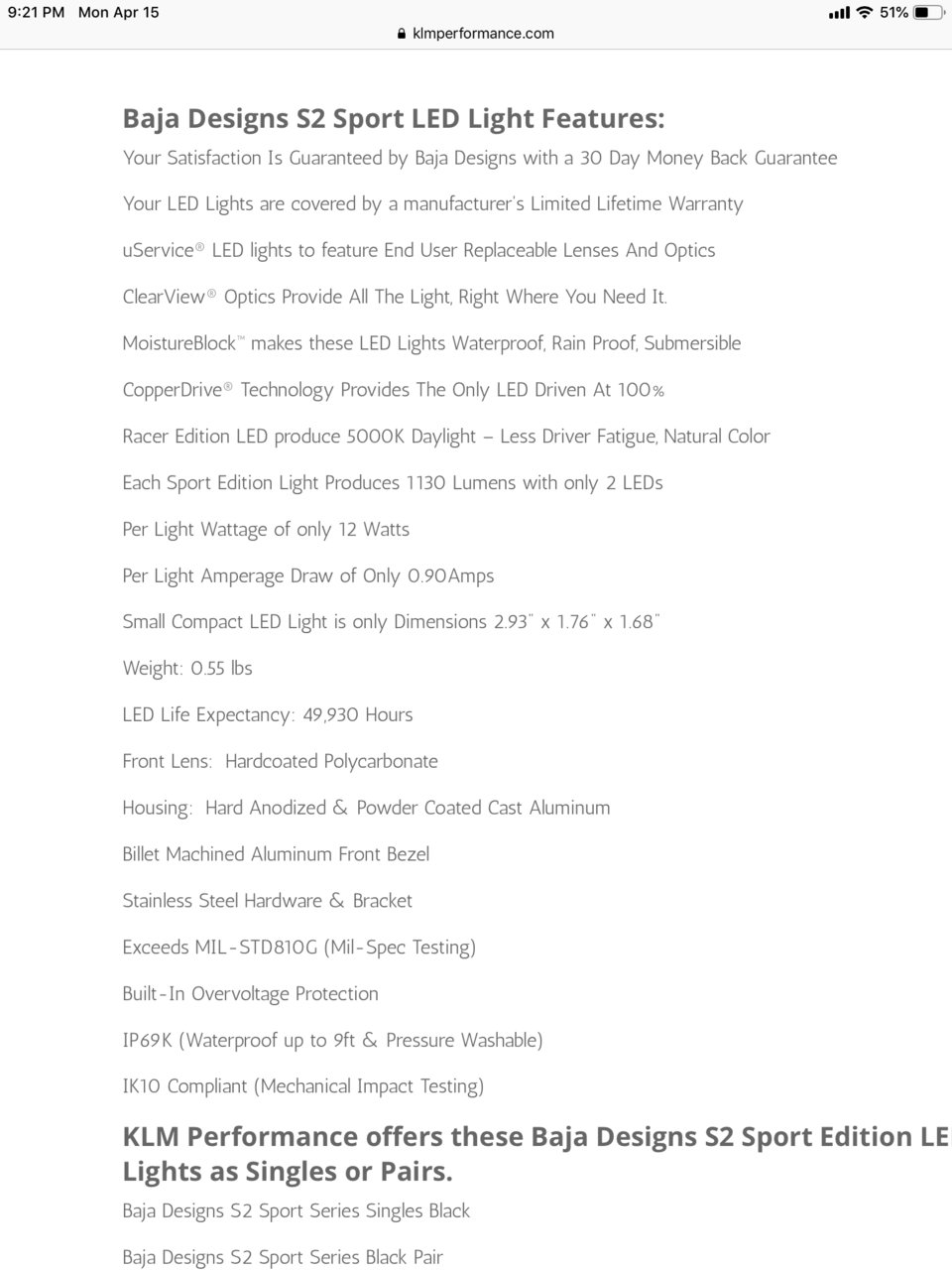

    Hi everyone I’m still a newbie at all this but a friend sold me some Baja s2 sport and I’m gonna mount them and as new as i am and from the reading I did seem like they’re low voltage lights but my questions is so I need a relay for these? Thanks everyone

    Technically you do not need relays for the S2 sports as they only draw 1 amp each. A switch with a 3A rating or higher will safely survive turning two S2 Sports on and off. Sometimes relays are a good idea for control as you can use different switch options, but not required.
