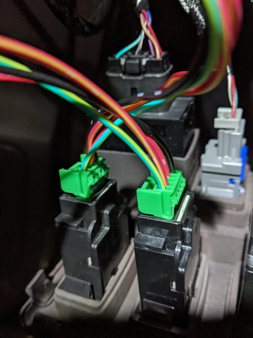

    Here's the switch wiring (I'm using the switch on the right):

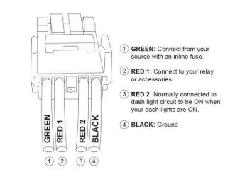

    Baja designs says they should be wired up like so (https://www.tacomaworld.com/threads...ess-to-oem-style-switch.611625/#post-23260821):
    • Black -> black
    • White (I don't have white, I have yellow) -> red 1 (the red wire next to the green wire)
    • Red -> green

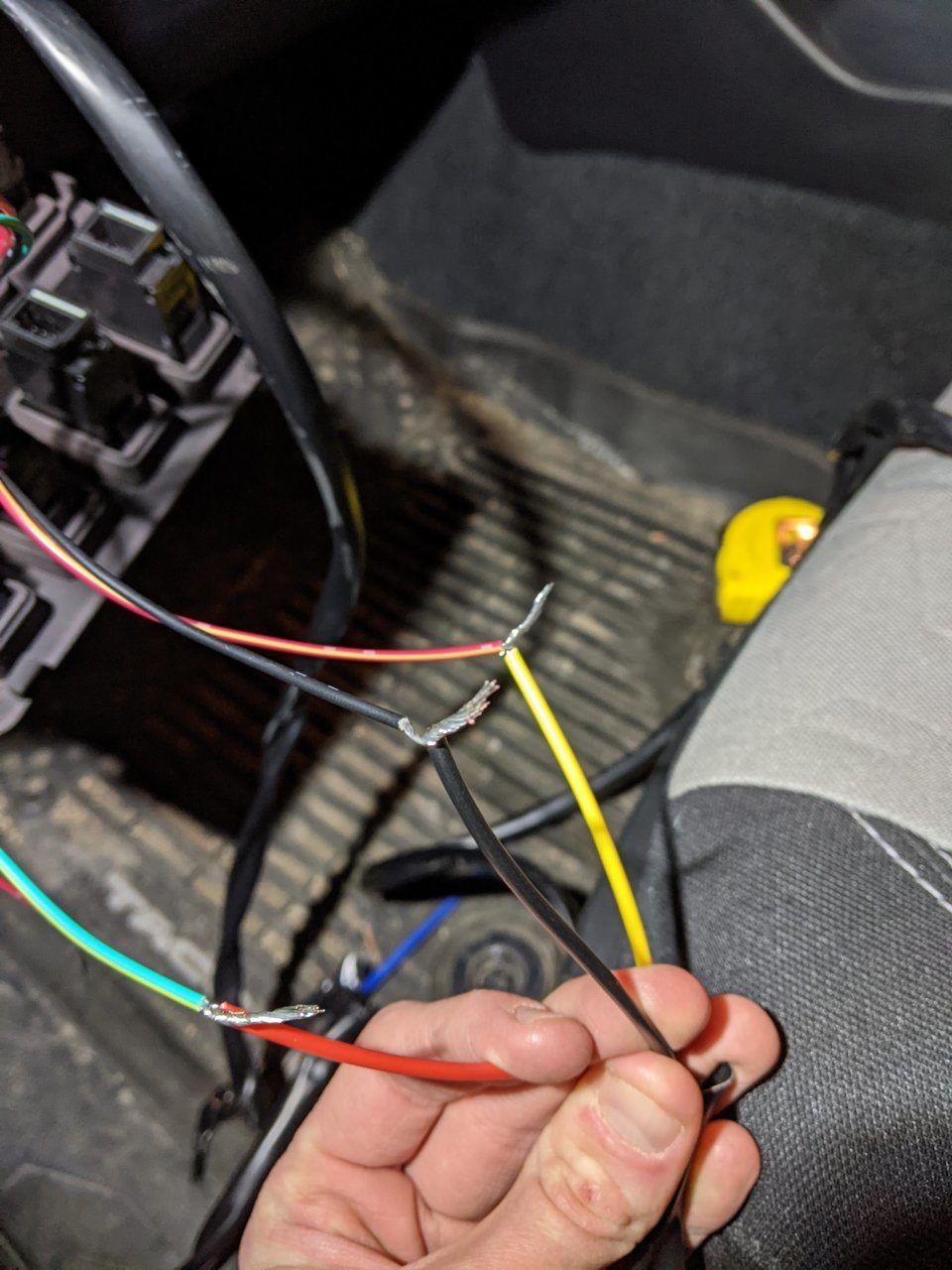

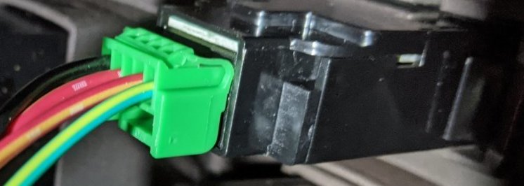

    Here's it wired up:
    I also verified that the switch should work - by connecting red1 and red2 to the red wire, the switch was successfully lighting up.
    I tried basically every combination of wiring (except black -> red since that caused a few sparks when I accidentally touched them together) and none have seemed to work.

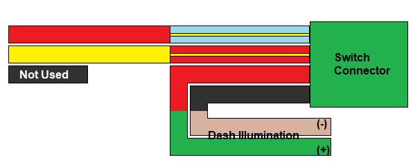

    Could you post some context with this? I understand the left column but the blue and yellow don't exist on the switch, unless that's supposed to represent green and yellow. Also it's hard to tell what the yellow and red represents, red1 or red2.

    Oh does it? The diagram posted by caribe makaira made it look like it should be
    • red (harness) -> green and yellow (switch)
    • yellow (harness) -> red and yellow (switch) (red1)
    • black (harness) unused
    Which is how I have it wired however I have black -> black which it looks like the diagram says is not used?
    I wonder if maybe the two red wires are working since the backlighting and active lighting on it seemed to work, but maybe the black and green aren't? I've got another switch wiring harness that I can try out as well before I go buy a multimeter, so hopefully that gives some answers.

    Hood Struts, My version Fogs always ON, Map & Overhead Light Mod,
    It should be.
    By using the black from the relay (harness) the circuit is always available. (battery drain if left on)
    If the switch is NOT depressed and you still have an illuminated switch, the feeds to the switch from the harness are inverted.
