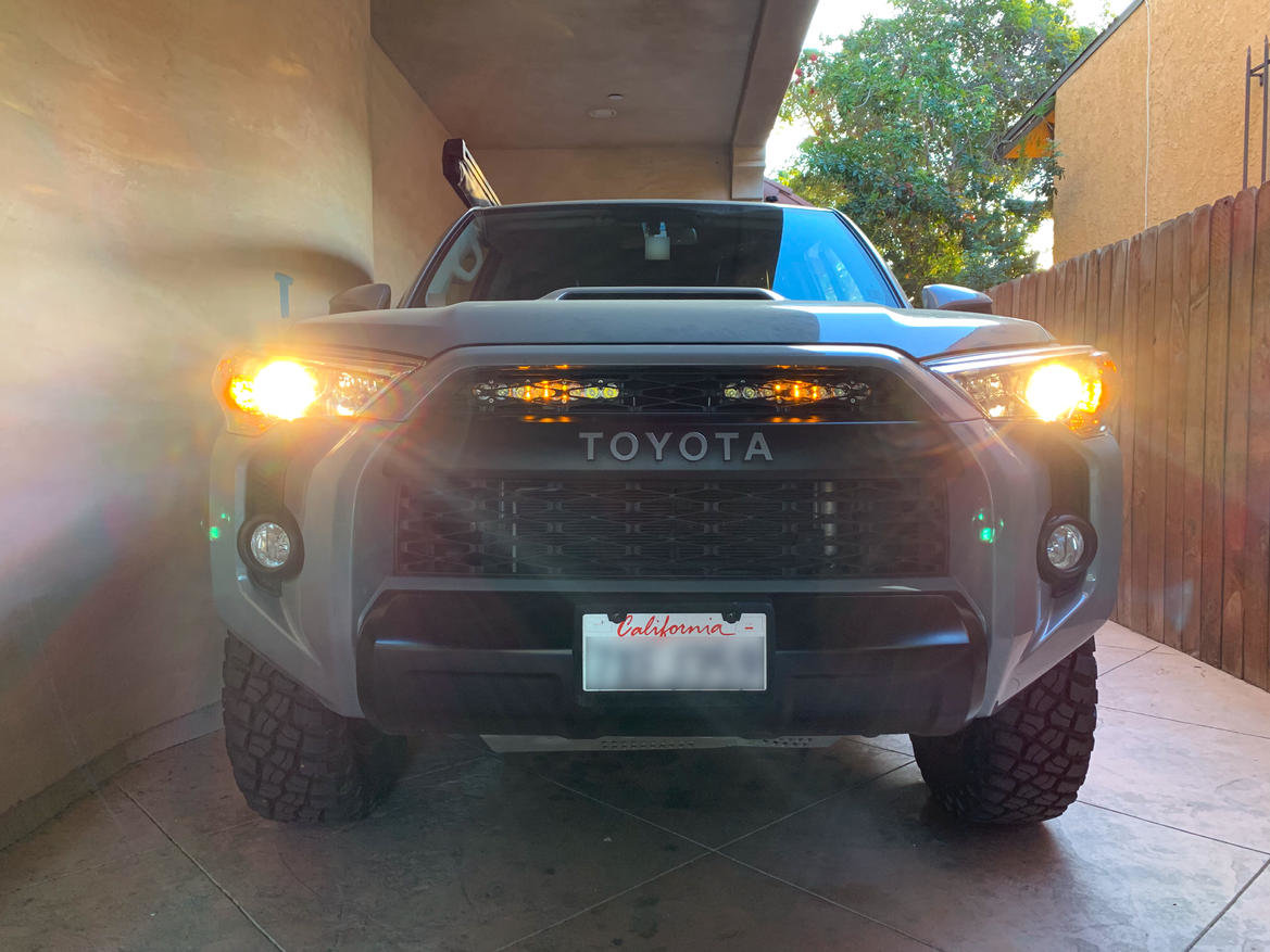

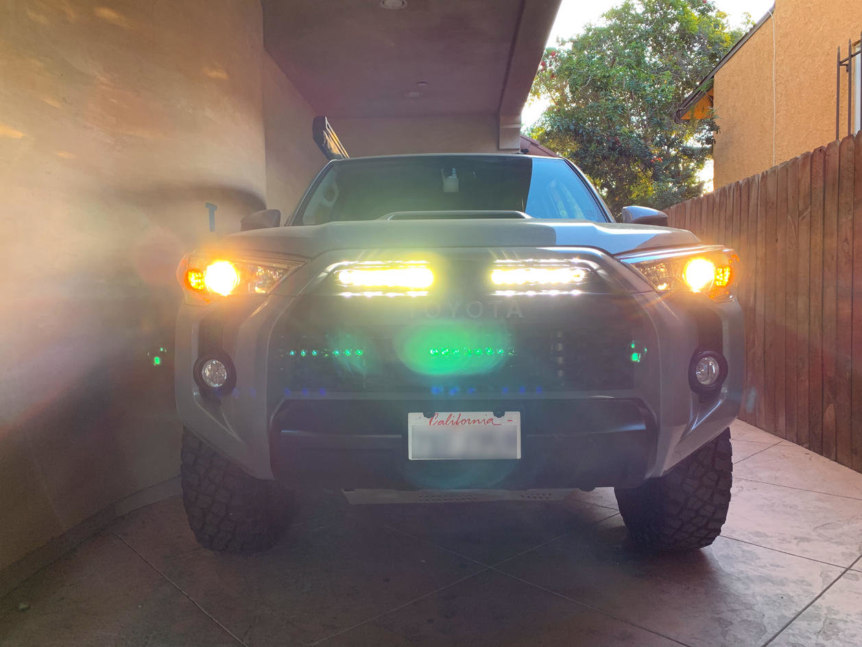

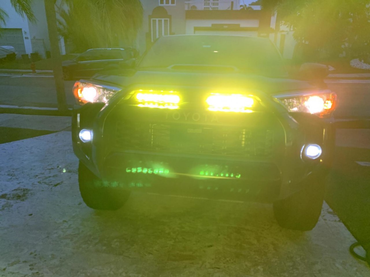

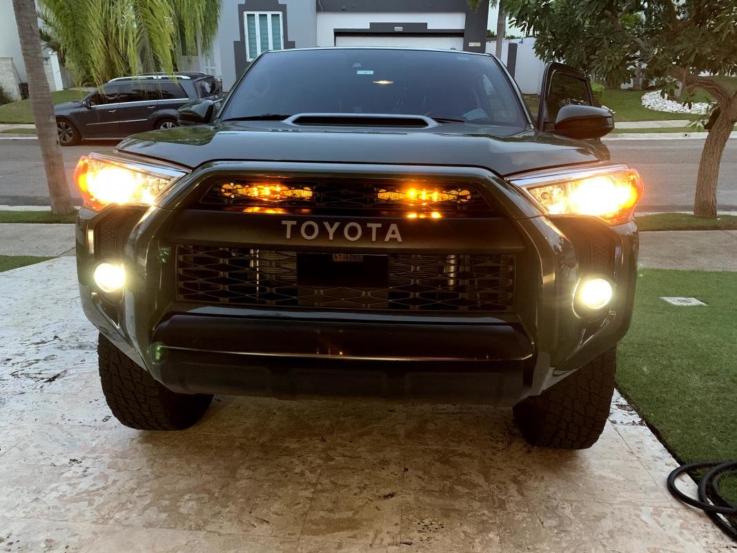

    I bought a dual s8 kit but decided that it didn't want to tear the front off the truck to install it. I can tell you the backlights are not that bright. Also looked to see if anything in BDs information says 1 way or another. If you have the green (backlight) wire attached to say your parking or DRLs it will be on whenever they are. If you have it wired to a switch you control it. I will say if you look at these Toyota pictures I found for you I'd think you'll agree that whether they stay on or not you aren't going to see them.

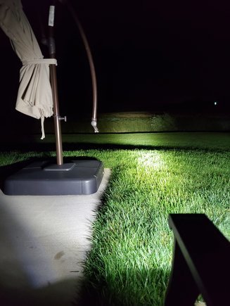

    If you already have them this doesn't matter but if you're thinking about buying them it might. This is only one of the 10" S8s hooked up but wasn't really impressed with the output.
    20210813_044823_026d55e4068ee56bd6119e0b9d79147705adad14.jpg 20210813_045035_5b6f47fabe7a48f47c92b63a4355c533b9d3101b.jpg
