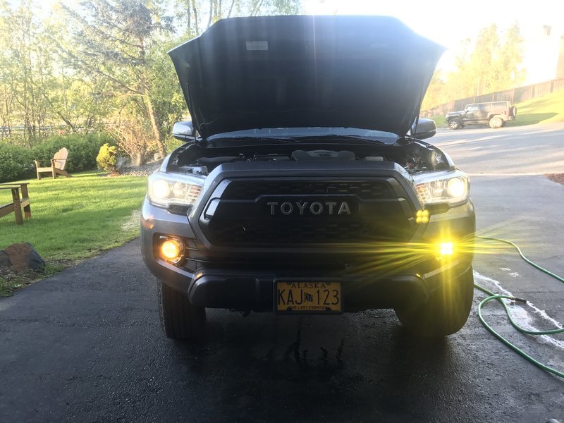

    When I first installed then, I aimed them plumb which resulted in glare being thrown far out and above my low beam HID's. These need to be angled down to avoid pissing people off. Insanely bright tho.

    Mine are level now. I really don't think aim them down any will take away the glare.

    Down about 5 degrees cut the glare enough to be less than the drl's above the headlamp cutoff, while still providing useful light throw for use as fog lamps.

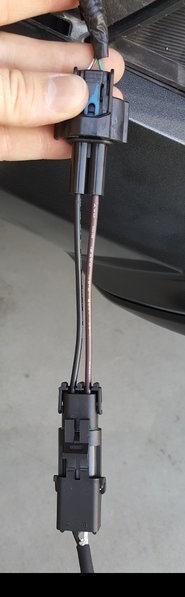

    In my case my plug and play harness was black and brown, the black wire ran from truck white to the black on the light, very straight forward.

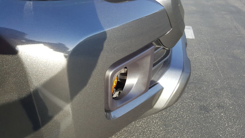

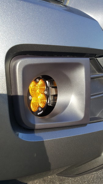

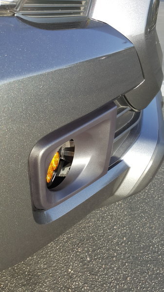

    I got mine installed yesterday. Thanks OP for the tip using the zip tie. I used a screw and bolt instead to secure it, without doing that it was pretty wobbly. I also got the brown and black wire harness. You can see from the picture how I wired it up. But that gap :eek: had I known it looked like that from the side I might not have gotten them. They do look nice from the front though. 20170614_163428.jpg 20170615_095255.jpg 20170614_183349.jpg 20170614_183451.jpg 20170614_183446.jpg

    :puke:really wish they'd address this asap!

    We have developed a prototype fix. This is still a few months out. Most likely 1-3 months. I will update everyone as more info becomes available. At this time I'm not sure how much the price will increase. Also we haven't determined an upgrade price for existing customers. It would most likely be in the same range as our lens kits, rock guards, and other accessories. Updates will be posted in the following threads:

    We are not aware of any differences between the US 3rd Gen and the Canadian 3rd Gen. This fix would be for all vehicles our (447110) kit works on.
    12-15 Tacoma
    16-17 Tacoma
    10-17 4Runner
    14-17 Tundra
    This would be a replacement bezel that bolts onto the front of the light and replaces the Round Squadron-R bezel.
