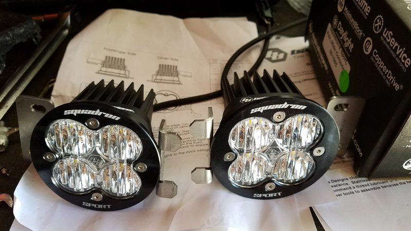

    There are a couple YouTube videos that show how to do it. It’s really the same process as the other squadrons.
    Basically, the bracket with the double tabs goes to the inside of the truck and slides into the slots from the factory. The single tab with the holes goes on the outside of the light and the factory screw goes through it to mount. Hope that makes sense.

    If you have the kit then just follow this video. Pretty easy and I skipped the splash guard part and just went through the front and it was fine. Good luck

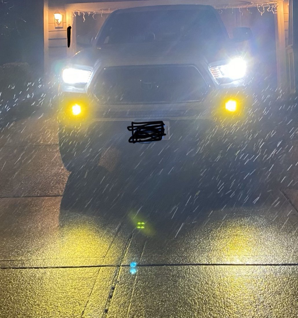

    Anyone know if you can adjust the angle left to right on the fogs? It looks like mine are pointing out instead of towards the center or strait ahead.

    There is no right to left adjustment that I know of. Do you possibly have the brackets on backwards or something like that?

    I don’t think so...could just be me. Looking at this picture the fogs do seem to hit where is expect them too. When I was driving it just seemed they were aimed wrong.
    Guess if there is no left to right adjust they must be pretty close.

    Yes these do have a lot of light that shines to the sides.

    Inside of the mount goes into the slots, so the only way to 'aim' them side to side would be to adjust either the foam on the inside tabs (front or back of the tab) or using washers on the outside screw holes;
    There is a little up and down adjustment from the side of the squadron mount.
    I have Combos and put them in per instructions - they are pretty much dead on straight ahead..

    The foam that cam with mine didn’t even stick(if were talking about the same thing). I’m thinking like you said, with the brackets in place, they should be good. Just up and down adjustments.
