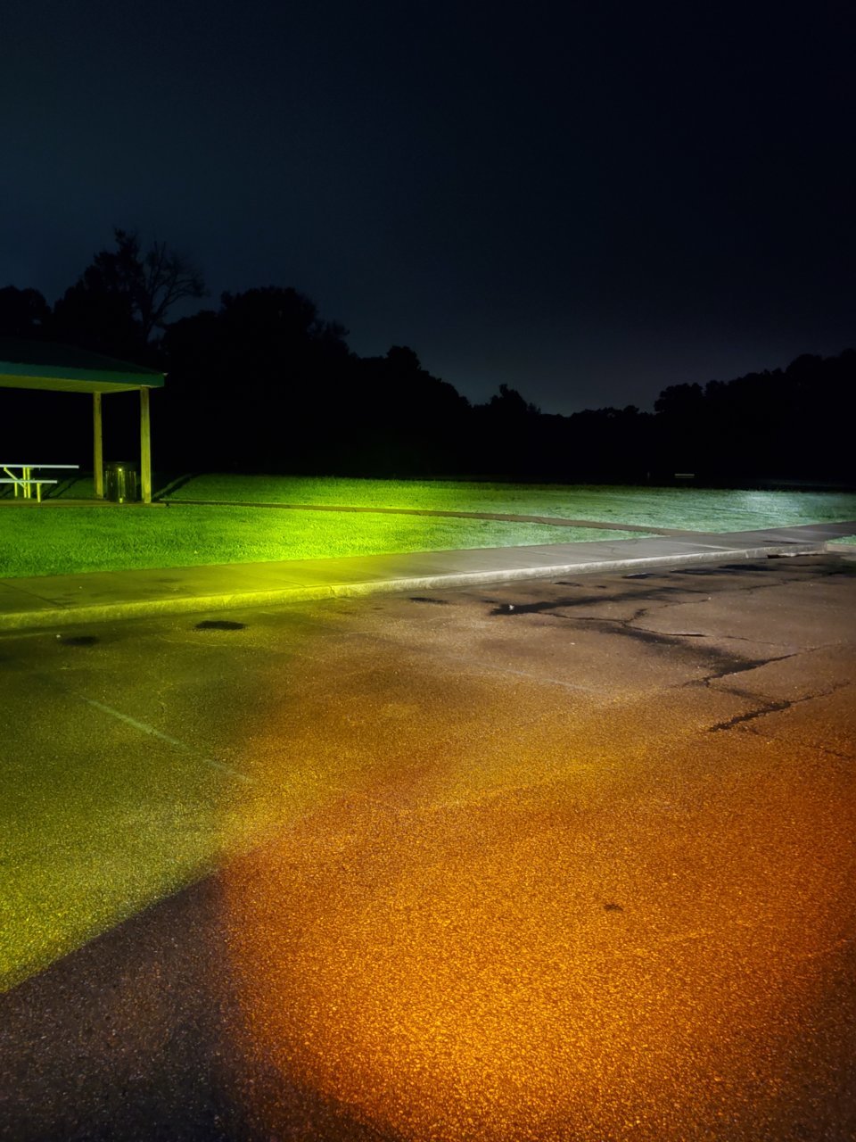

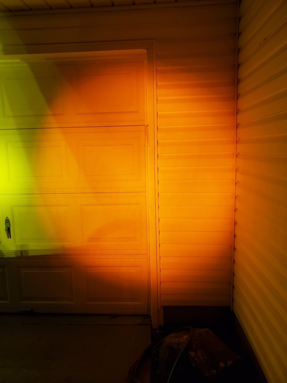

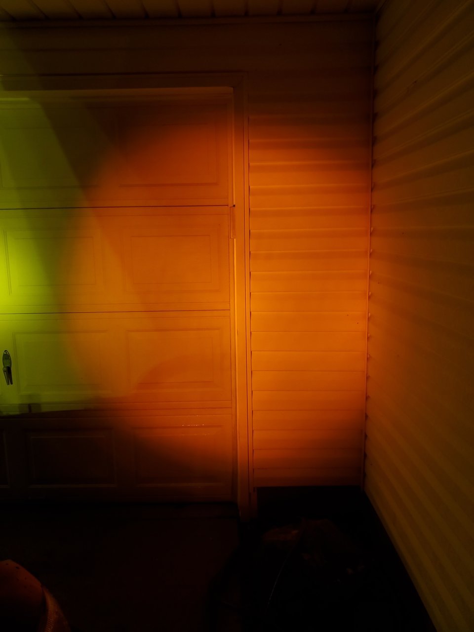

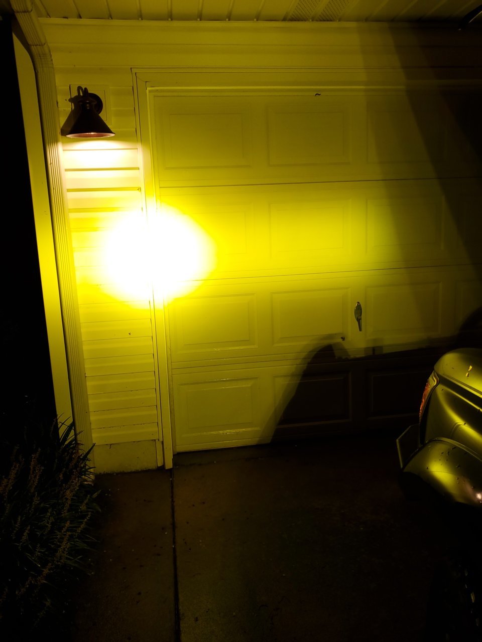

    I didn't find much on this when I was searching for new lights for my 3rd gen 4Runner, so I figured I'd post up some pictures for anyone else who has this question.
    I recently replaced a set of Rigid Dually Amber flood lights with a set of Baja Designs Squadron Sport Amber driving/combo pattern lights.
    I never cared too much for the color of the Rigids, and the new Baja Designs are much closer to what I wanted.
    The color is personal preference mostly, so I wanted to put up a couple comparison pics. The Rigids are the much oranger of the two lights in all the pictures.20210822_001013.jpg 20210822_001019.jpg

    Lots of info on this in the lighting threads. Rigid is appropriately named 'amber' because they produce amber light. Baja doesn't label their lights correctly and calls yellow 'amber', leading to a lot of confusion about what color the lights are. Rigid also sells yellow lights if you prefer a yellow color, and they are appropriately called selective yellow. Amber is not a very good color light for automotive use in illuminating the roadway or trail, selective yellow is a much better color, which both brands sell.

    Interesting. In my searches I wasn't getting any hits for the color difference between the Rigid and Baja Design "Amber" lenses. Maybe because I wasn't using the word yellow in my searches.
    It's worth pointing out that it looks like Rigid only sells the selective yellow in an SAE pattern, rather than their regular Dually like what I had. I don't see where you can get just any of their lights in selective yellow like you can the Baja Designs.
